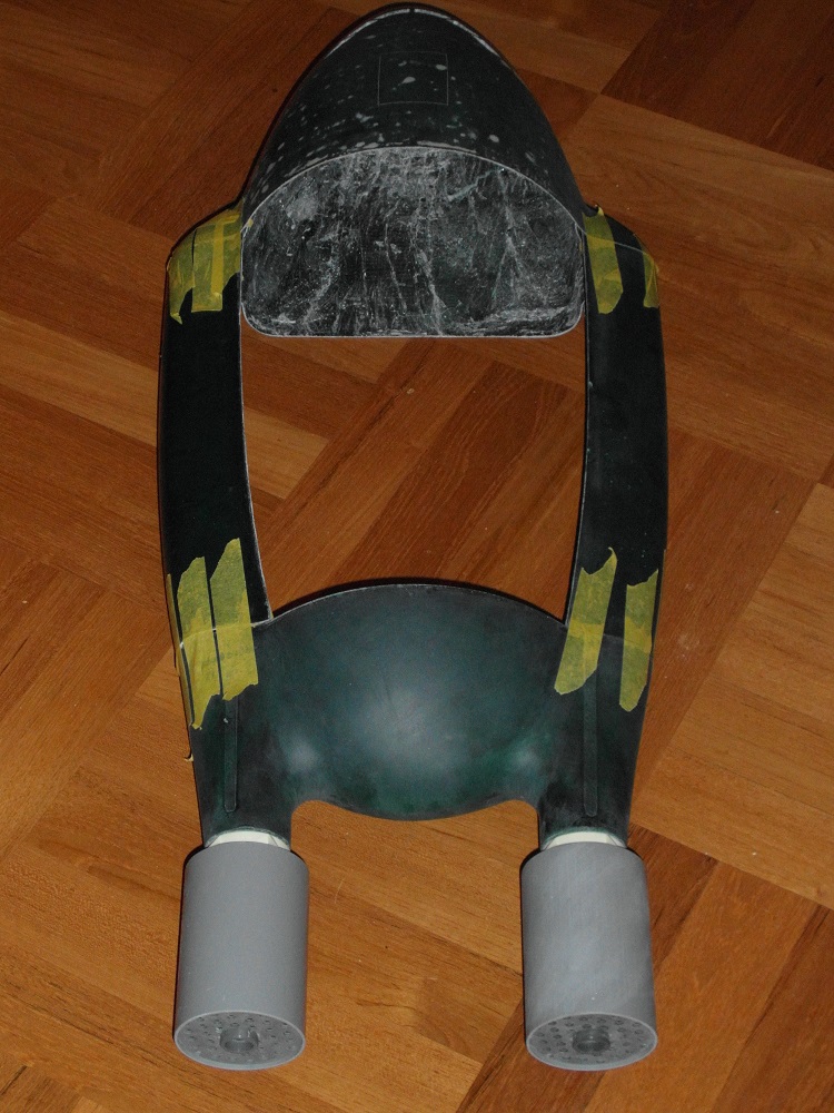

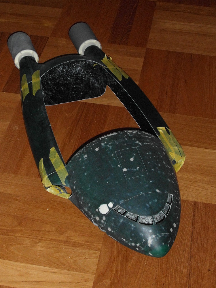

Thunderbird 2 scratchbuild 40 inch

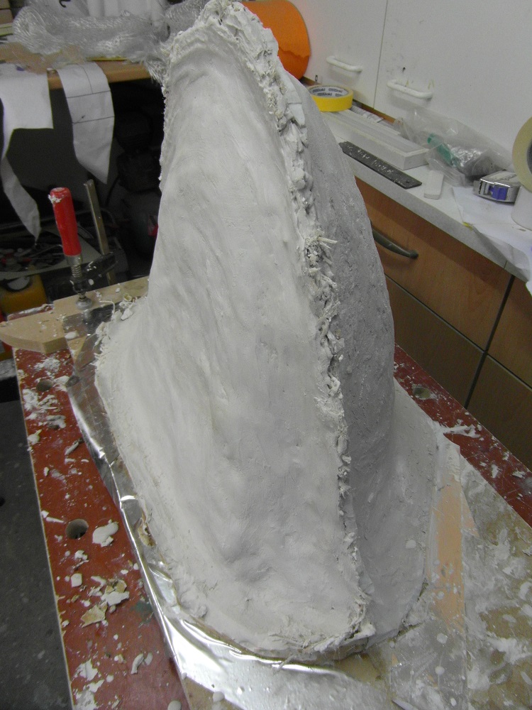

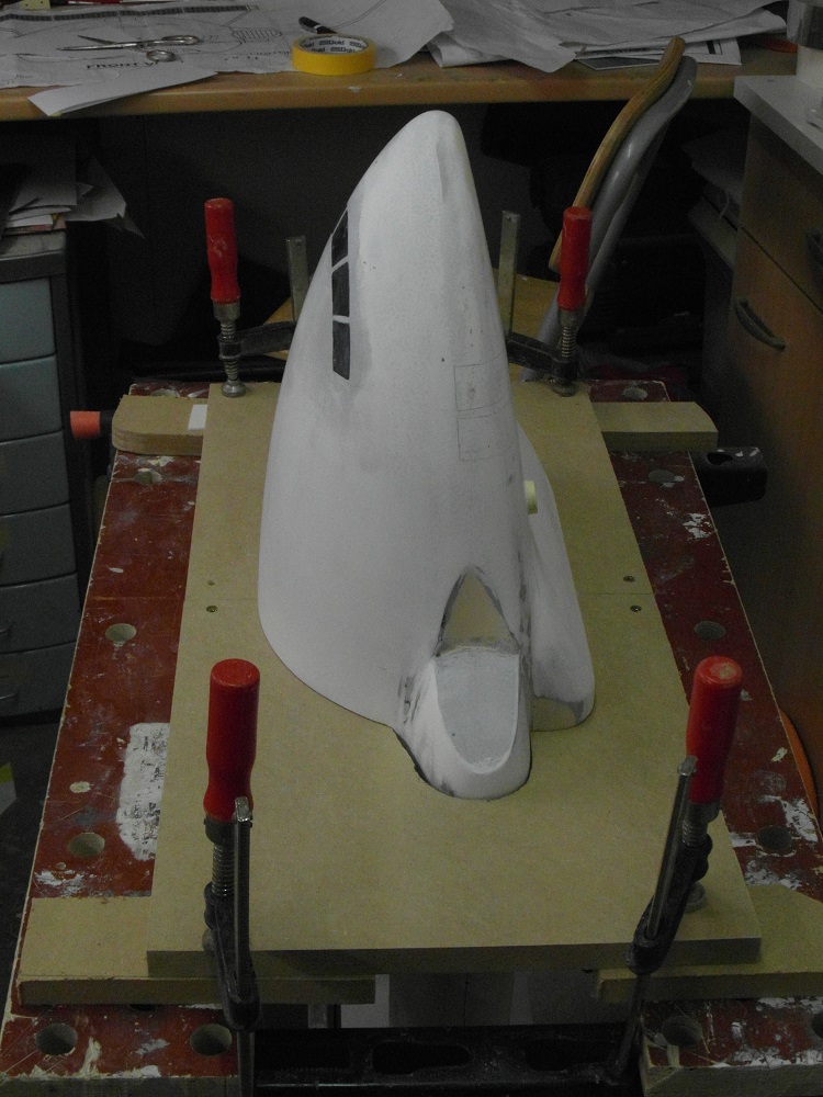

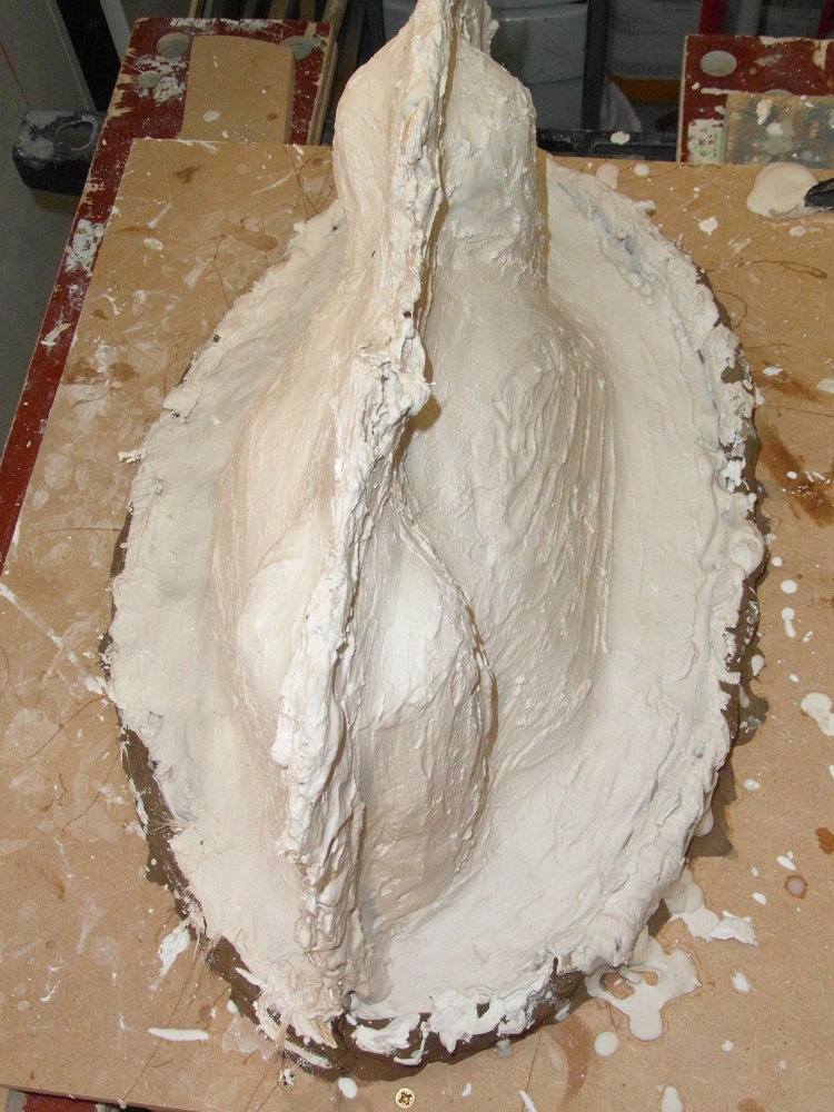

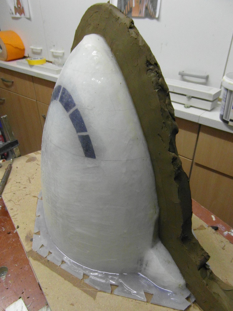

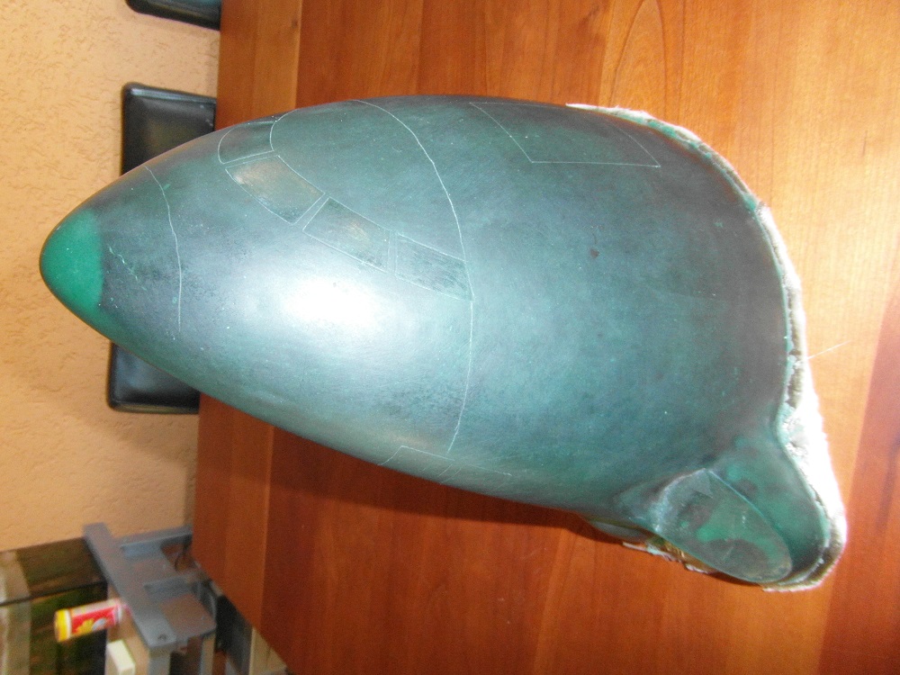

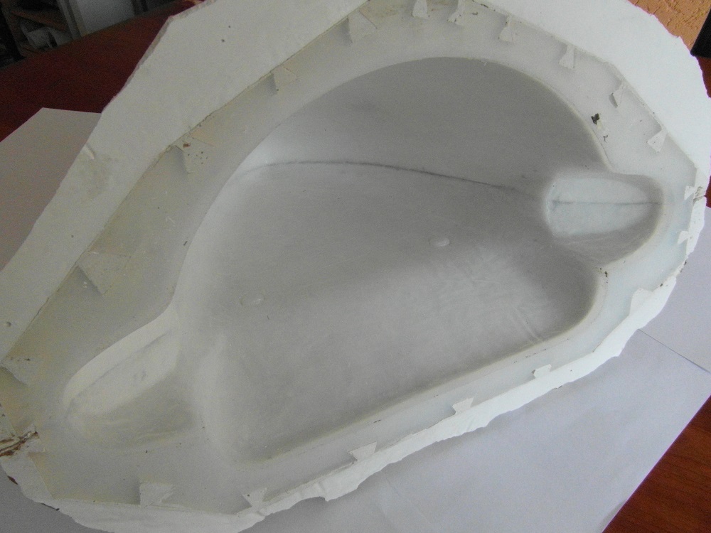

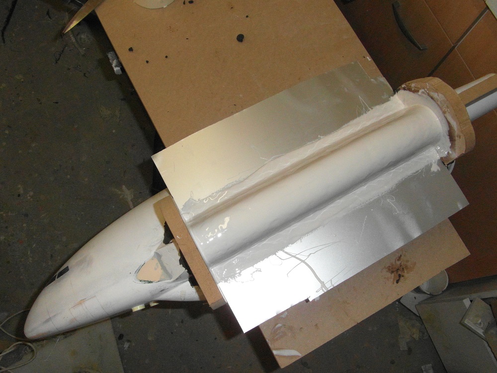

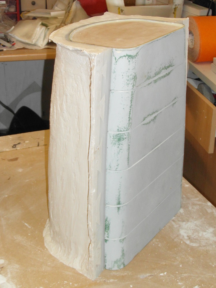

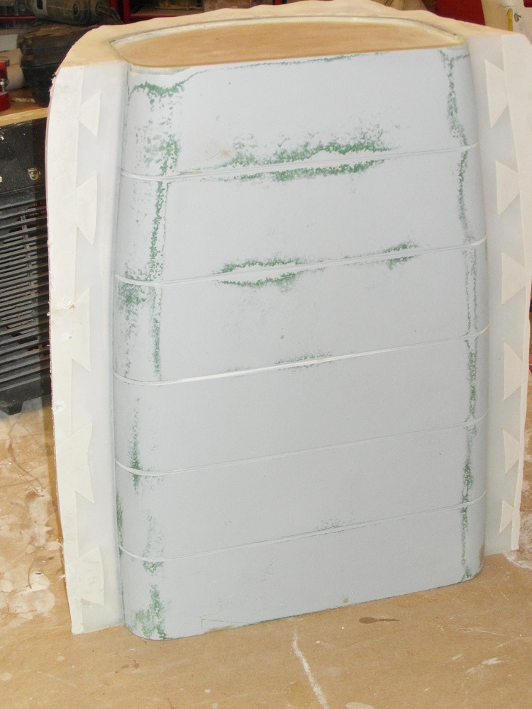

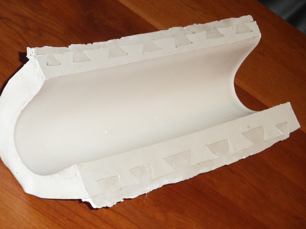

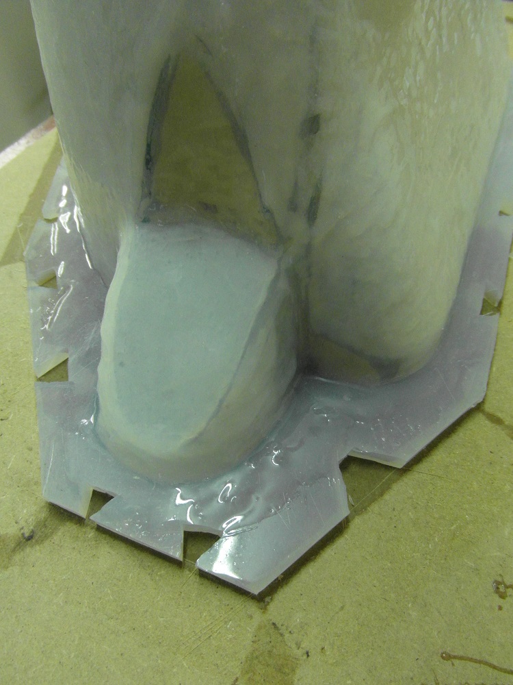

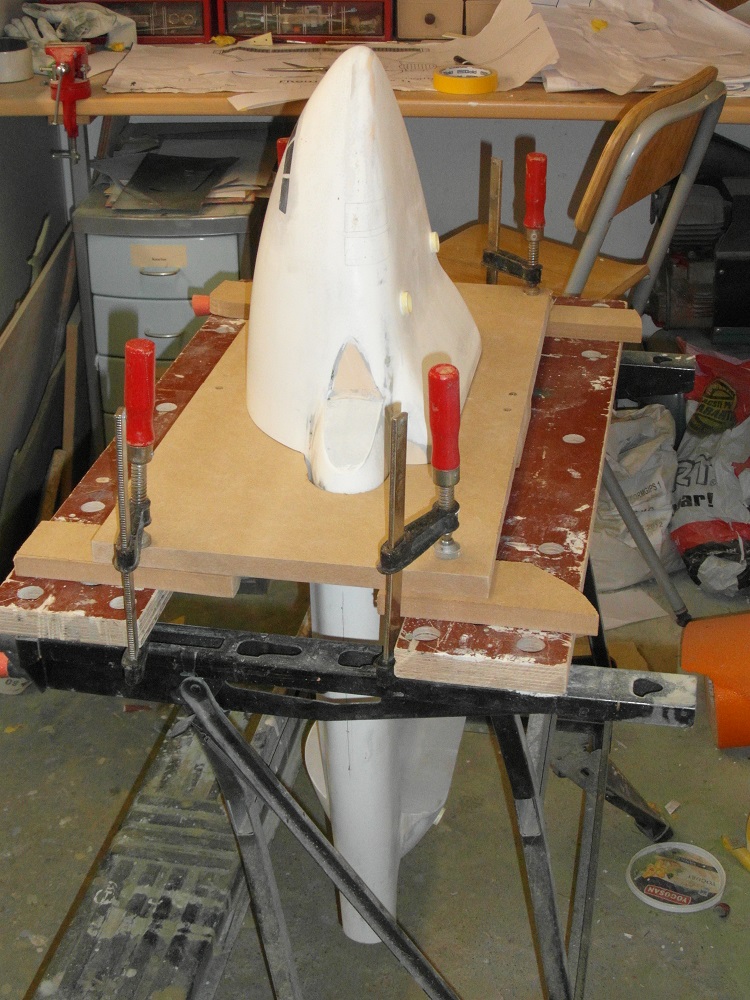

Now it is time to make molds of the model in silicone with plaster . SAM_2870a.jpgSAM_2871a.jpgSAM_4001a.jpgSAM_4011a.jpgSAM_4027a.jpgA two piece moldSAM_4040a.jpgSAM_4046a.jpg

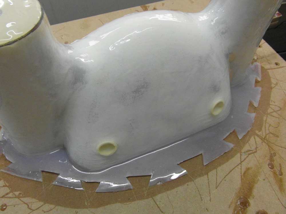

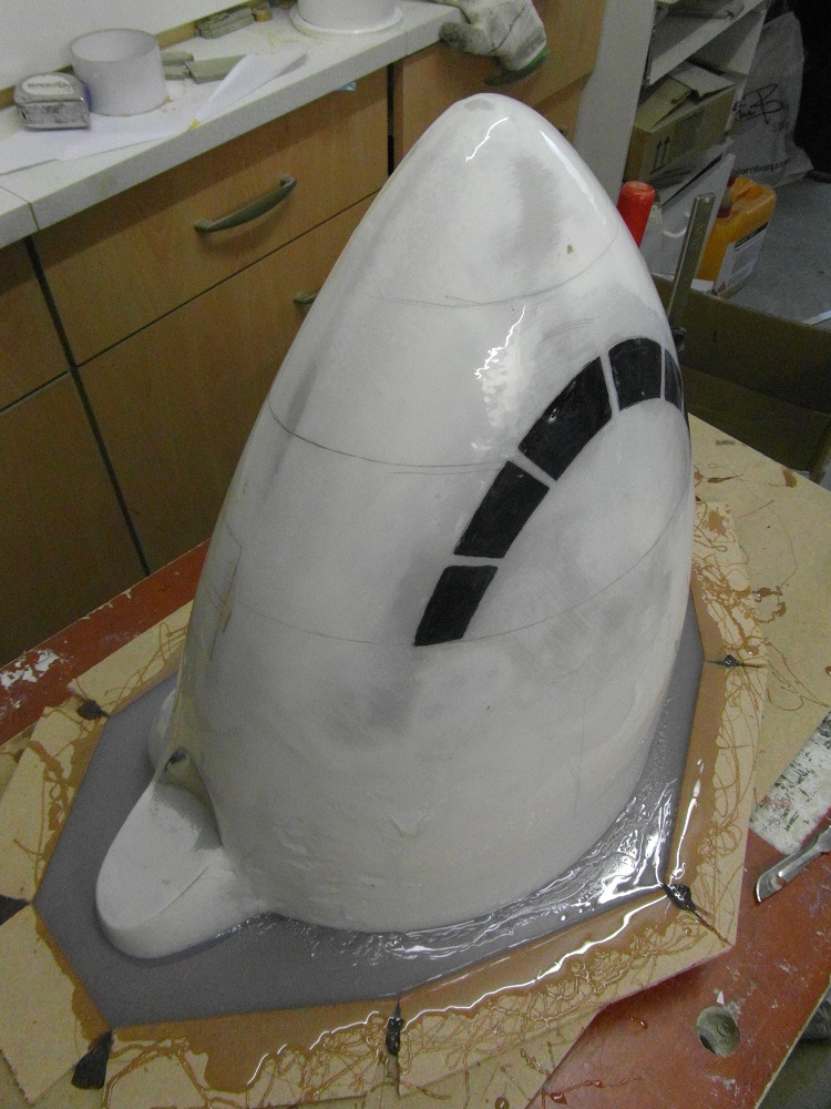

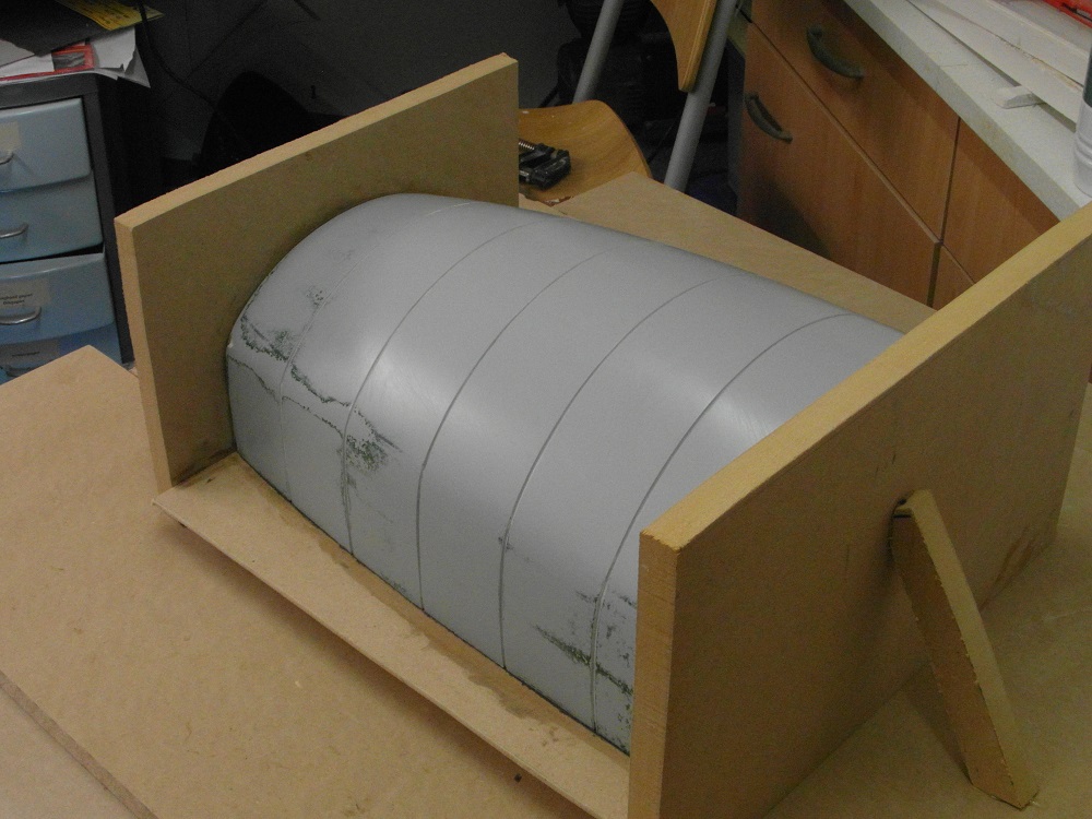

SAM_4097a.jpgSAM_4114a.jpgSAM_4120a.jpgthe head and the backside done in silicone

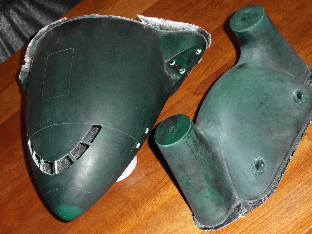

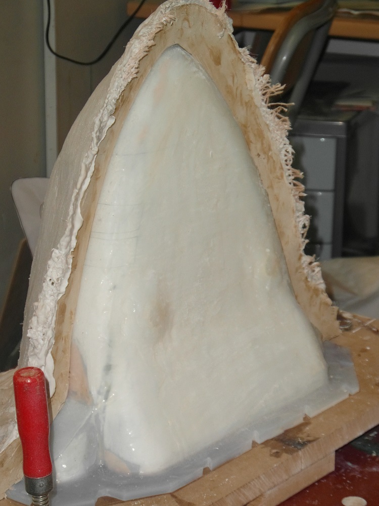

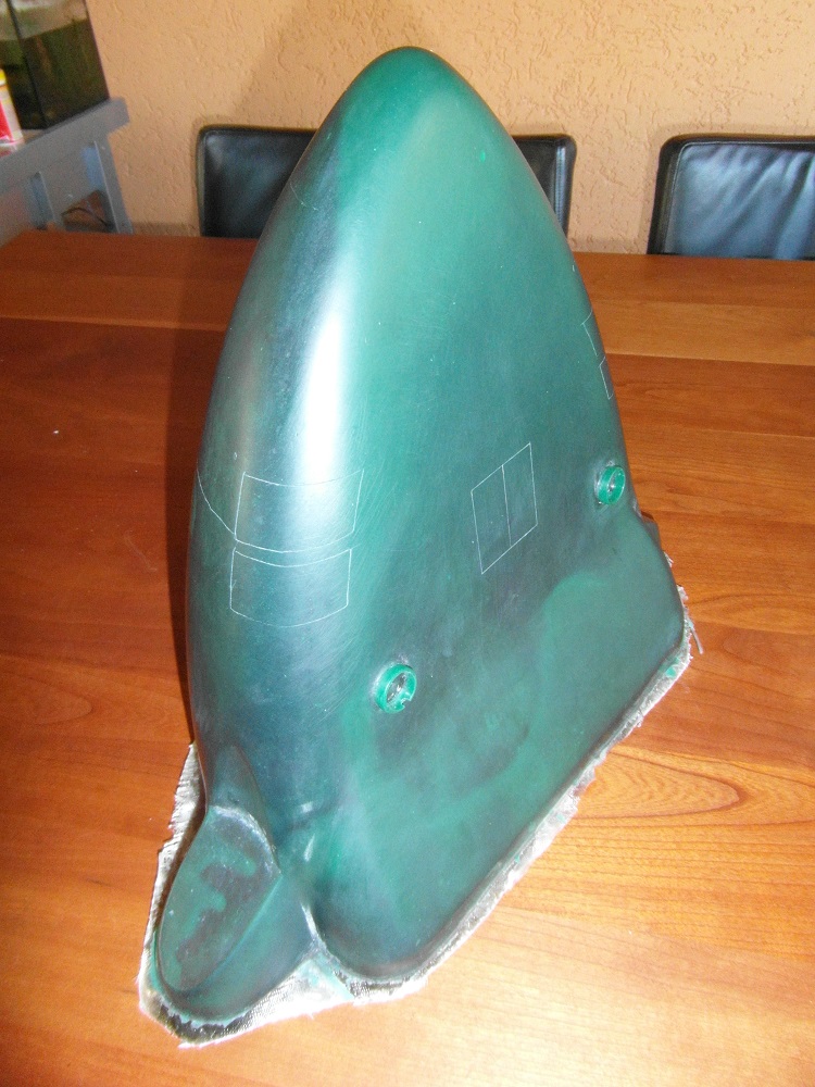

SAM_4123a.jpgSAM_4125a.jpgfirst epoxy with fiberglass cast done

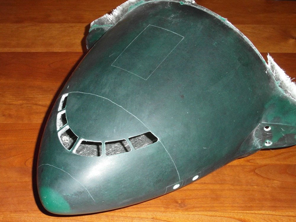

SAM_4164a.jpgSAM_4165a.jpgOpened the windows from the head and cast the back to
