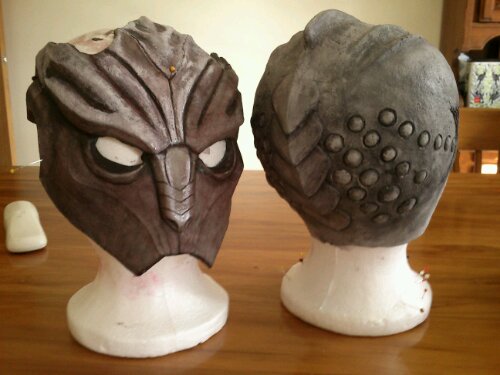

That's actually after and before ;) Wanted to show the final effect first.
So the cast is a matte grey latex and i really wasn't sure where to go with the colour. Normally I cast in flesh and am able to paint and tone based on how the colours changed over a semi-opaque ground.
So I used black airbrush tattoo ink to define shadows and get worked in to the deep surfaces. I washed all the pieces in the way, starting with the scalp and scaled spine then started on the face and got a bit lost. Okay so it needed some warming. A little red and tiny bit of white in black and it makes a maroon. Well I'll wash with that too. It's a tad harsh but hey.
And then stippling a grey the same tint as the latex (yeah, it sounds mad but I have essentially given the skin a layer that mimics blood vessels and muscle and now this is the skin that shows hints of that from underneath.
he grey though lifted the layers from underneath (all sponge work at this stage- latex sponges which soak up the ink but at least do a really nice stipple). So a layer of white has been used as a finall base colour.
Next up is to test a few colours in my airbrush to warm up this base colour. I may even be able to use a powder to buff in. But right now I have no really transluscent pigments to work with and these next layers do need to be able to be misted in super fine layers.

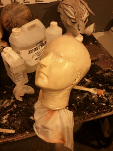

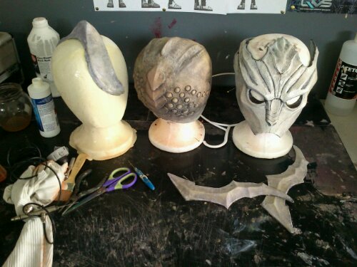

Tinting with my airbrush and canned air... I really really need to get myself a proper compressor. I can buy brushes cheaply but finding a small compressor? With proper transformer adaptor? Sigh.
Also the wig form is being transformed in to a bald cap maker. And I have a head cast I'm currently sculpting on to make a Madam Vastra headpiece.

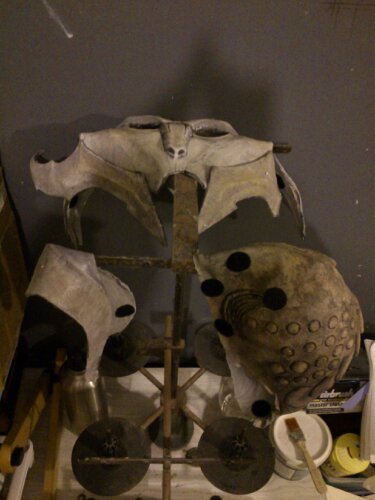

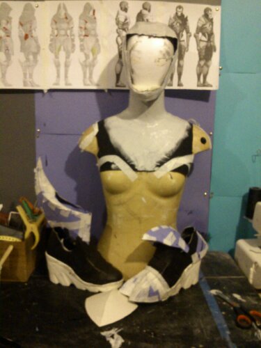

Sorry for the blurry pics, having so much tech fail atm...
Today I finally templated the pointy Turian pieces (elbows, calves, spine, toes) and got latex on the cowl support for the latex mask pieces. With a little bit of patience I can get the jaw to work independently of the rest of the face, even if I can't get the mandibles too. It's a bit of a case of going for correct proportions than trying to get articulation- female Turian heads are much smaller than males with skinny little necks. It has to fit the face and skull which means no room for anything underneath. In fact I may have to tape my nose flat when actually wearing the pieces.

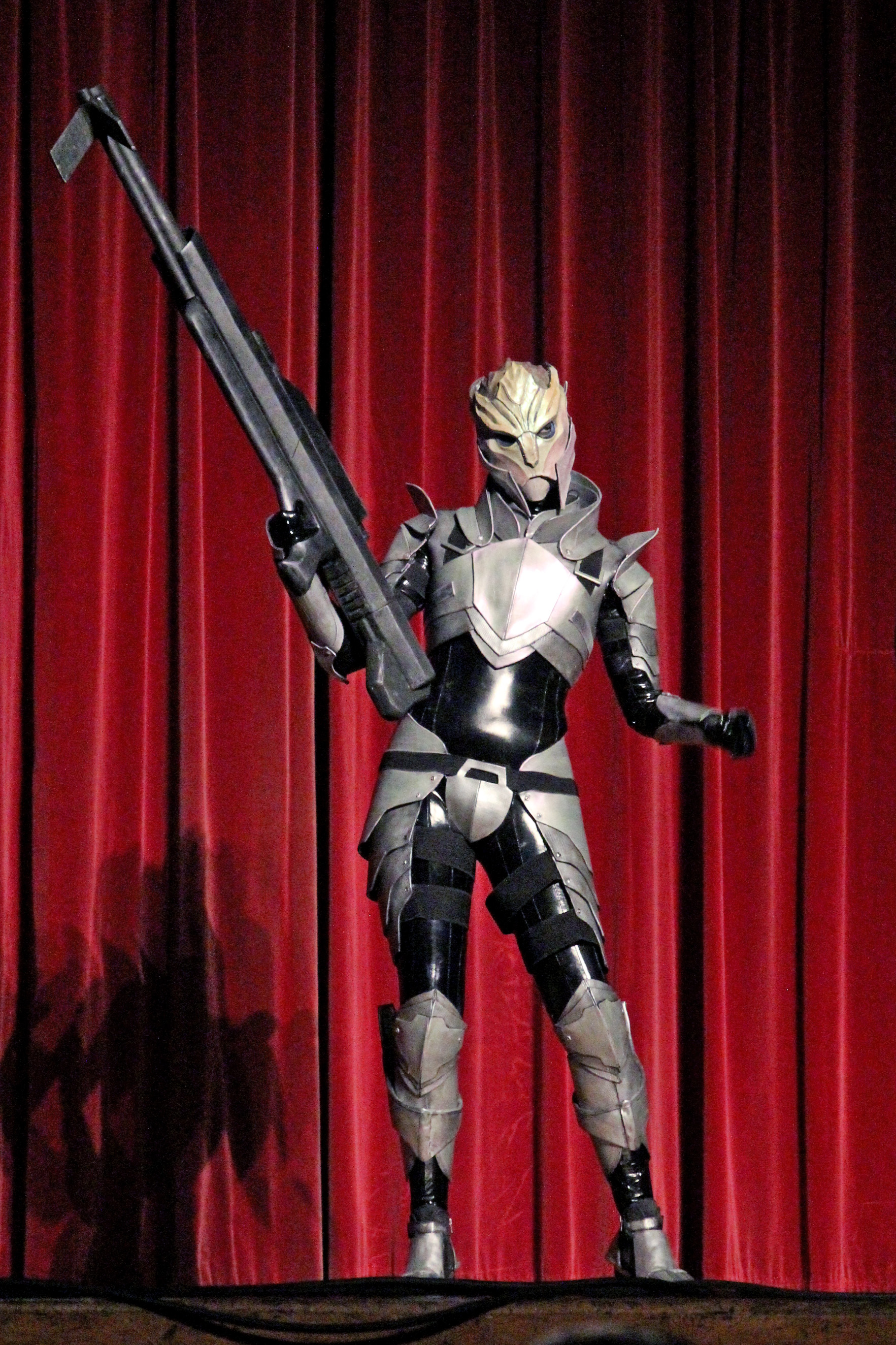

Photos by Dr Maul here on theRPF)
So I may have abandoned Nyreen in favour of going all glam ;) Armour is my Blood Dragon (sans dragon by choice and fate- I wound up liking my interference overlay too much to put the dragon on but it a bit too close to the event to do a really good job anyway.)
This is Neimhaille. I created the name years ago (like 99) and it's not until now I really feel the name just fits. It's a mix of glamour and grunt :)
Everything in the photos was made by me, and uses techniques from leather tooling to sculpting to fibreglass. So while I was only able to wear this entire ensemble for an hour tops it was definitely worth it :)
I had started detailing the gun but again was getting close to crunch time so I filled in all the cuts (cry) and sanded back to a plain surface.
