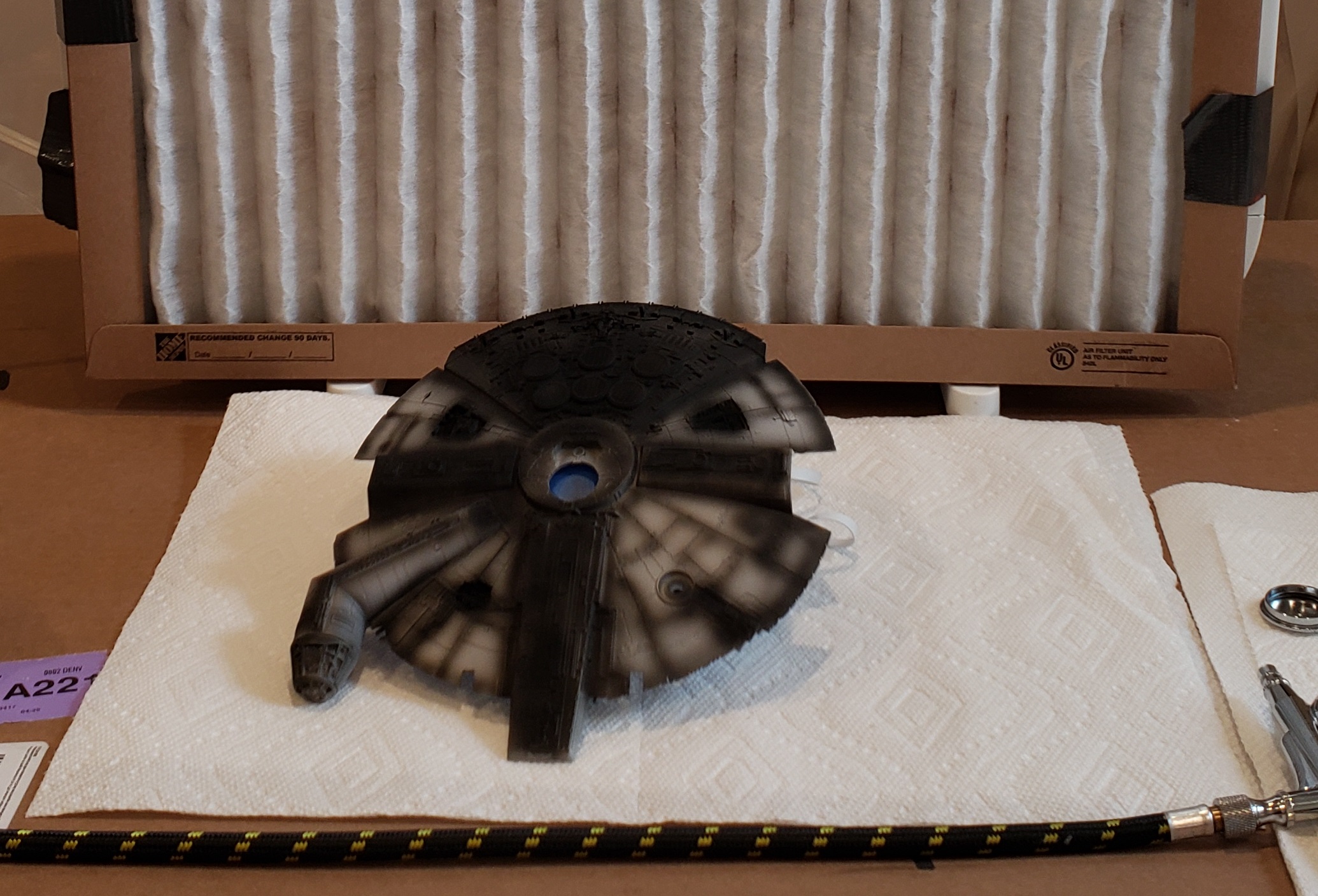

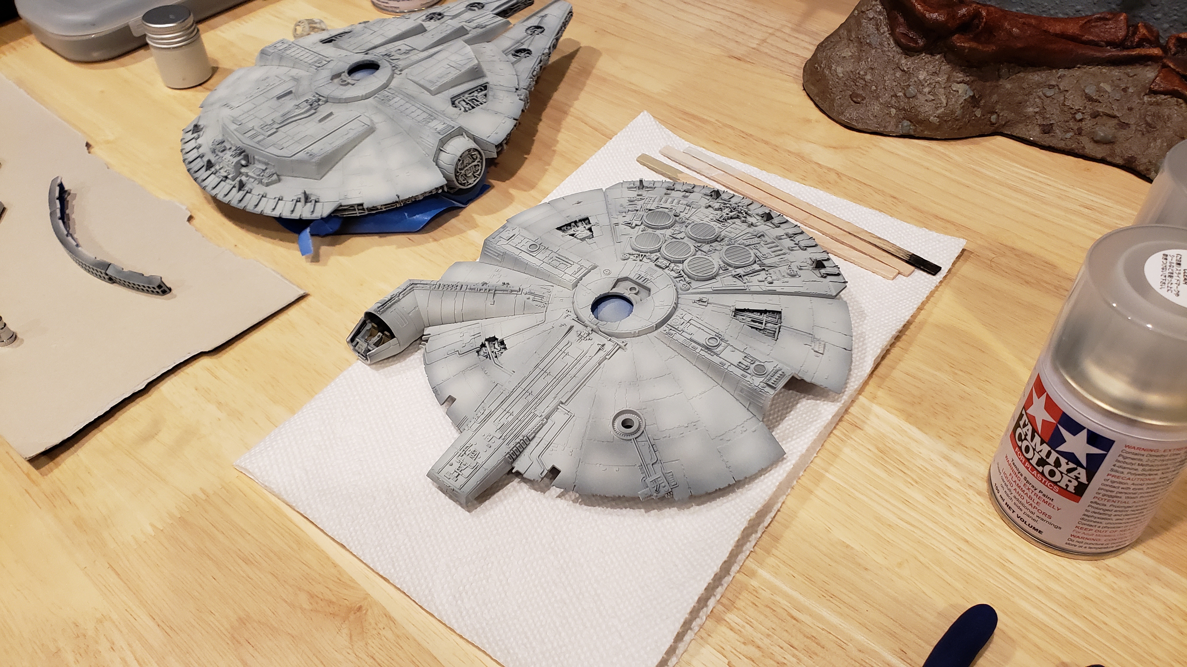

I second that advice, it's exactly how I prepare, prep and finish all my star wars models. I do like to throw down a coat of Tamiya Fine surface primer. Then I hit the spots I want to highlight with some XF-1 flat black.
The oil paint really gives it character, it creates a very realistic grime/weathering look (better than the acrylic, in my opinion, the oil is more 'organic'). Plus, the oils take days to dry so you can mess around with it all day. I really like the Abteilung line of oil paints.
Here is kind of a 'before and after'. You can see all the black areas show up and help start the process of discoloring the panels and creating a shadowing effect on the rest.
Also, my advice is to snag a cheap kit and throw it together for testing. I always have some lame kit kicking around that I use to do paint testing on.
