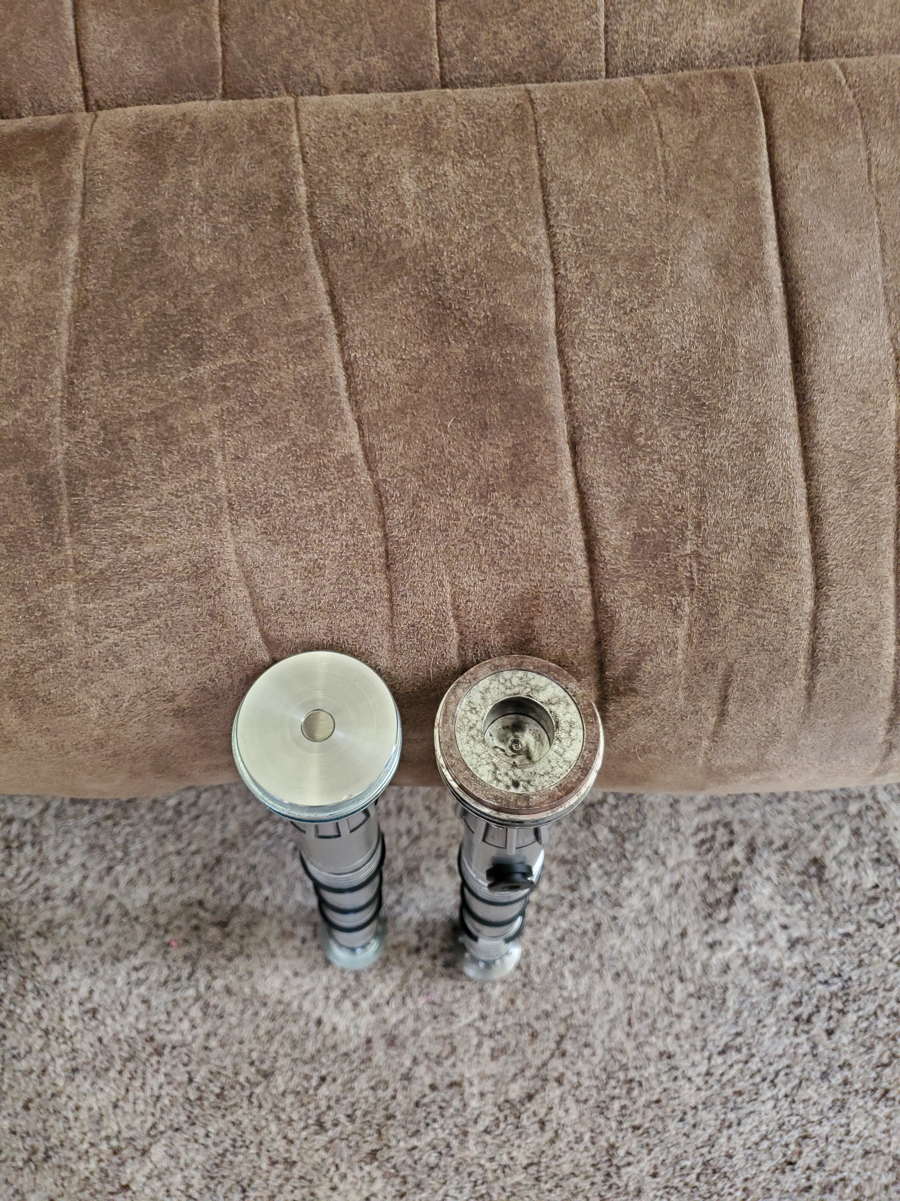

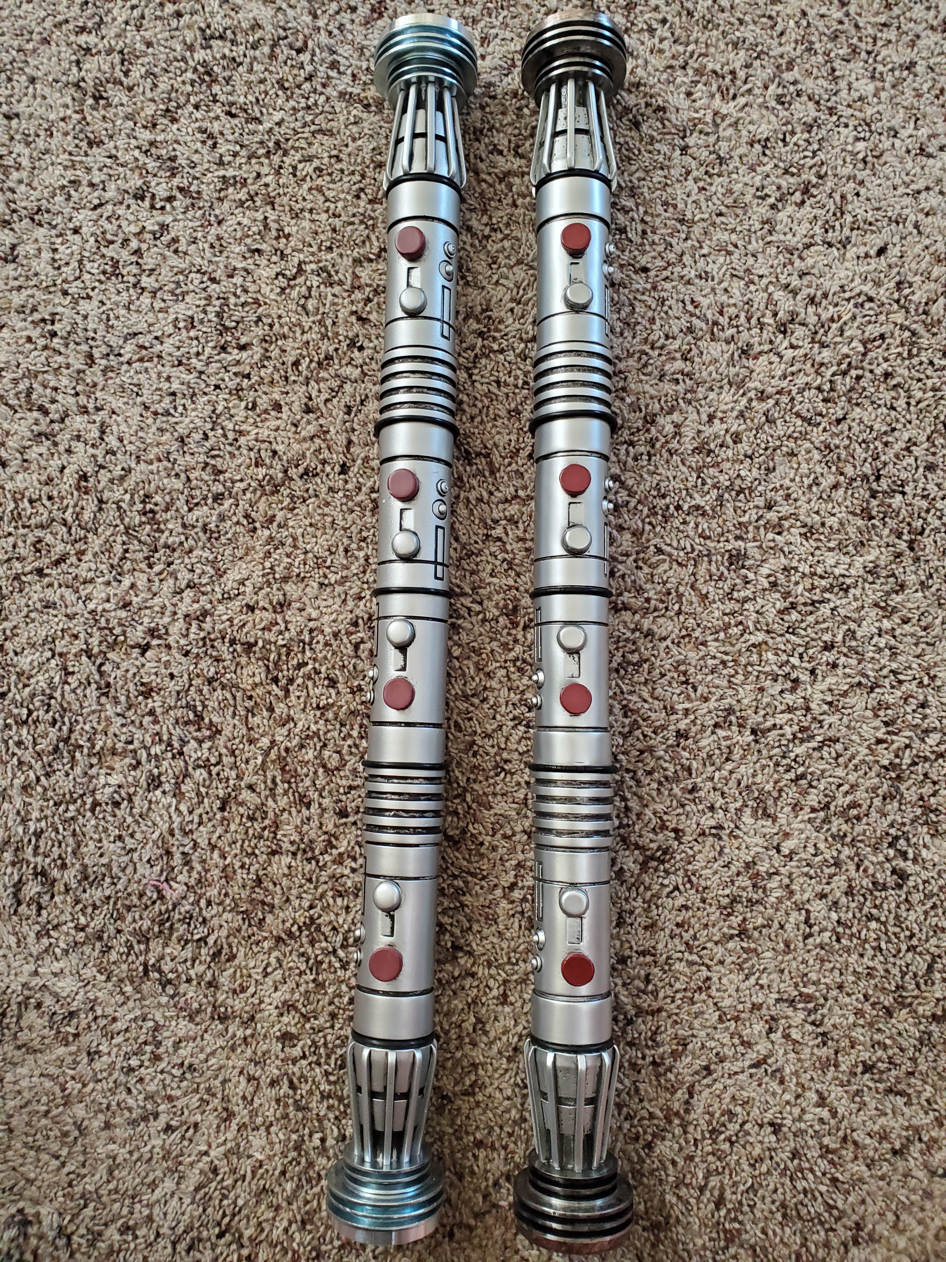

Here is my EFX Darth Maul Legend saber compared to Dans saber. This is absolutely impressive. The only thing that’s different on it are the top part of the emitters. Excellent job Dan and thanks.

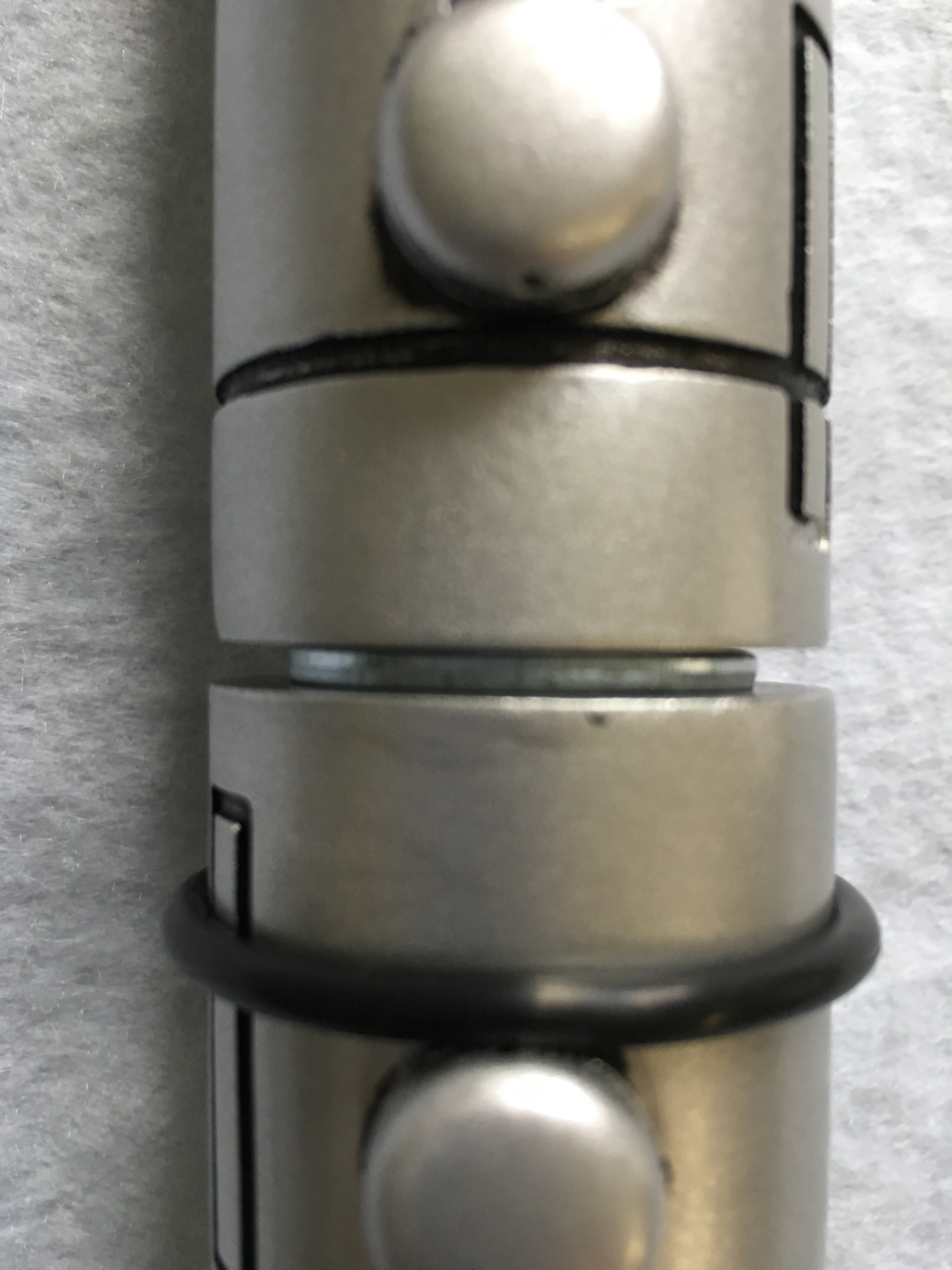

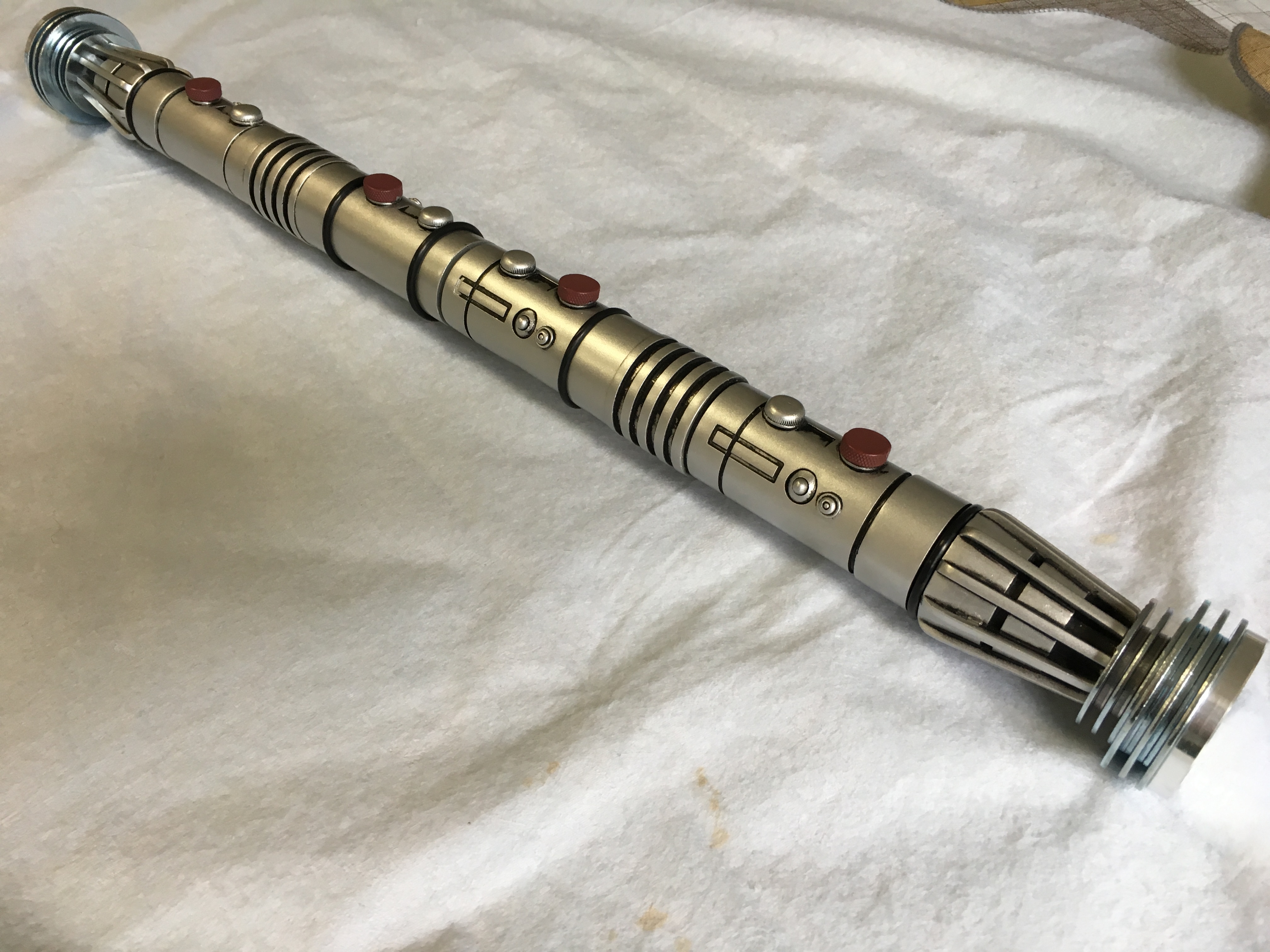

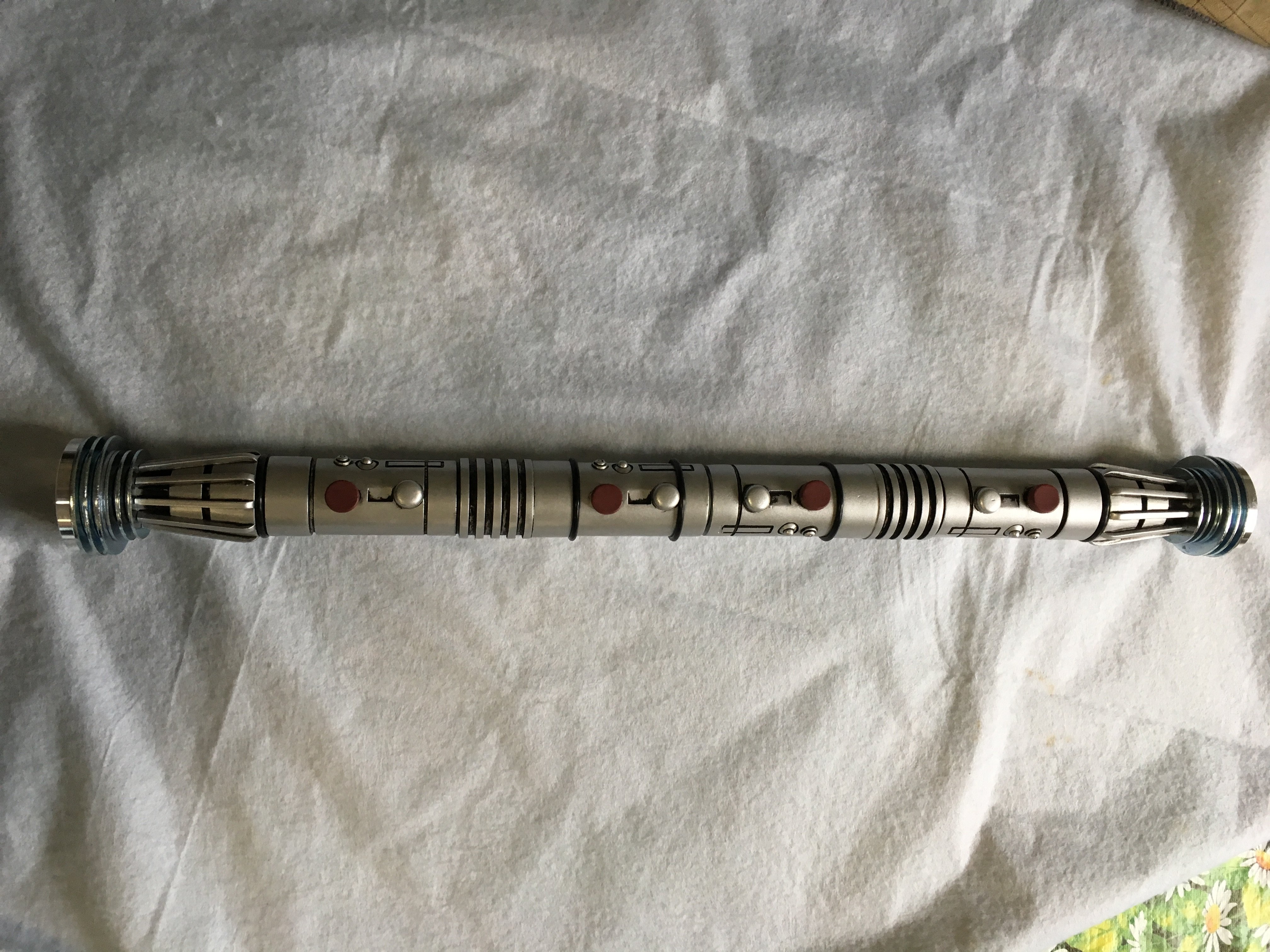

Mine is now complete. My approach that might be worth noting
- I used a metal 3/8" washer as the in between middle hilt piece
- I used a manual saw, no electrically powered equipment. I sawed the threaded rod in ten minutes, with a clean edge. I used a 3/8" nut to clean the sawed point, barely any cleaning/smoothing needed. A manual saw with a thin blade can sit in between two threads, thus giving a very clean cut
- Alignment can be done with both hands, no need for a second person. Screw on the emitter at sawed end of threaded rod and then compensate, bit by bit, by reversing the hilt
- O-rings provided are very tight. These can be fitted by enlarging the O-ring's diameter/elasticity using the metal hook of a coat hanger. Fishing wires are dangerous and could cut your fingers.
you now have a very nice replica, I hope you are happy with it (y) your O rings are at the wrong position though, check the reference pictures ;)
