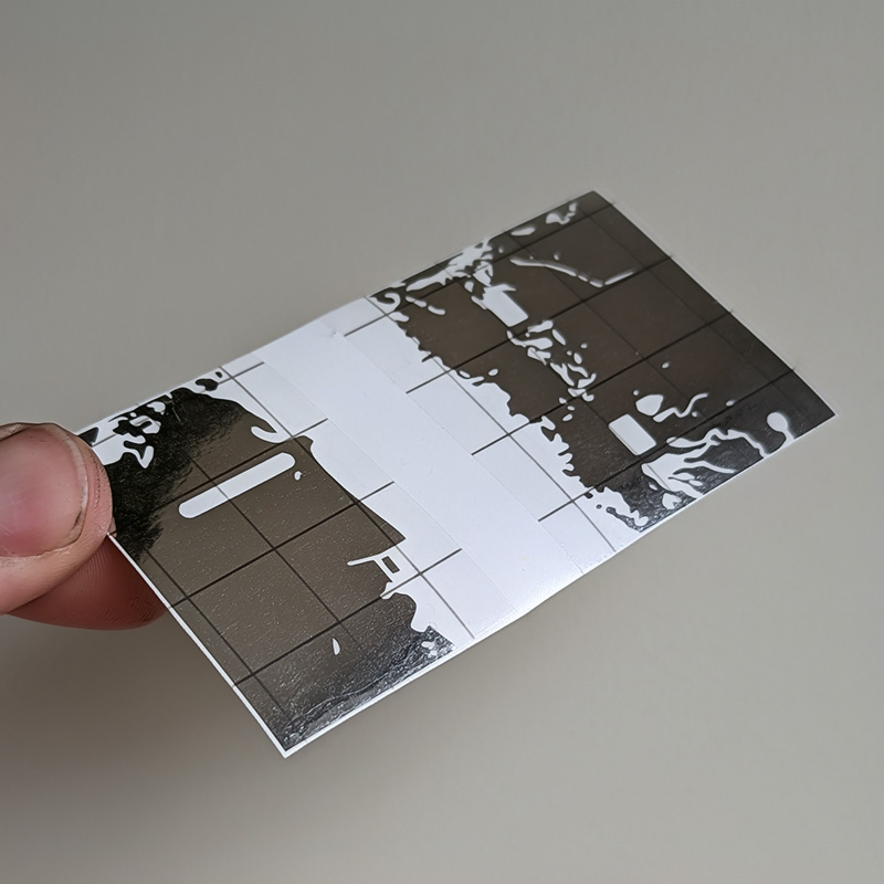

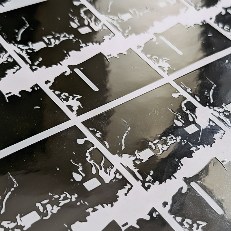

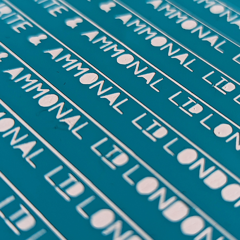

I also dedicated some time this week to cutting stencils and clamp foil. This is all now cut and weeded. So when the time comes to apply these, they're all ready to go.

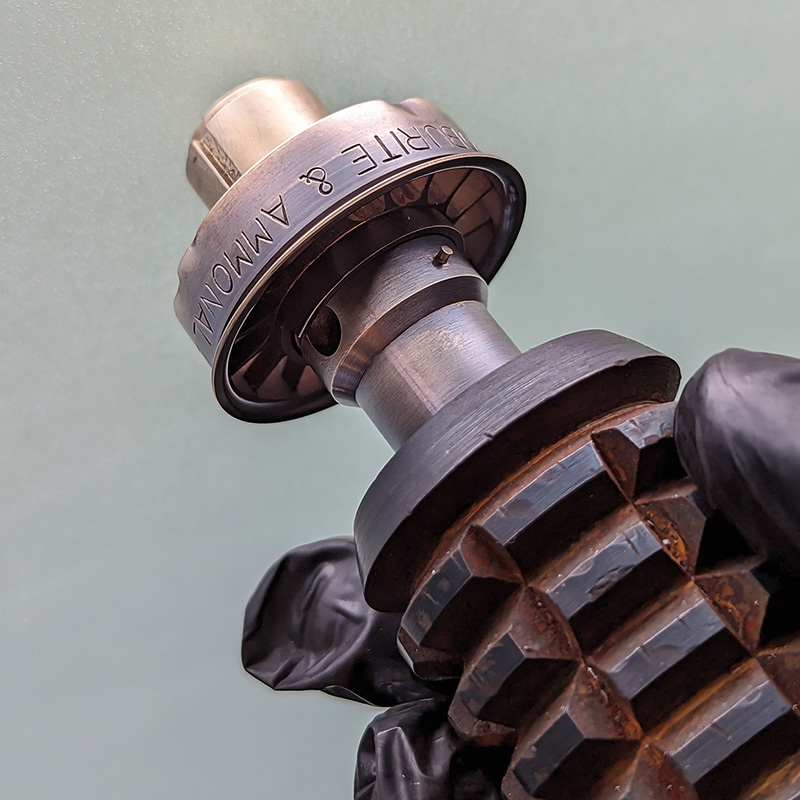

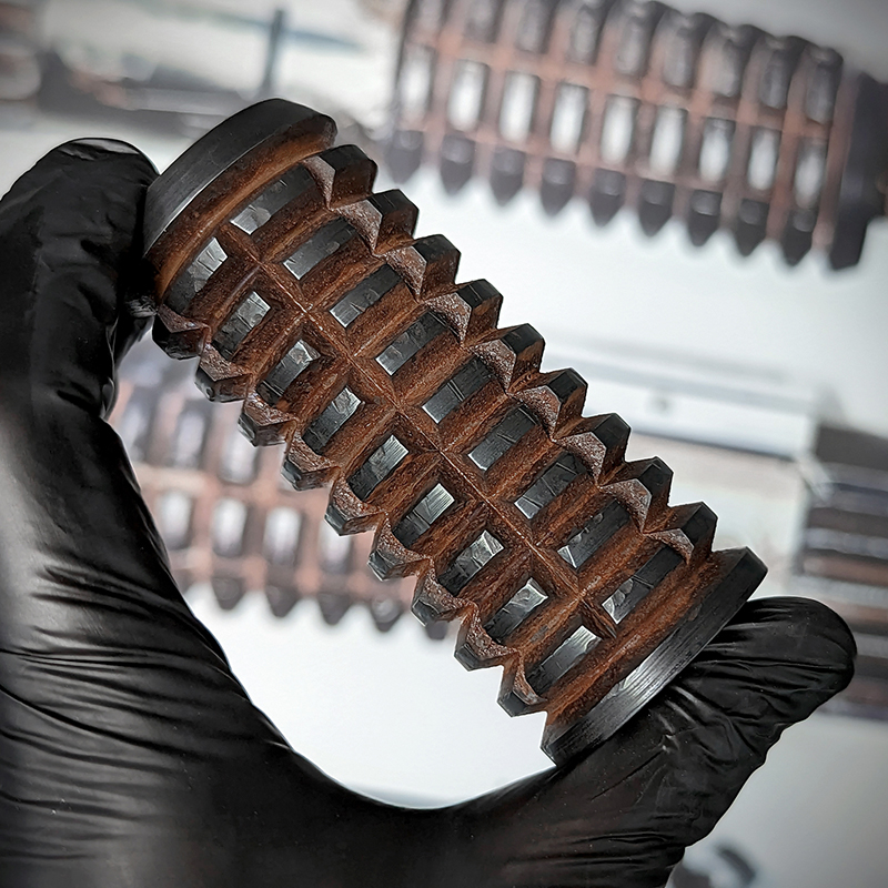

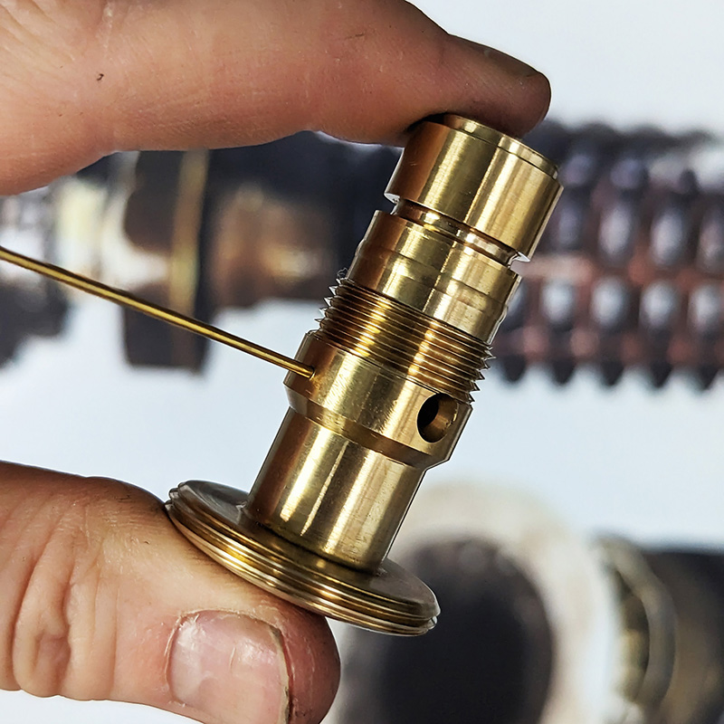

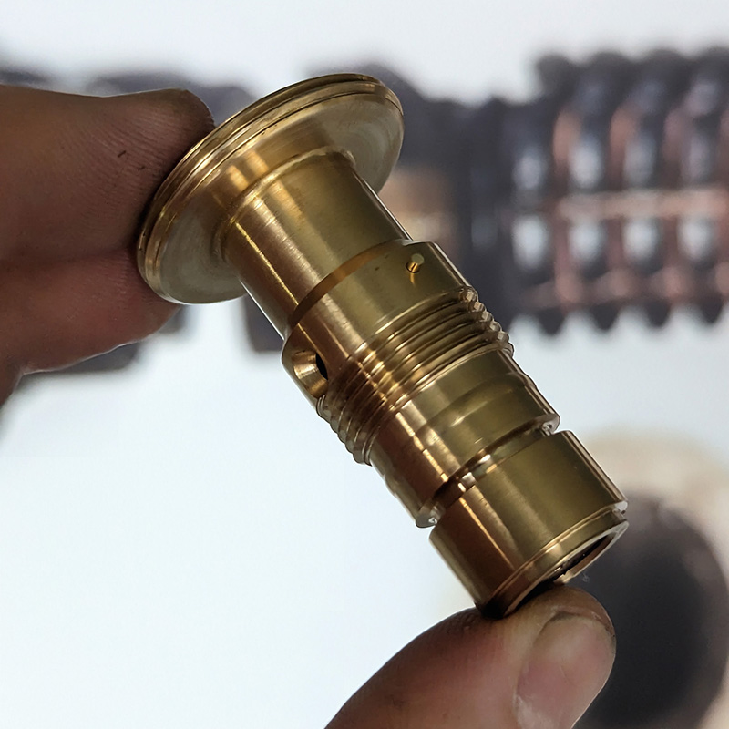

The latter part of this week was spent concentrating on Emitters and Handwheels.
The emitters have all now been chemically treated (this had been done previously). This takes away the shiny machine finish and just dulls the surface ever so slightly.
The surface pitting that is visible on the example which was used on the original prop was then applied to each of the outer emitter parts. This is done by hand.
All of the parts were then heat treated. This involves simply leaving them sat directly on top of an electric hob element.
I have tried a blow torch previously, but found that the electric hob is much easier to control. It takes longer to achieve the desired effect, allowing you to take them off before they turn too dark. They can also be done more than one at a time, which makes up for the longer process.
The aim of this stage is to achieve the golden yellowish colour that we see on genuine used parts.
After this, the carbon/grime build up is achieved by hand, using oils/brushes. As much as I would like to achieve this effect naturally, it just wouldn't be practical. I've seen people achieve some nice results by coating in oil and then burning. I am aiming for consistency across all of these though, and figured the pigments in these oils are basically the same, but using a brush to apply them gives me the control I need over the final look.
To start with, I cover the whole part quite heavily. I then use cotton pads to wipe of the oils straight away, being careful to leave behind in hard to reach places. This results in a natural grimy look.
This is not the end result. I will be adding another pass with the oils where I dry brush/stipple some texture in to the final grime application. This is the next job for the emitters before moving on to adding the damage to the inner part.
The finished result will look something like this:

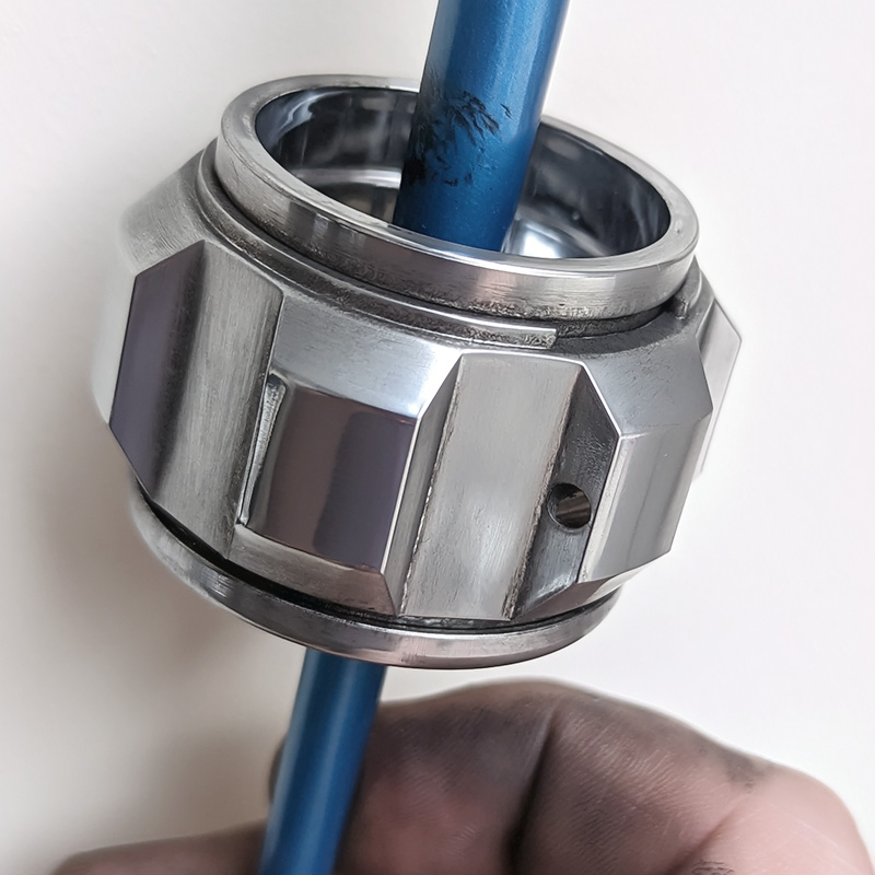

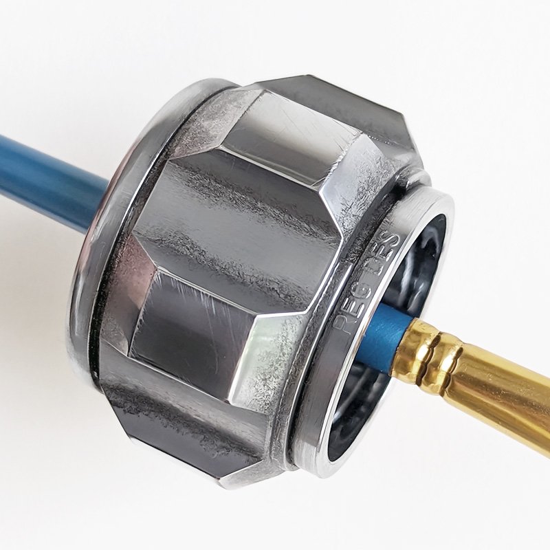

As well as working on the Emitters this week, I made a good start on Handwheels too.
All remaining handwheels have had their “REG DES” text aligned and set to the correct position.
All scratches have been applied to those requiring full weathering.
I've begun work on applying grime/dirt build up to weathered handwheels too.
For this, I use the same technique as the emitters. They are heavily stippled, being sure to get the paint in to all nooks and crannies. I then clean off the excess paint using cotton pads. The end result is what looks like a natural build up of dirt and grime in areas where it would be allowed to build up over time.

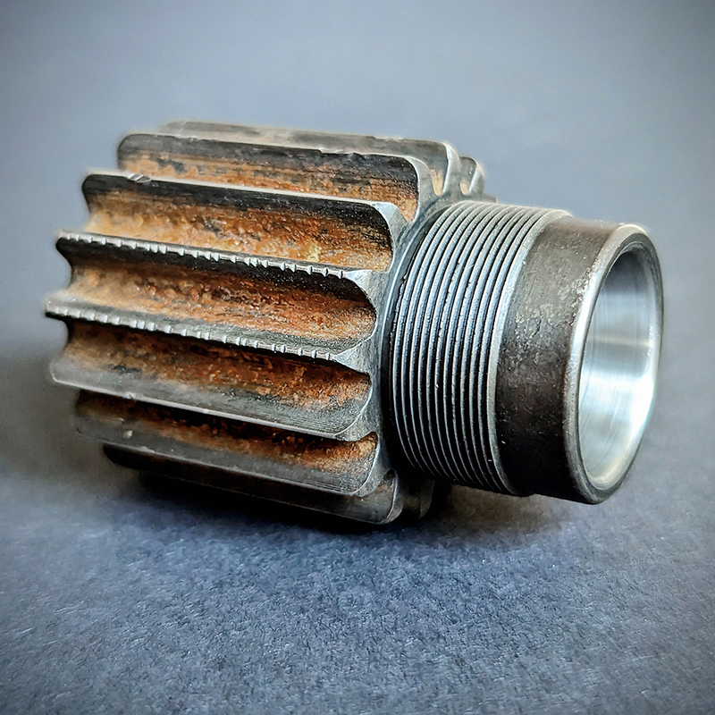

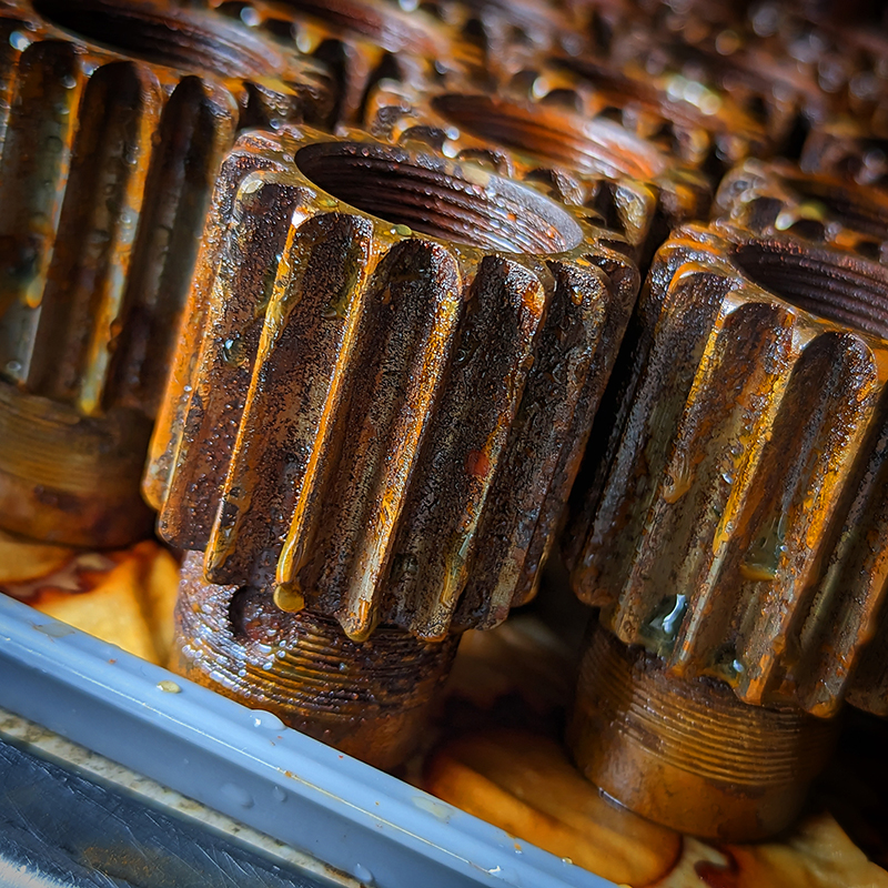

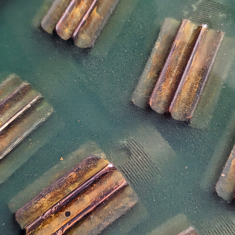

Following on from my last update, the week started out with me adding dings and scratches to the grenade bodies.
This was a long process, with every mark having been made individually, by hand.
They were then allowed to rust. As before, the process was kicked off with white vinegar. The vinegar is too strong for multiple applications. A second pass simply removes the first one, so the process is continued with water spray.
They are sprayed... Allowed to dry... and then sprayed again.... and again...
The process was repeated over a couple of days.

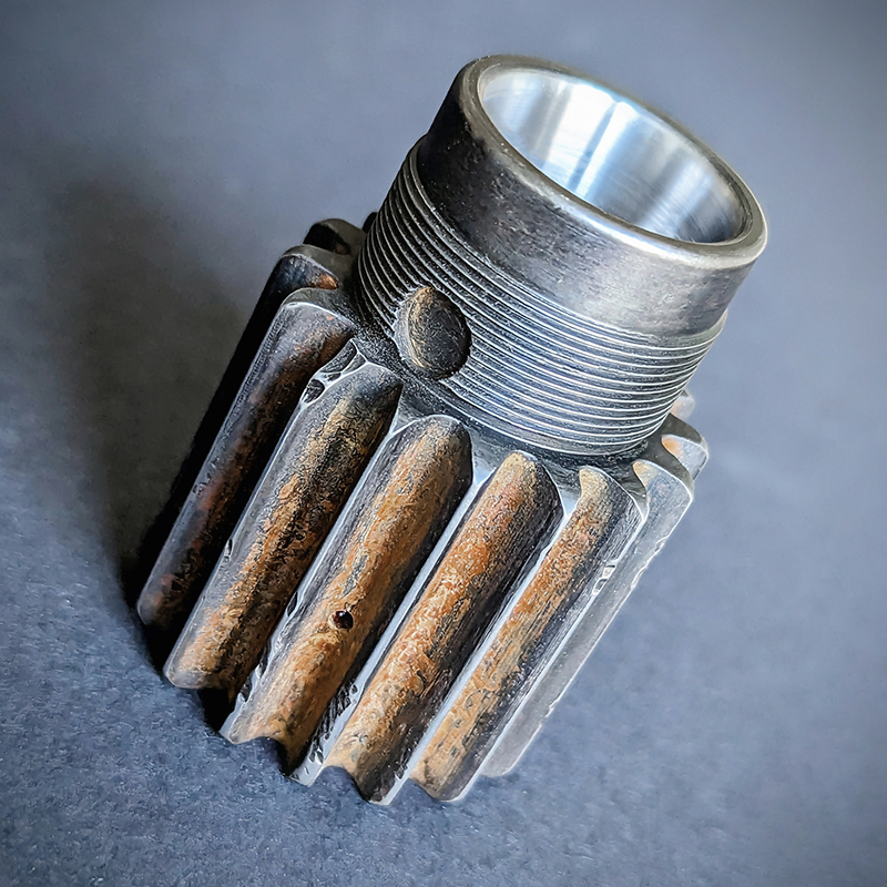

During this process, I was busy working on the booster damage.

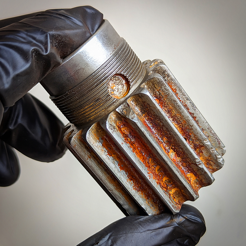

This is far from random, as the booster on the original prop has some very distinctive features. The damaged corner, where it was once welded to the barrel of a Browning 303 machine gun, the little teeth marks from the tool that was used to grip it whilst separating from the flash, and any other prominent features have all been painstakingly replicated prior to rusting.
The boosters then underwent the same rusting process as the grenades.
Once a nice amount of rust had built up, the vast majority of it was then removed, leaving it behind in places where it would have naturally been allowed to build up over the years.
The next task after this was chemical blacking…
The remaining rust acts as a barrier to the solution, which is exactly what we want. It means that the exposed steel is blackened, whilst the rust stays put.
After the blacking solution is applied. A small amount of dewatering oil is applied to the outer parts of the grenade. They aren't submerged. The oil is applied by hand, being careful to avoid the rusted areas.
The boosters are also cleaned up. Their insides are polished and fins sanded back to bare metal, as seen on the original prop. Dewatering oil is then carefully applied where needed. Again, being careful to avoid the rusted areas.

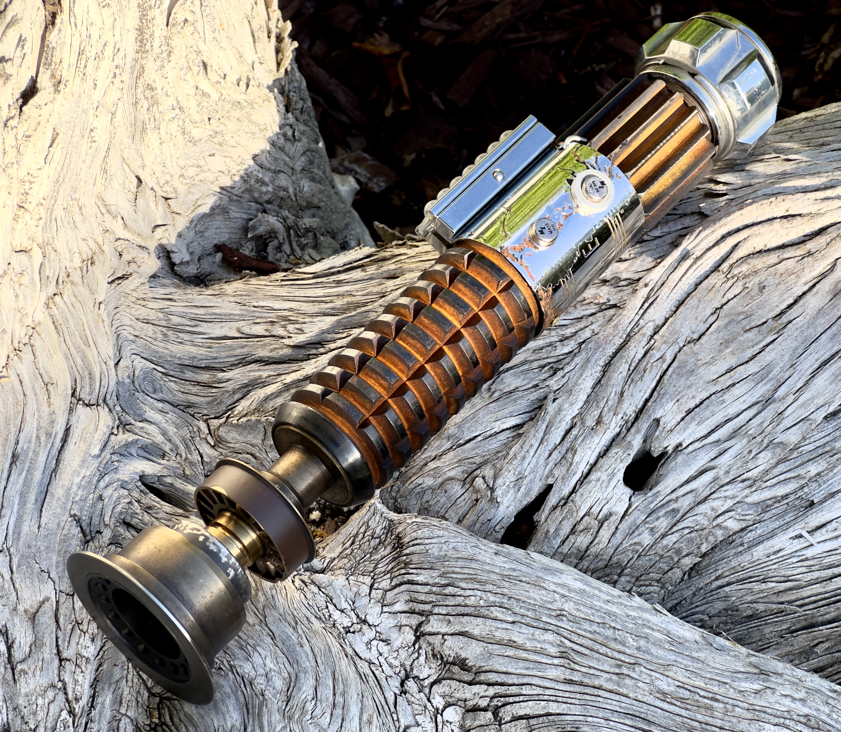

Got a new phone and decided to test out the camera with my saber in some dramatic lighting:
Those are stunning, Drew! Love it! :love: And thanks for sharing! :)

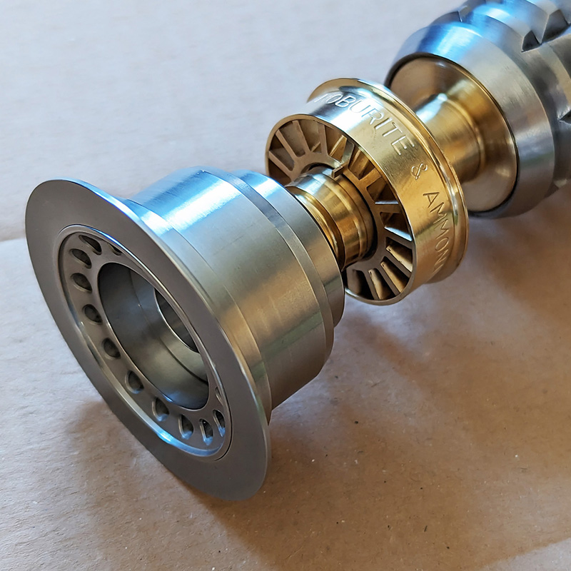

I’ve been busy this week working on the last couple of sections (Brass and Clamps).

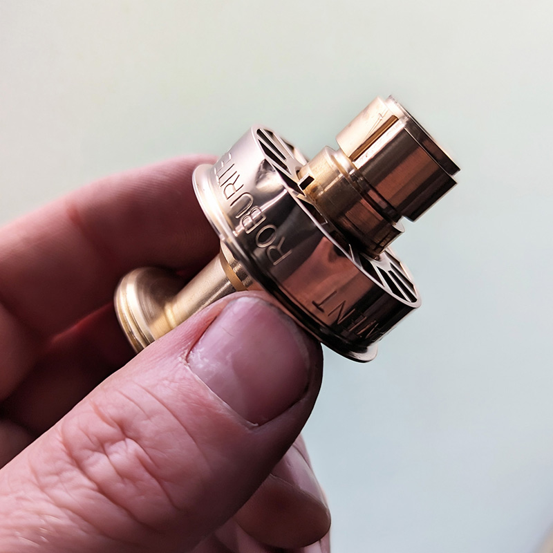

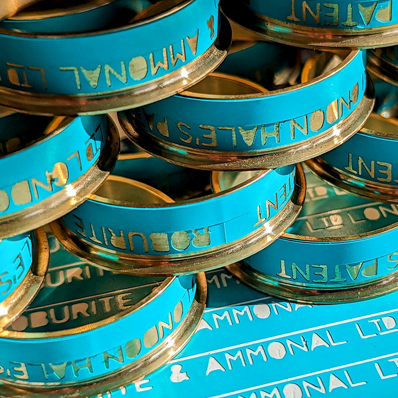

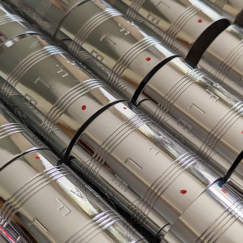

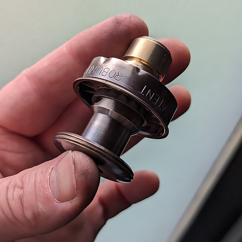

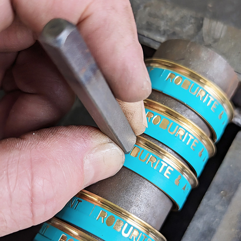

Towards the end of last week I began preparing the brass rings for stamping.
I continued with these this week and happy to report that stamping is now finished.
This was a long process and took up the first half of the week. The process is sped up slightly by working on a few at a time.
Wind Vane damage has been applied where needed too and I’m about half way through darkening. So batch two grenades are complete and ready for final assembly.
Why is only half of the brass darkened you might ask? Well, I’ve run out of Birchwood Casey Brass Black unfortunately and my new bottle which was ordered over a week ago appears to be stuck in Royal Mail limbo! It’s not something you can just walk in to a shop and buy unfortunately, so I’ll wait a little longer and if it doesn’t show up in the next couple of days, I’ll order another one (or get the seller to re-send).

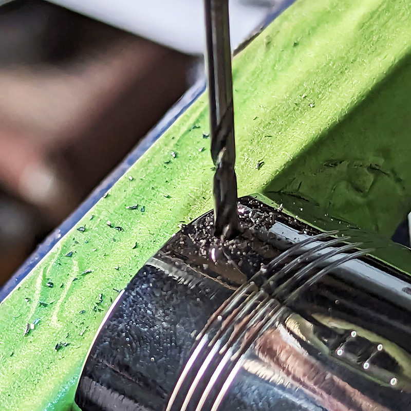

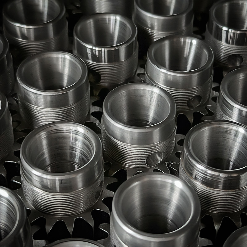

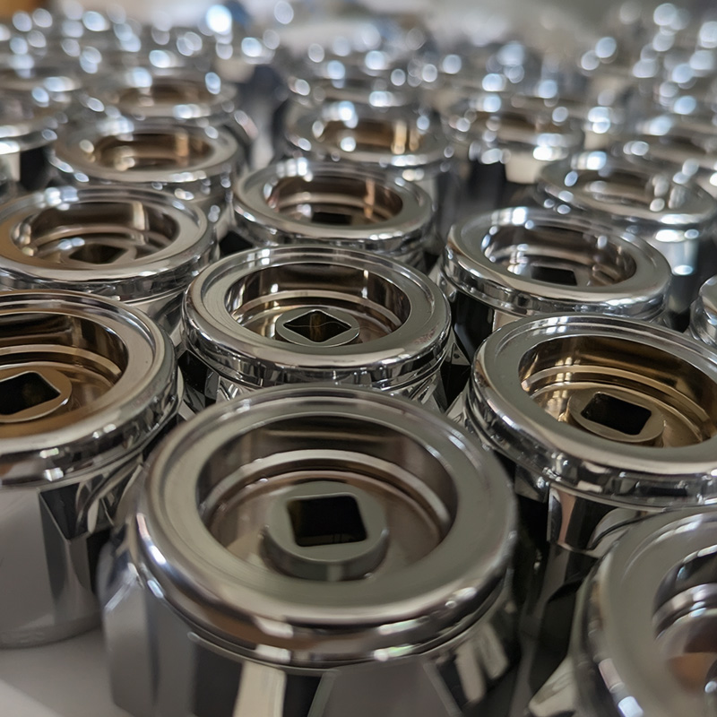

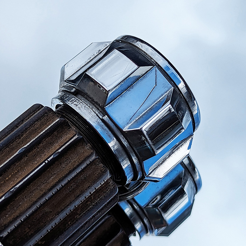

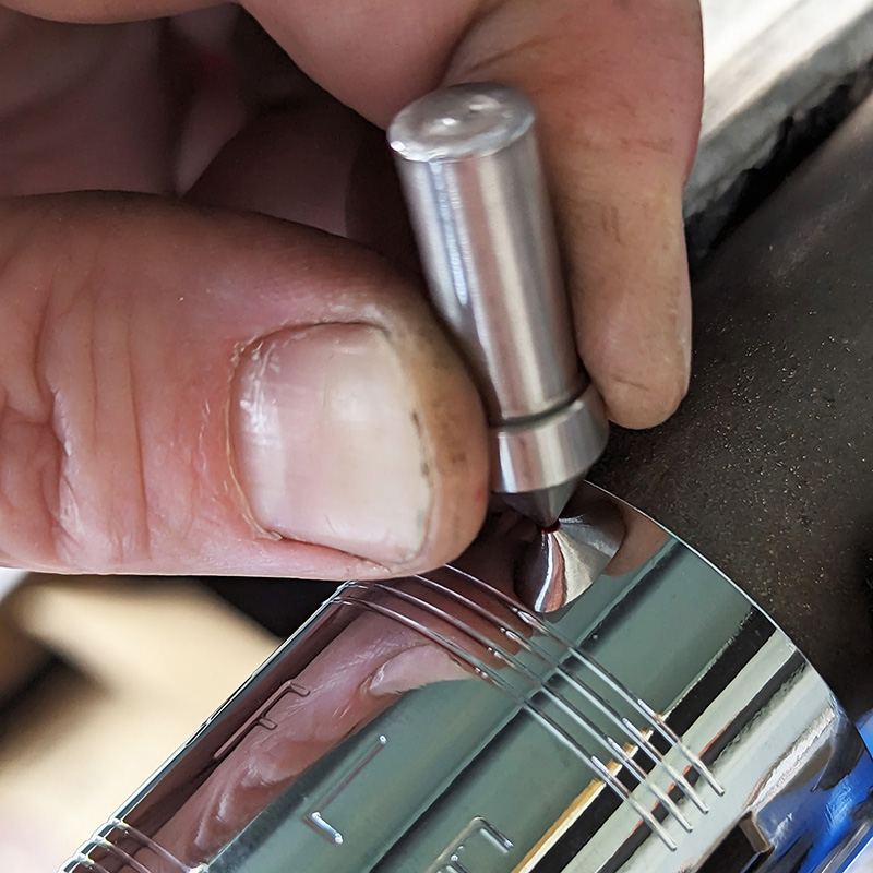

Moving on to the clamps, the first job was to mark them up for drilling.
The marks are then punched to prevent the drill from traveling on the chrome. I use a lath centre to do this.
Then It’s on to drilling….
And then finally countersinking for the brass screws…
Exponentials really start to come in to play when it comes to things like this.
You might think that drilling the clamps would be a quick task, but when you multiply each hole by the number of operations, and then multiply *that* number by the number of holes in each clamp…. And then multiply *THAT* number by the number of clamps… well, you end up will a rather large number of individual tasks.
That said, we got there! And all clamps have now been drilled!

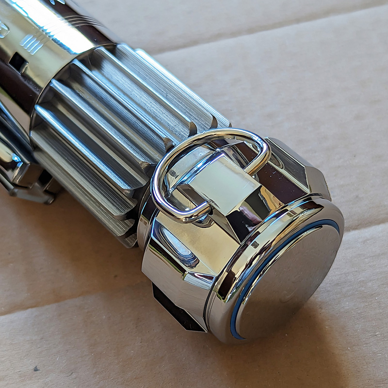

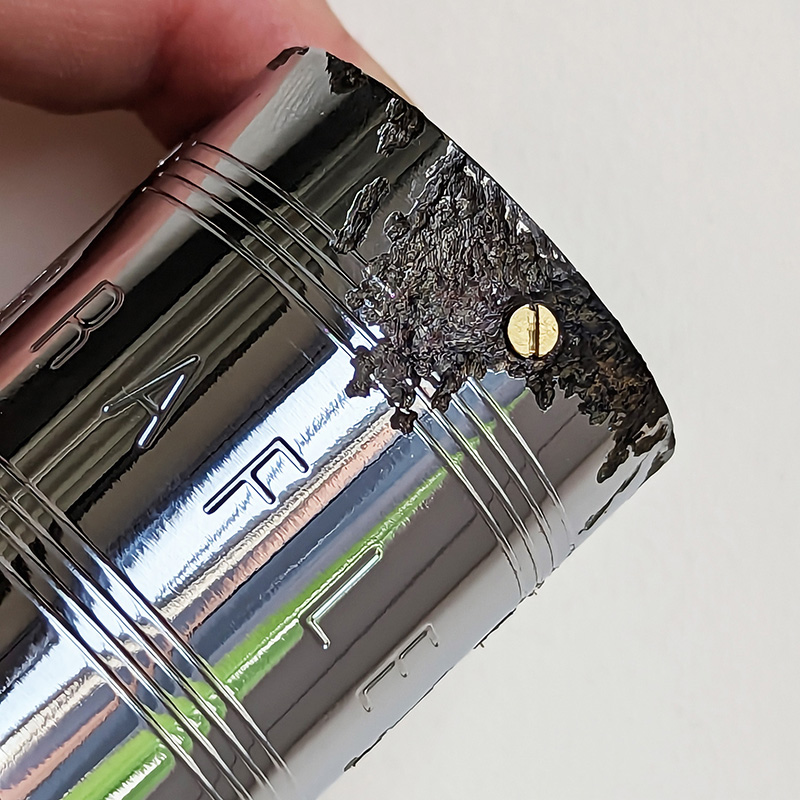

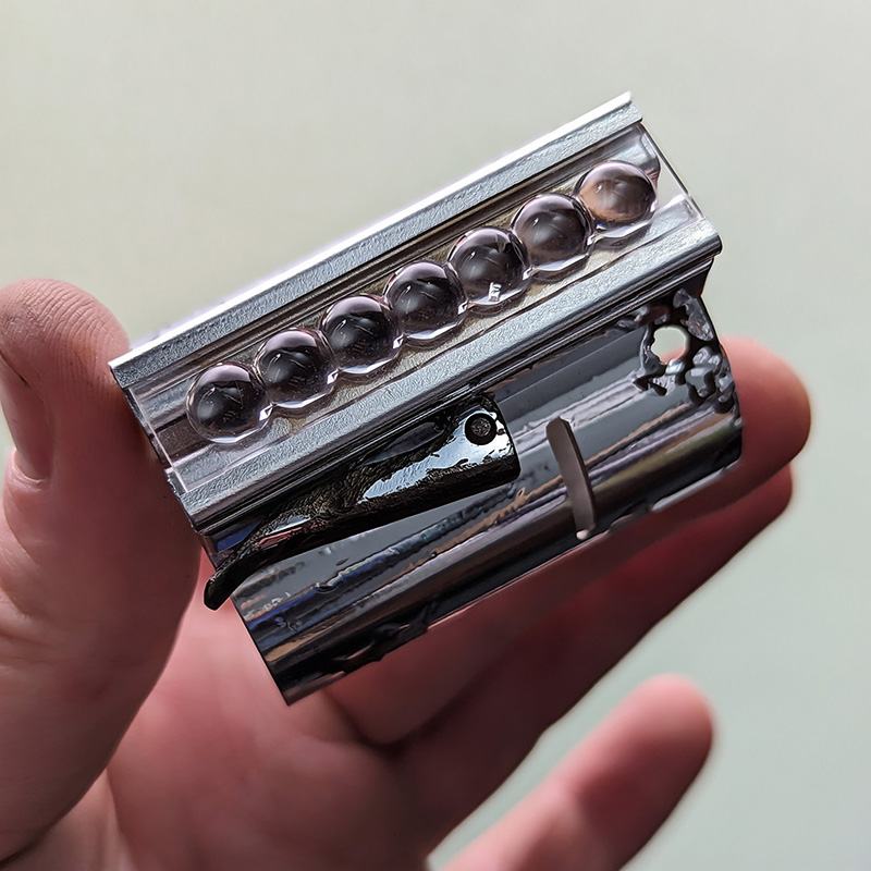

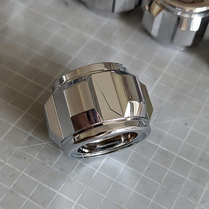

I’ve moved on to adding the damage to the weathered clamps.
This is another long process, and involves physically damaging the surface using a Dremel and engraving bit. This is the only way to get down to the underlying steel, which can then be darkened.
I was on a roll, and having the most productive day, when disaster struck!
This is the second time this year that I’ve had a Dremel die on me. The first time was a little more dramatic as it actually exploded! This time, not even a puff of smoke. It just simply stopped working, without warning. Having changed the fuse (with no luck), I decided to open it up to see if there was an obvious loose connection, or if it needed cleaning. Well, it just fell apart and I’m not at all confident that I would be able to put it back together.
Well, I immediately ordered a new one, which arrived this morning. It does mean that not all of the clamps are finished unfortunately. I did manage to get a few of them completed before my Dremel cut out on me, but I’ll need to continue with the rest of them over the weekend and possibly in to Monday to get them all finished.
Here’s one of the completed examples that I managed to get finished:
All foil is weeded and ready to apply, so it really is just the damage that needs my attention before moving on to final assembly and shipping later this week. (y)
This isn’t too much of a problem, as I had plenty of work to be getting on with on the clamps! The darkening of the brass is a relatively quick job and will only take an hour or two to darken the remaining bits and pieces once I receive my fresh supply of Birchwood Brass Black.
