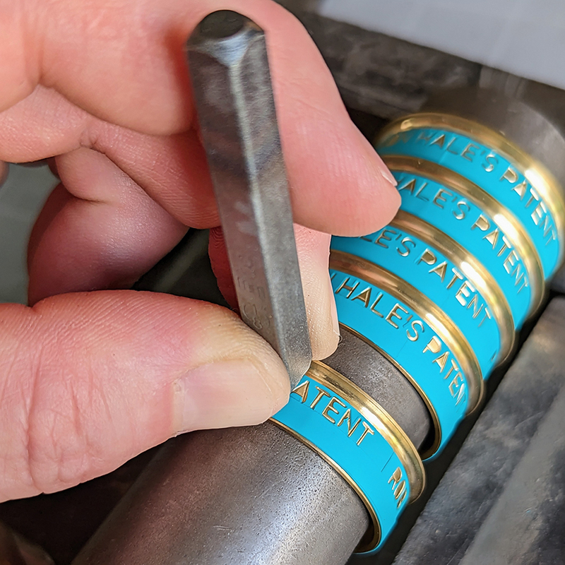

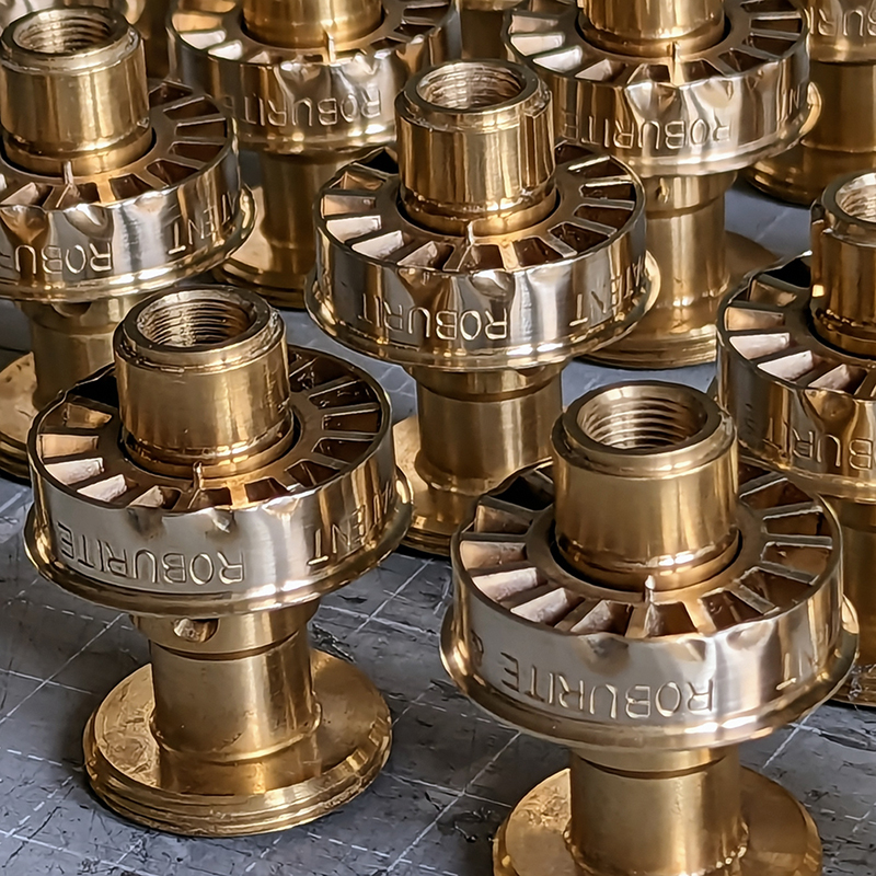

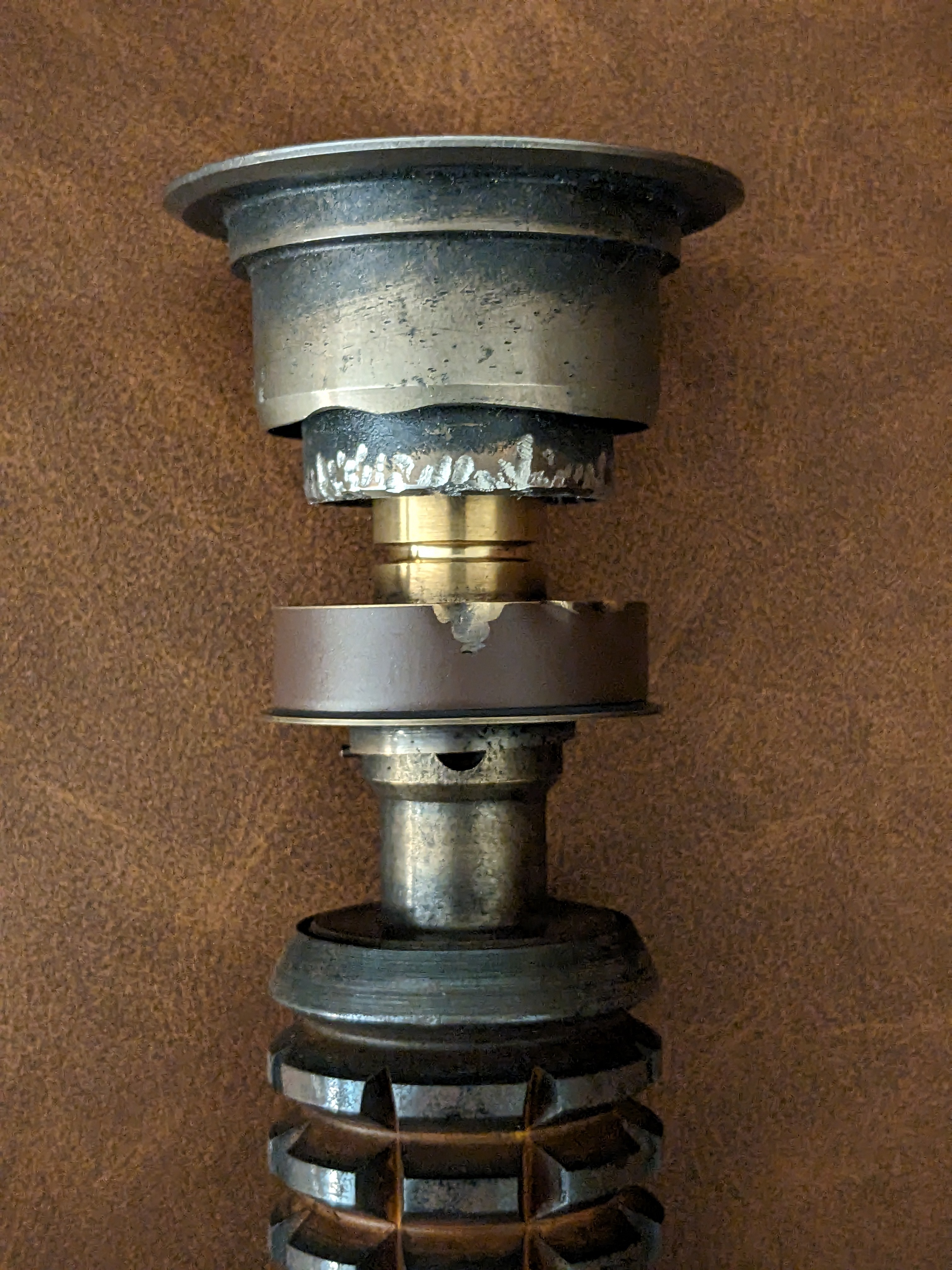

I wasn’t able to work last weekend as we were away for my daughters birthday, but it’s been a very productive week! Monday and Tuesday were spent stamping rings and installing them on to wind vanes.

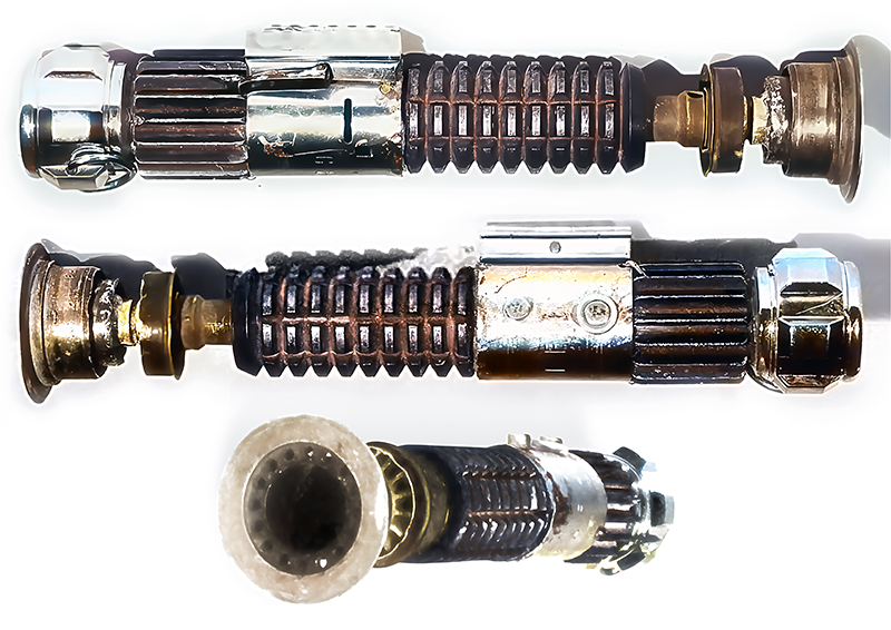

It’s important to install each wind vane correctly so that the “U” in “ROBURITE” (or “O” in “COTTON”) can be aligned to correspond with the references, along with the damage/buckling.

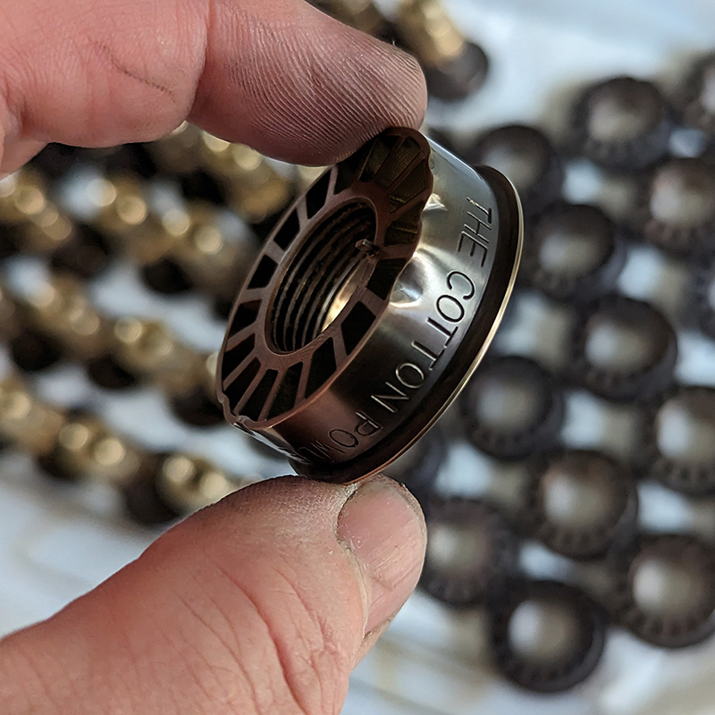

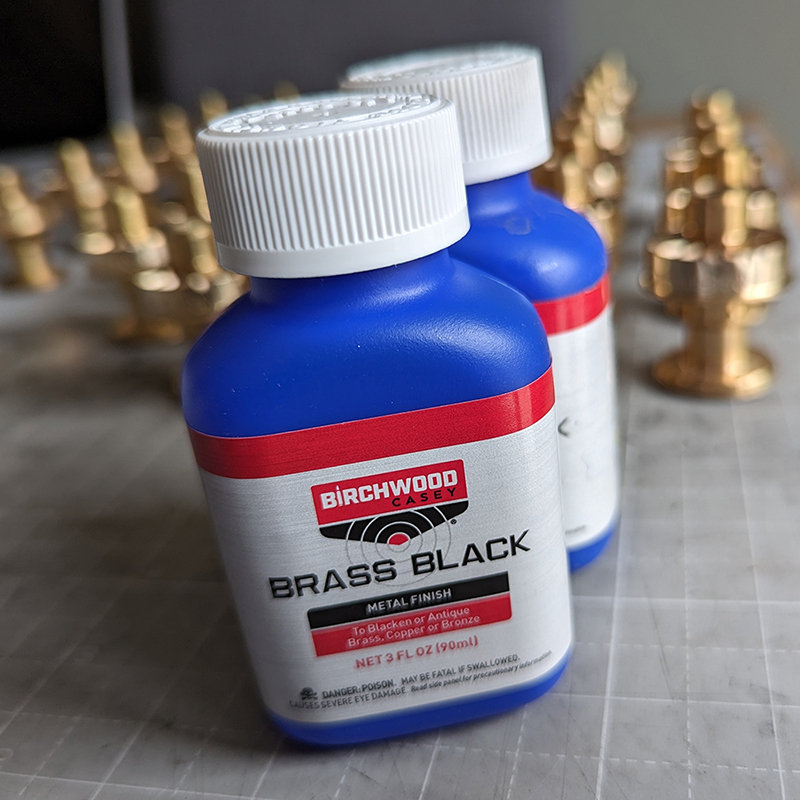

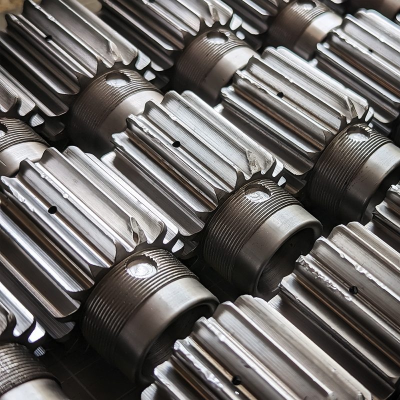

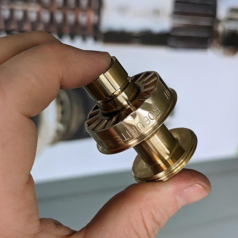

Wednesday was spent chemically darkening all of the brass parts.
This is done using Birchwood Casey Brass Black.

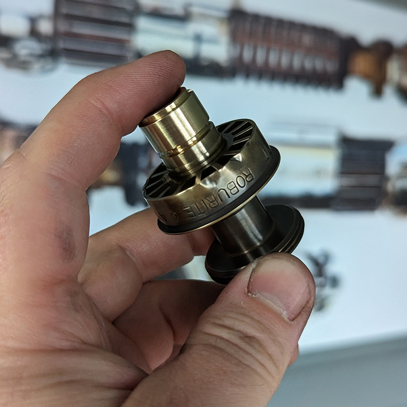

After being blackened, each piece requires some clean up. A powdery residue forms on the surface that has to be cleaned off. Once this is done, it reveals an attractive antique finish. I knock back the effect where you would expect to see the brighter brass on more exposed edges.
The top section of the neck is left as bright, untreated brass too to match the references.

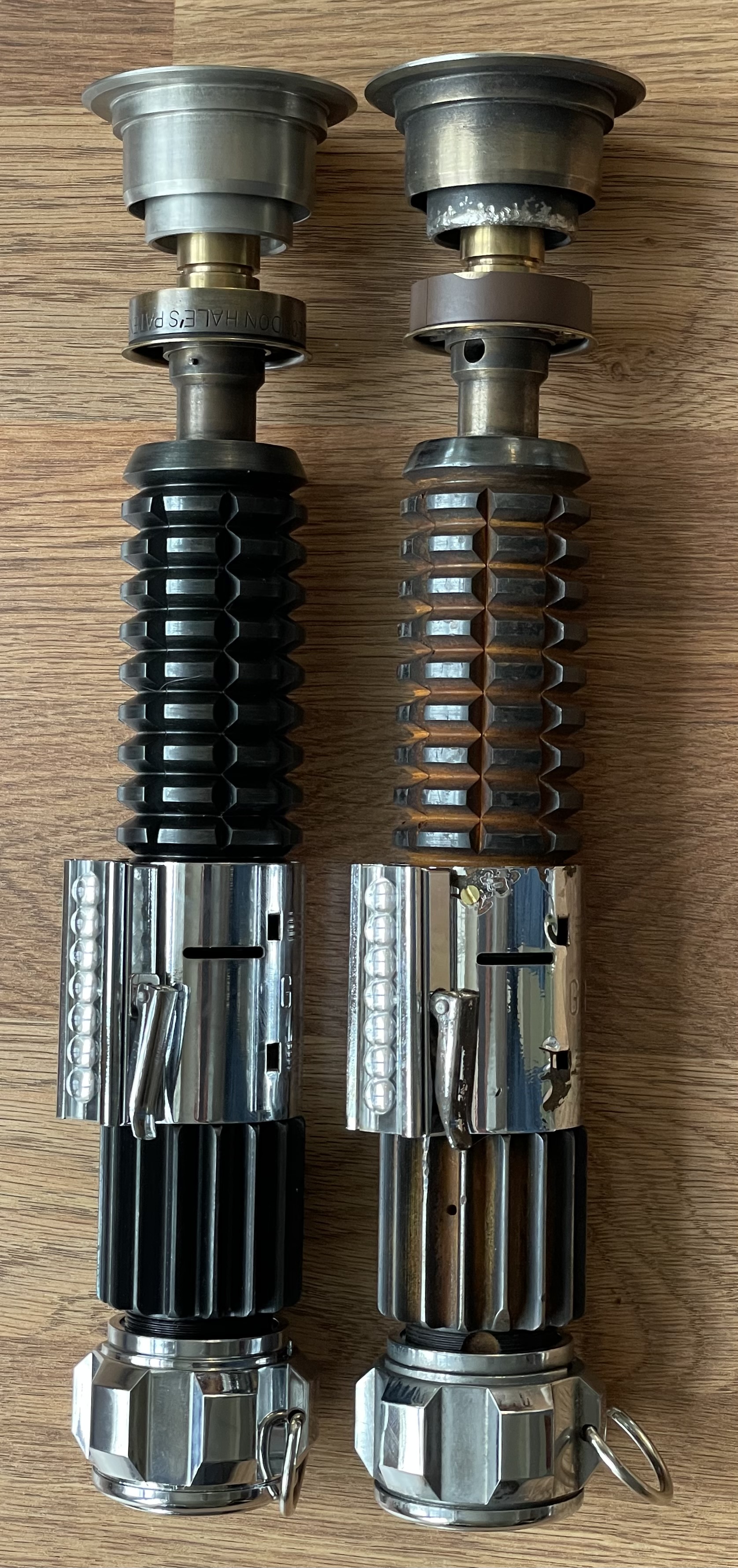

For the tape, I decided it would be a worthwhile exercise to draw up a template for the strip (including damage) and cut it on the plotter.
This will help to maintain consistency, as well as saving me a heap of work.
All grenades for Batch One are now 100% finished and waiting on final assembly!

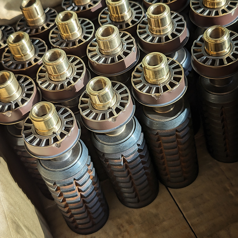

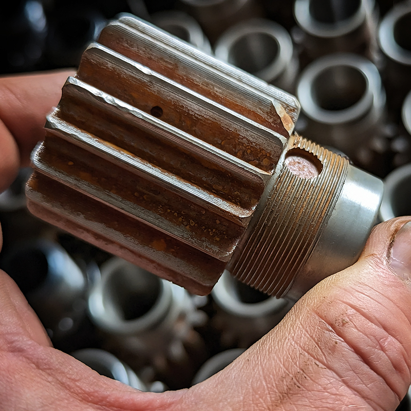

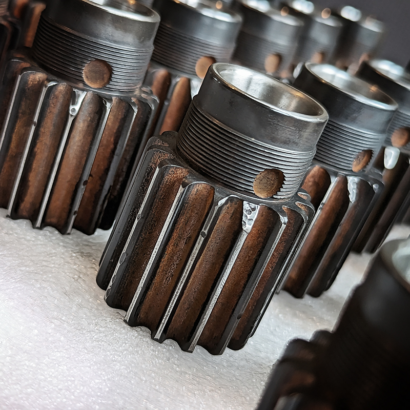

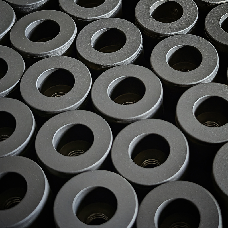

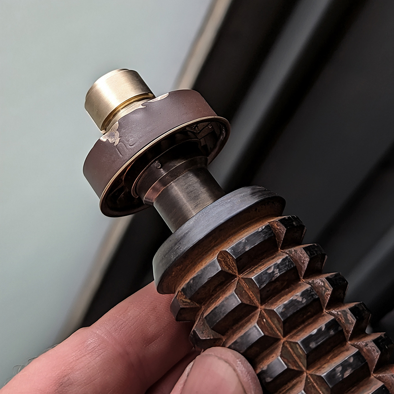

I spent Thursday and Friday concentrating on the Boosters/Spacers.
Spacers have now been Chemically blackened. The last few of these didn’t take as well as I’d like however, which means that the last of my blacking solution has lost it’s potency. I’ve ordered some more to arrive next week to blacken the boosters.
This hasn’t held me up at all. The grenades are almost (but not quite) ready for blacking. They have had their damage applied, and I’ve added some natural rust to the fin/groove sections.
This is the same process as the grenade sections. The rust will be cleaned off everywhere except for the grooves prior to blacking. The rust acts as a barrier to the solution and will result in a blackened booster with rust deposits in the grooves. The edges of the fins will then be highlighted as seen on the original prop:
Picking back up on Monday, I’ll get the boosters cleaned up ready for the arrival of my fresh chemicals. This is now the very last job aside from final assembly, so when I say that the finish line is in sight for this batch, It really is, and I expect them to ship sometime next week.

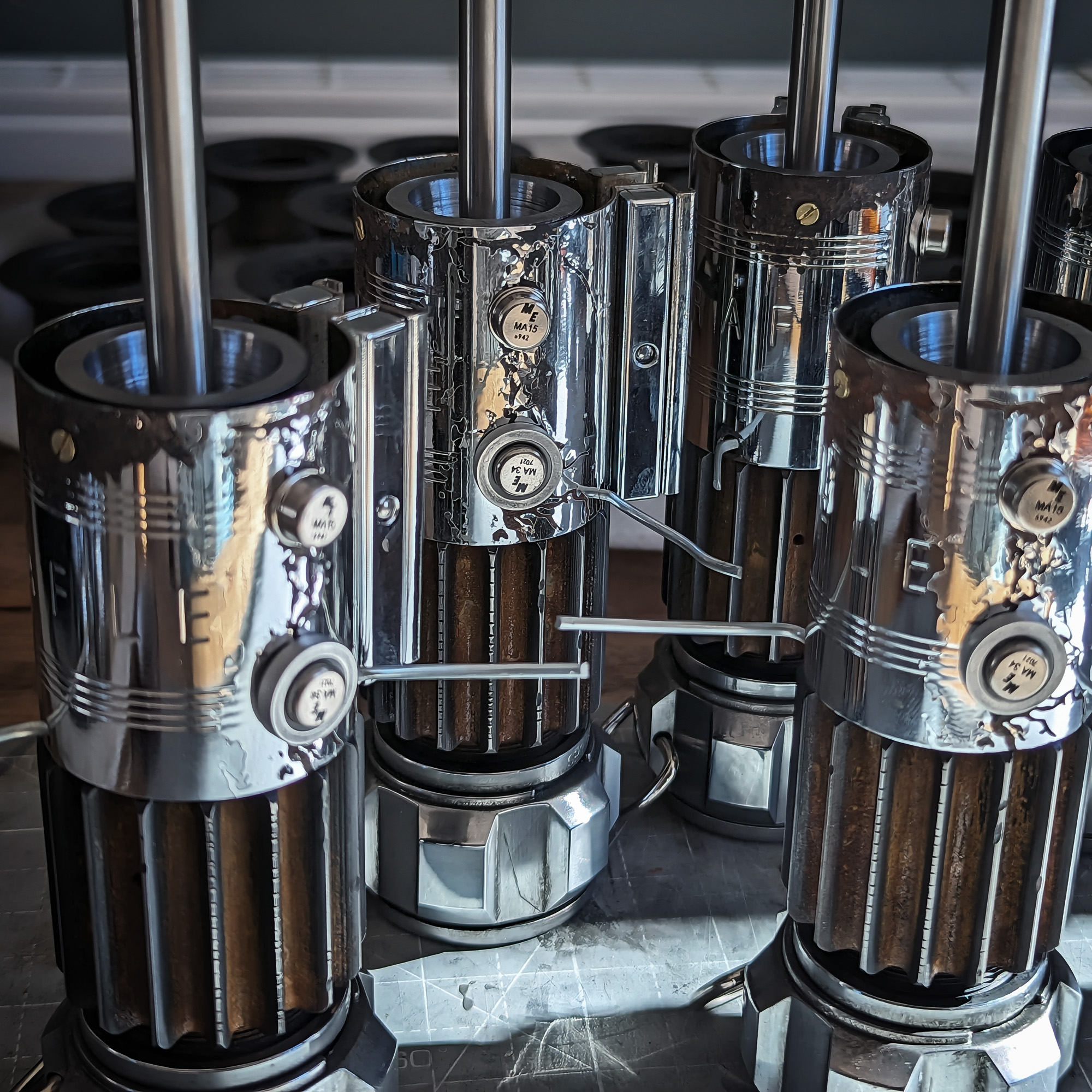

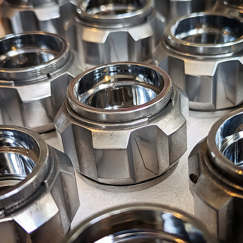

This week was spent weathering the handwheels and boosters. As I was waiting on blacking solution to finish the boosters/spacers, I started the week weathering the pommels.
This started out by adding the scratches to each of the fully weathered pommels.
Once all of the scratches had been done, I added some light scuffing to the surfaces as well as some subtle build up of grime.
I LOVE weathering powder for this sort of thing, but in this case it would have required a clear coat of some sort (something I'm not fond of at all). So, instead of weathering powder, I've opted for oil paints for this one. I've found that the rather appropriately named "star ship filth" by Abteilung is PERFECT for dirtying up parts. I generally go on very heavy, and then clean off with cotton pads, leaving the built up filth in any hard to reach places.

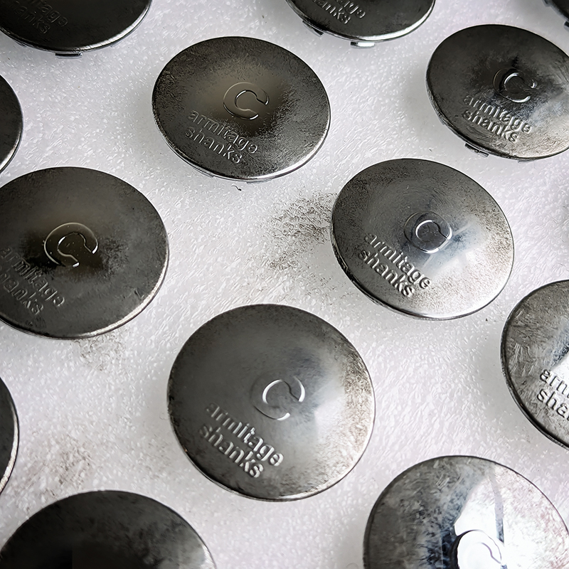

Although I choose to leave the cap off my personal build, I've gone ahead and added some dirt to the edges of the cap too.
It's hard to get an accurate representation of how these look in person due to their reflective properties (the bane of my life). They really do look pretty cool in person though. It's subtle, but looks authentic. They really do look like genuinely old/used handwheels which is what I was going for. If anything, the actual effect is a lot subtler in person.
I've not installed the caps at this stage as this is the very last thing to do once everything is assembled on to the coach bolt.

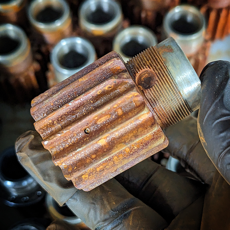

The blacking solution arrived on Thursday and the latter part of the week was spent finishing boosters!

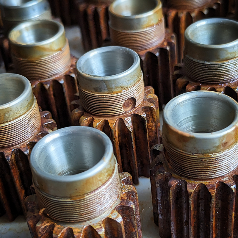

They were all still in a fully rusted state from last week and needed to have the rust removed from everywhere except the grooves.
Once they'd been cleaned up sufficiently, they were dipped in the blacking solution.
The rust acts as a barrier to the solution and so remains, whilst the areas that are cleaned up are affected by the chemicals.
The black oxide was then removed from the appropriate areas and the edges of the fins were highlighted, before dewatering oil was applied to prevent any further rusting.
I'm really happy with how these have turned out and can't wait to see them alongside the other parts as I begin to assemble the finished hilts!

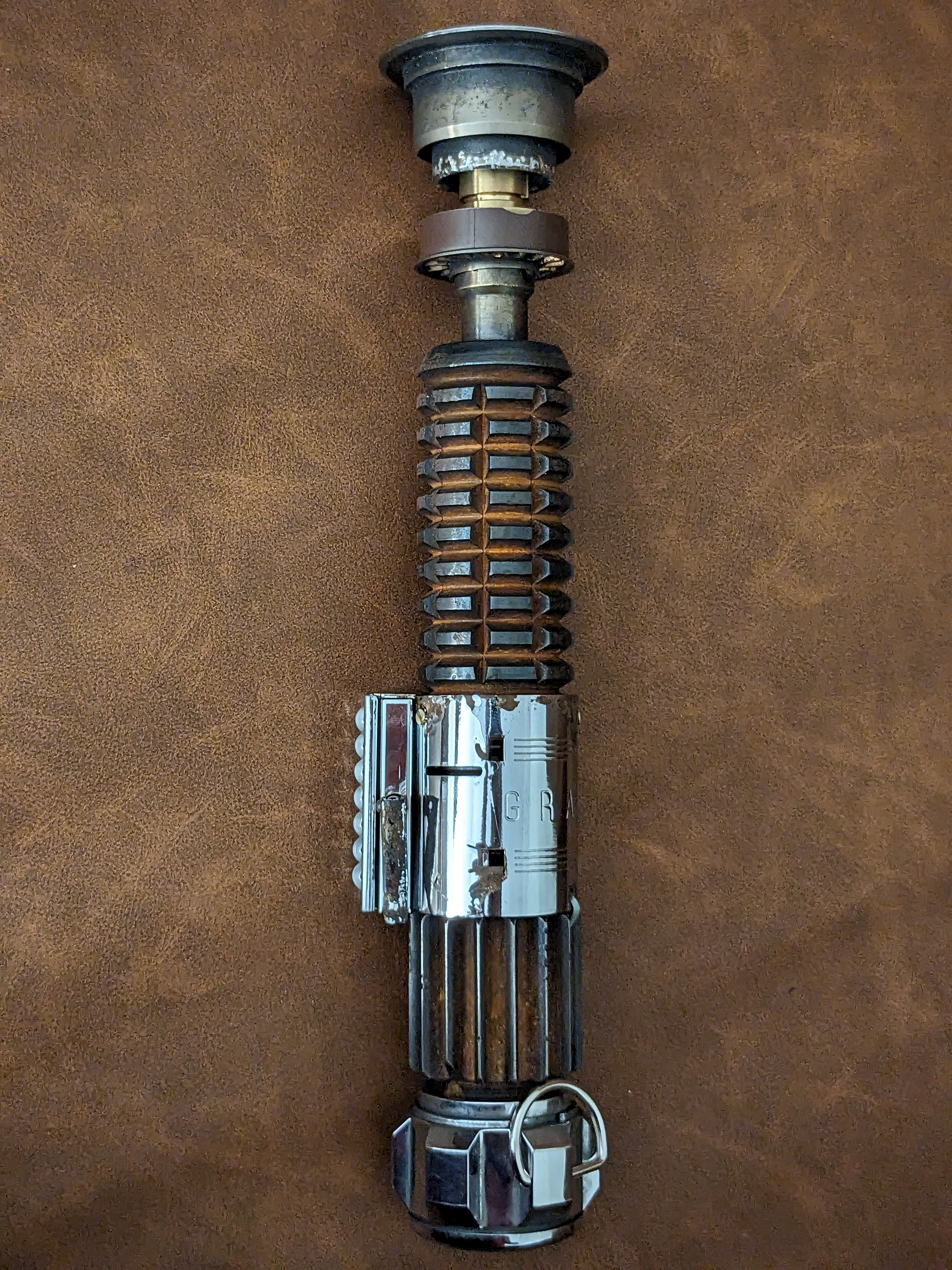

**UPDATE**
**The first transport is away!**

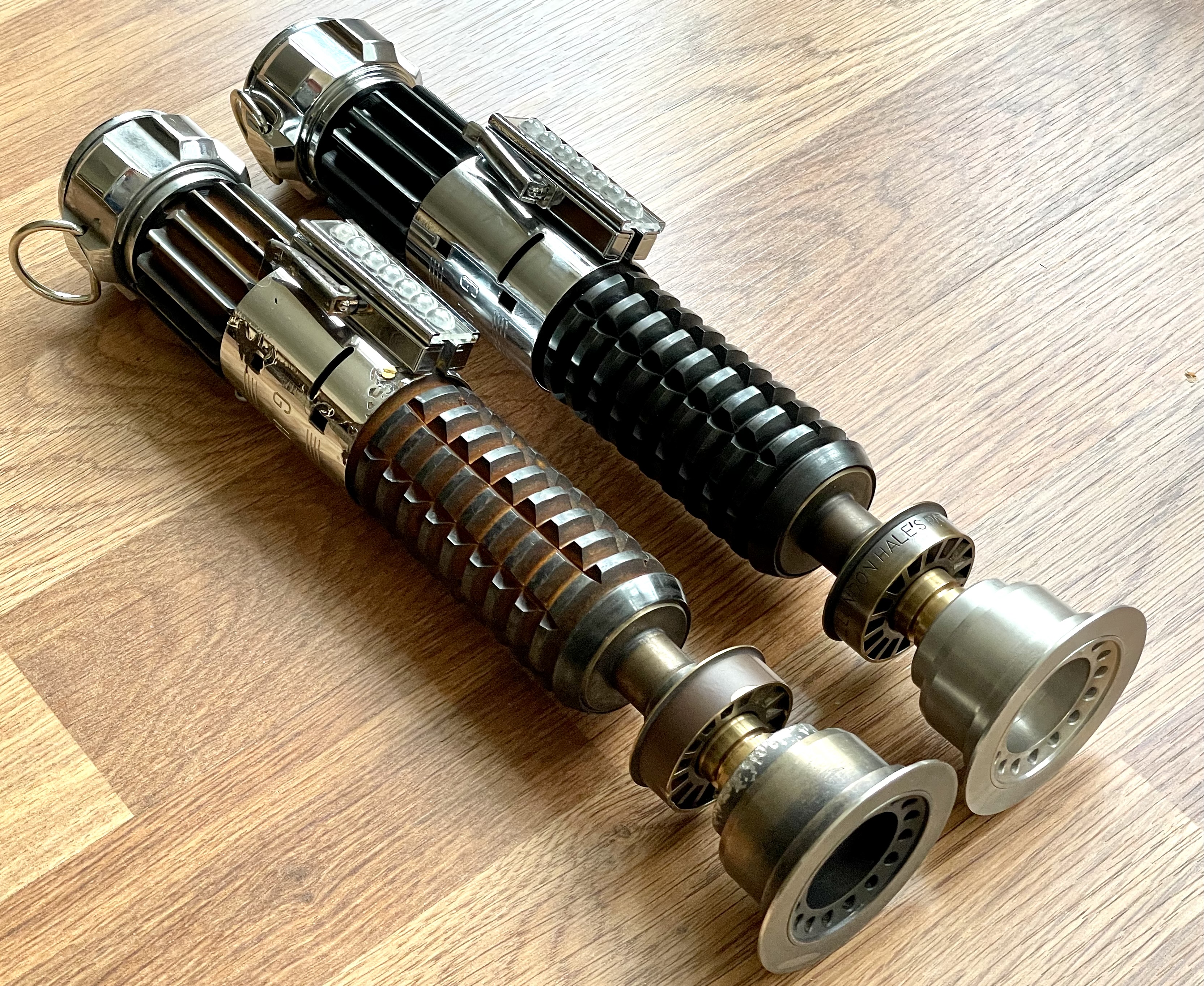

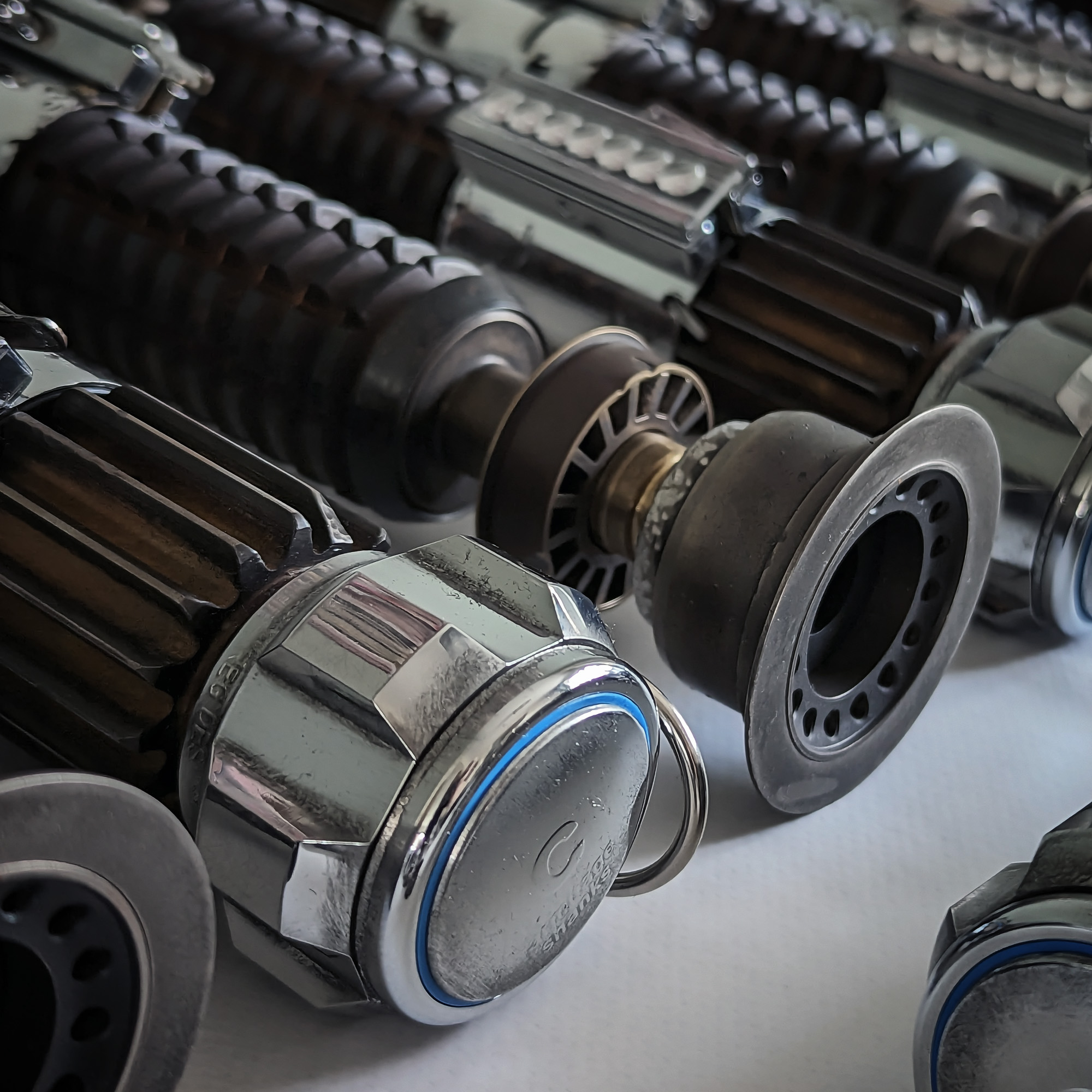

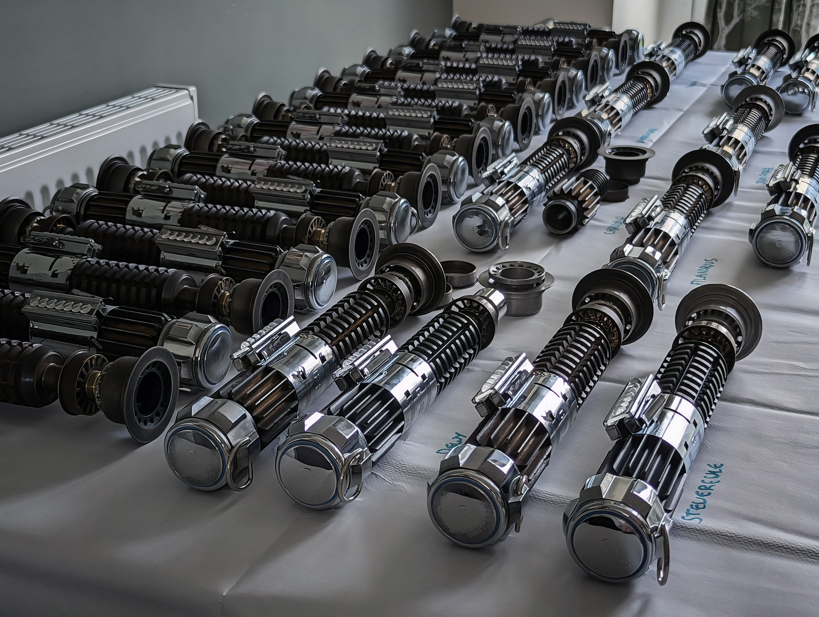

Batch one is done, and sent!
Assembly, packing, and shipping was a big job in itself, but I'm happy to report that all paid up batch one orders are now on their way to their new homes! :eek:
Here are some pictures from this past week:
