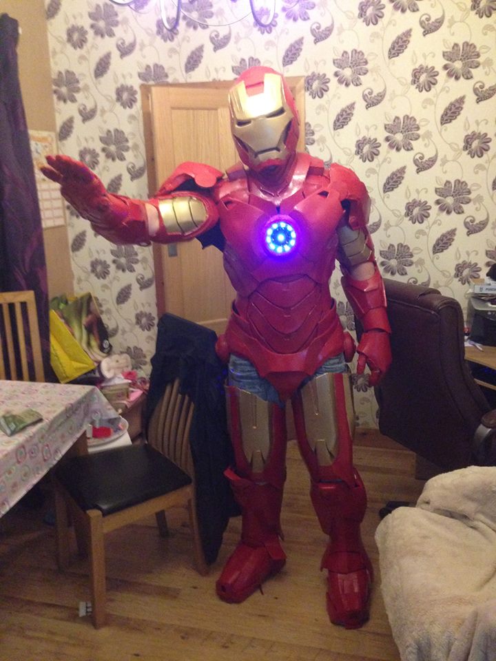

Pretty much finished my build today, got some weathering to add, lights to the hands and the gold parts on the abs (going to do that with a fine brush) and an undersuit to purchase and then I'm all finished.
I know the red isn't an accurate red but for my first build and what it is I wasn't overly worried about screen accurate colours.

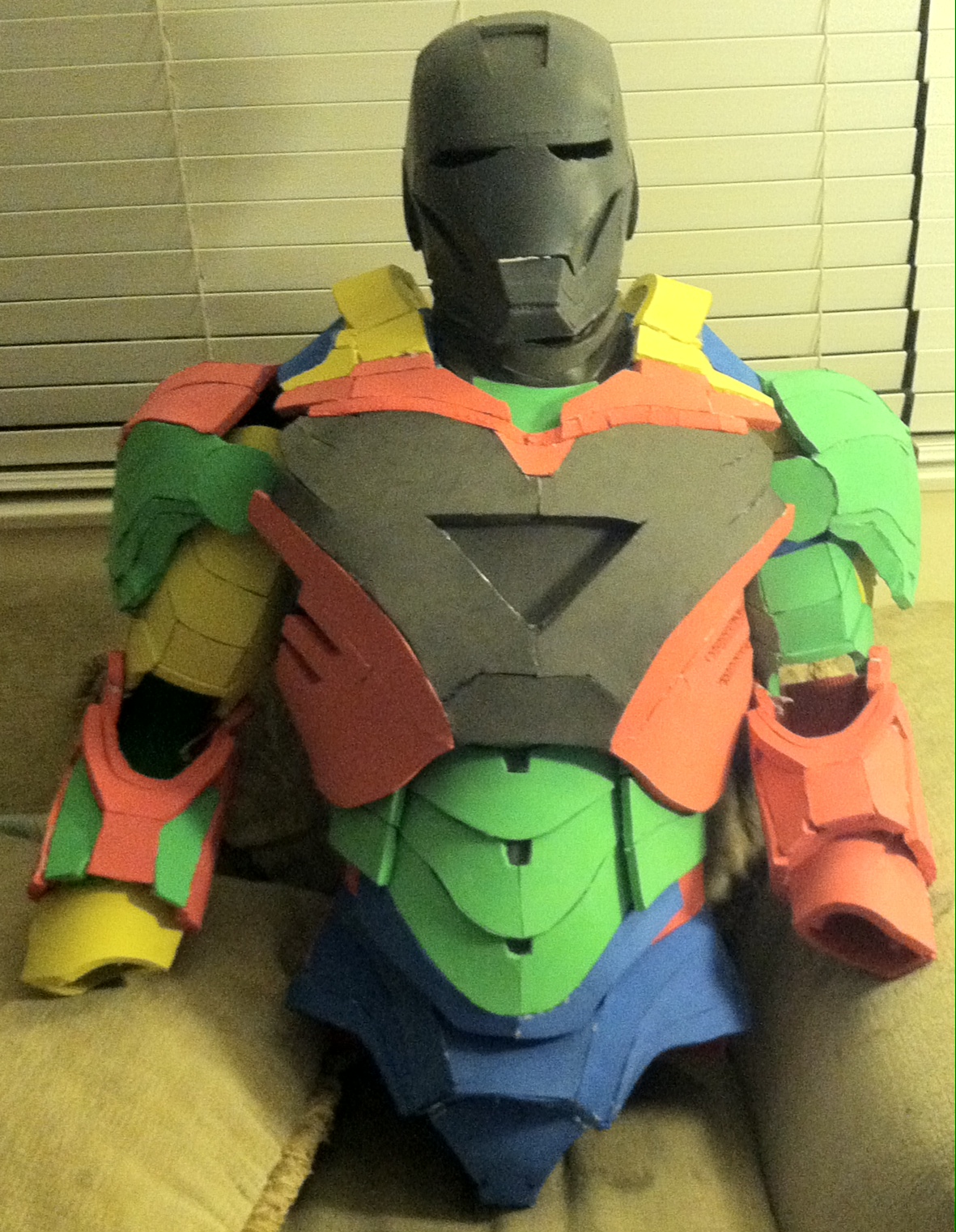

Hi all,
I just wanna say thank you to Stealth, Robo, jowe, MrBibou, demolition, etc for all this brilliant work, you guys have converted me.
This is my first attempt at any costuming.
This is what I've done so far
Re: IRON MAN Mark 4/6 Pepakura FOAM Templates
Hi all,
wow first try really!!! your are a natural bro keep up the good work
