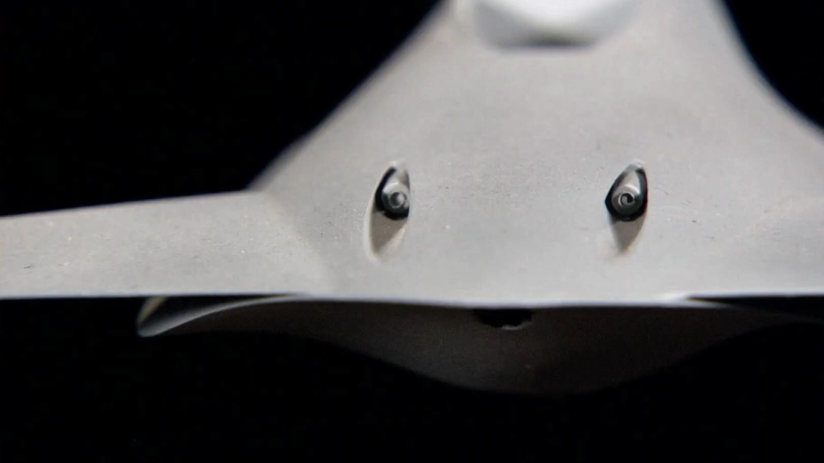

Let's take the Naboo fighter for instance. George would talk about what it wanted to generally look like, what it did and how it should "feel". Then Doug and/or other artists would draw sketches to flesh out the design. Mostly the drawings were simple sketches, sometimes with close-up sketches of critical detail areas. Once the drawings were approved by George, they were handed off to me to do a quick, rough, small model in foam and cardboard. After the rough models were approved, I would make the finished model. But even then the design might keep evolving.
The wooden model was approved and then got molded, but then Doug wanted the wings and engines blending in with fillets - so I added that to a casting, and then that one was remolded.
It was a very collaborative process. There was a lot of back and forth, asking questions, approvals and changes. The Naboo fighter originally had a torpedo pod mounted on a fin above the cockpit, and that element had survived through all the drawings. But once George saw it in-the-flesh he didn't like it, and snapped it off the model to see what it looked like without it. As an concept artist, you can't be precious about your work. We were building these toys for him, and if he wanted to break it - well, it was his toy.

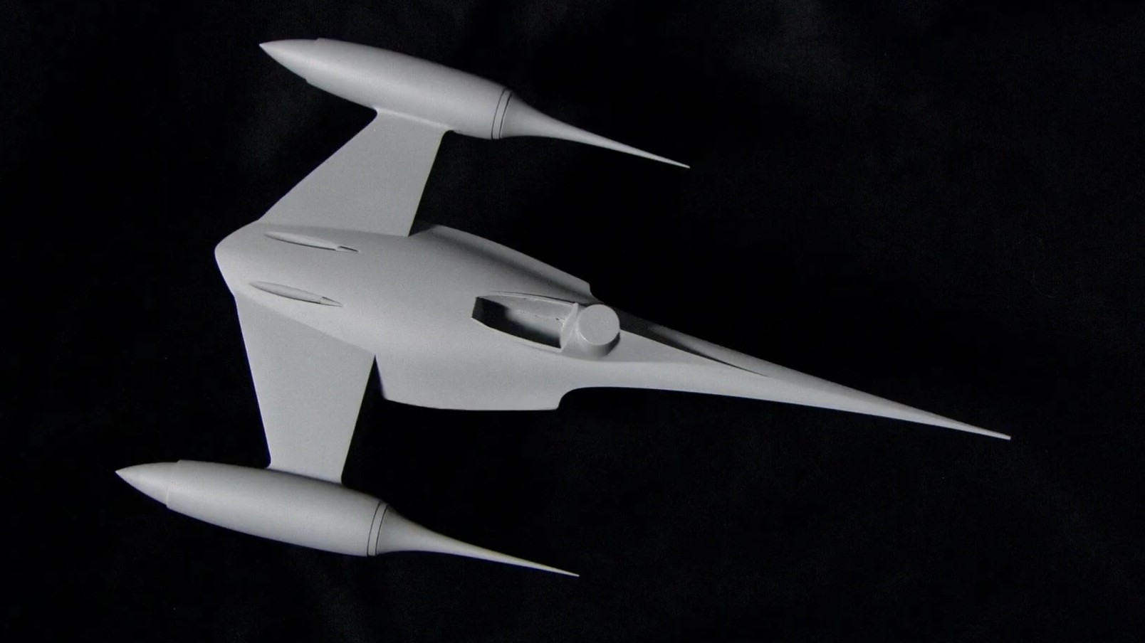

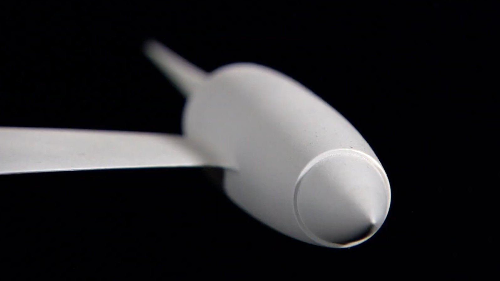

I found some close ups of the concept maquette, looks to be an early casting as it's before the blended wings or cockpit were added, as well as a higher quality version of the turntable. I've added them to the intro post and Google Photos album (linked in the intro post), and I replaced the old turntable with this one.
