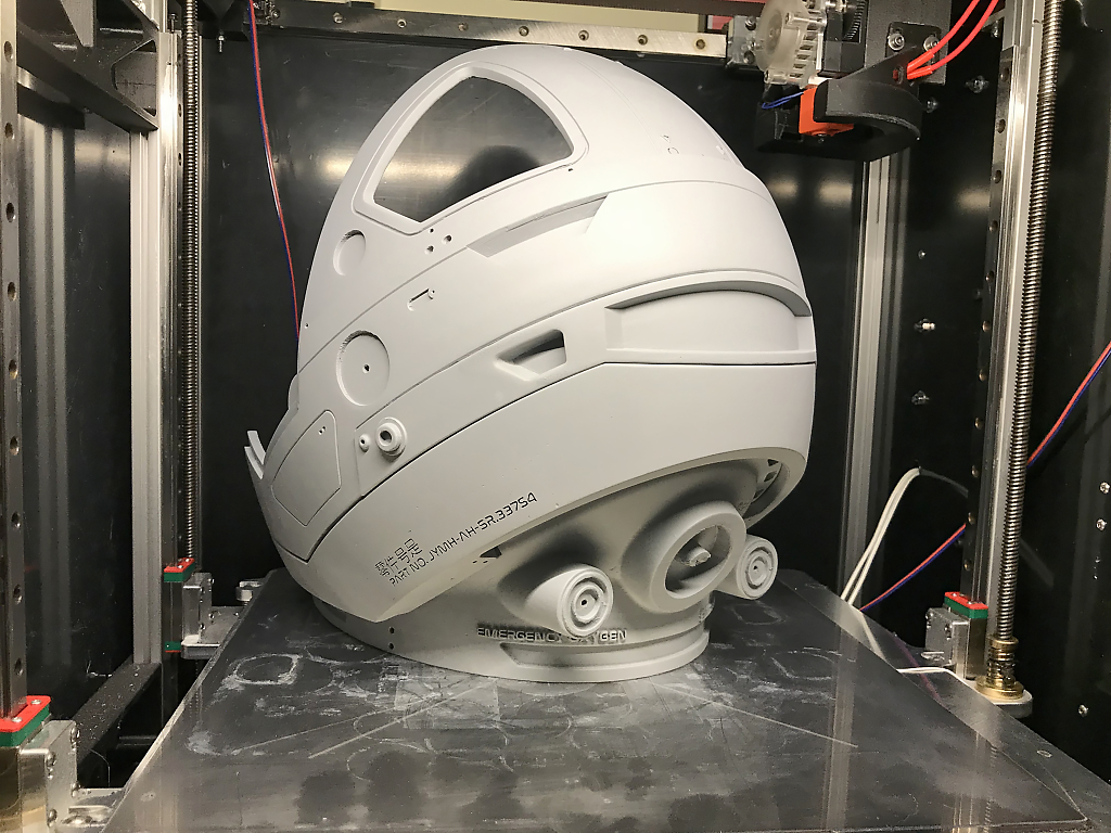

Exchanged the emergency text as well with parts printed with a 0.2mm nozzle at 0.05mm layer height.
1024088
1024089

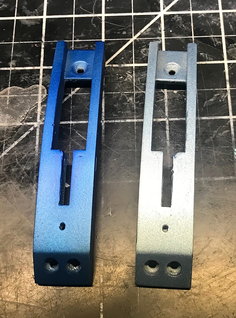

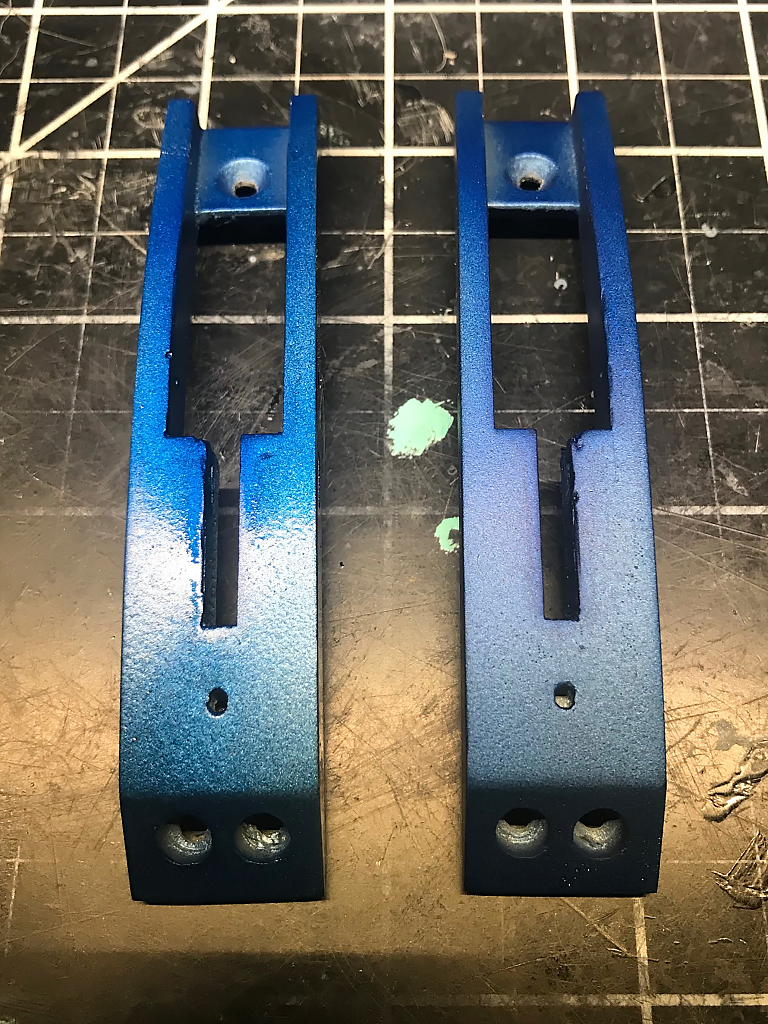

Working out the blue for the bottom part and clamps that I like. The foundation on primer is Turbo Dork blue steel (I hate 0.67oz bottles, now I have to wait for more), Layers of Alclad transparent blue ALC-403, transparent smoke ALC-405 and Aqua gloss clear ( I love the Alclad stuff). Last picture clamp on the left is the final result. Maybe less blue more smoke but this is close to what I want.
