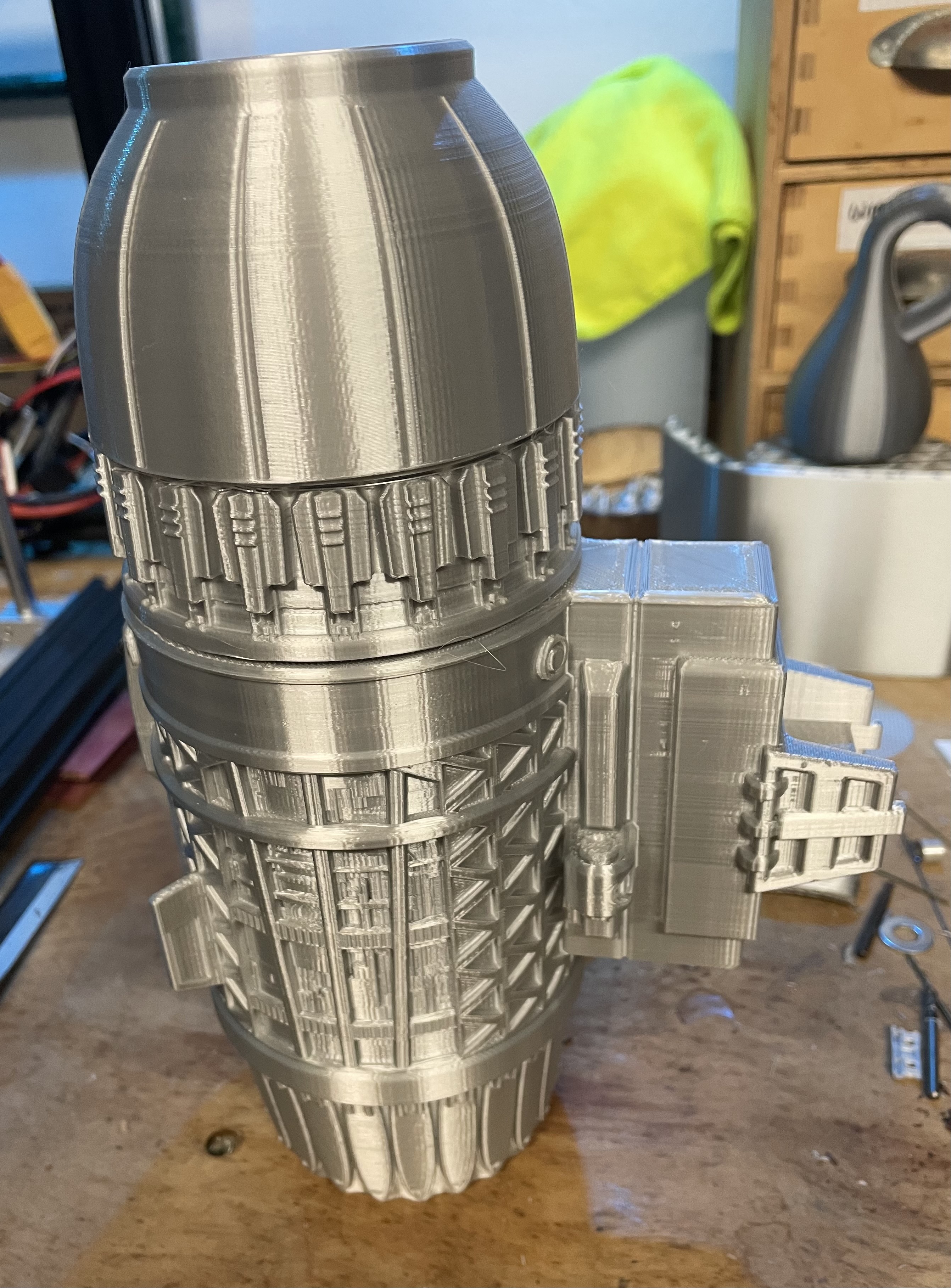

The next stage begins with the two main thrusters and wings which attach directly to the main body. The original designer of the STL files provided wire channels for the LED lighting effects which were installed after printing but before final assembly. For once, I was thinking ahead.

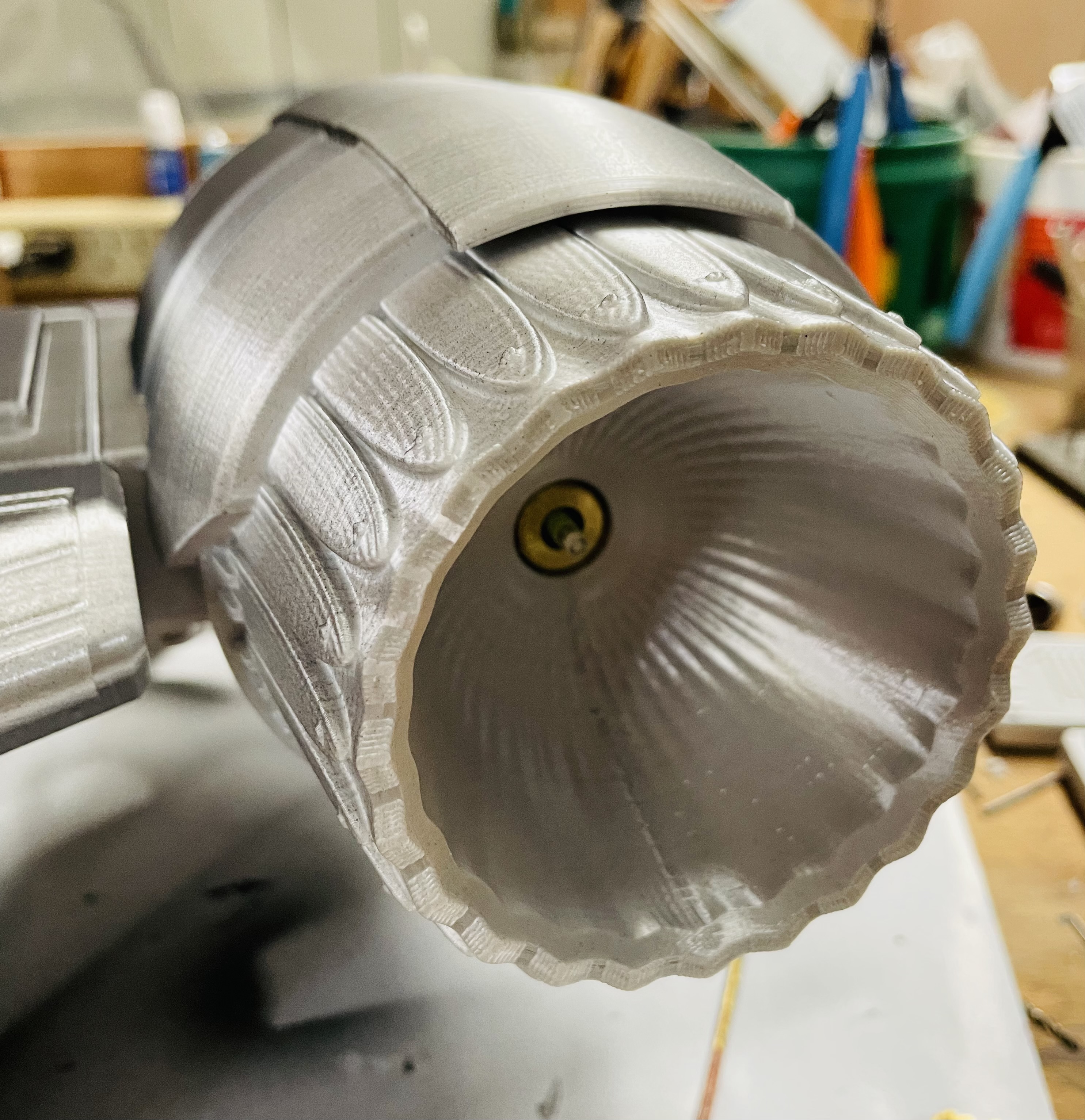

The engines and most of the model were printed using a silver silk filament which gives the illusion that they are made out of aluminum. This would be a big advantage when it came time to start painting. The overall quality of the prints are really pretty decent. I opted for 5mm LEDs wired to a controller that simulates a pulsing effect. Evans Designs provided all of the lighting and wiring materials. They are a great resource IMHO.
Once the two main engines were outfitted with LEDs, they were mounted on the wings and then test fit to the main body of the Serenity. Fitment was excellent. I then focused on printing the "cradle" that surrounds the base of the ship's "abdomen" and then the abdomen base itself. One word of caution... I found out the hard way that the cradle should NOT be glued together until final assembly of the ship. More on this later.

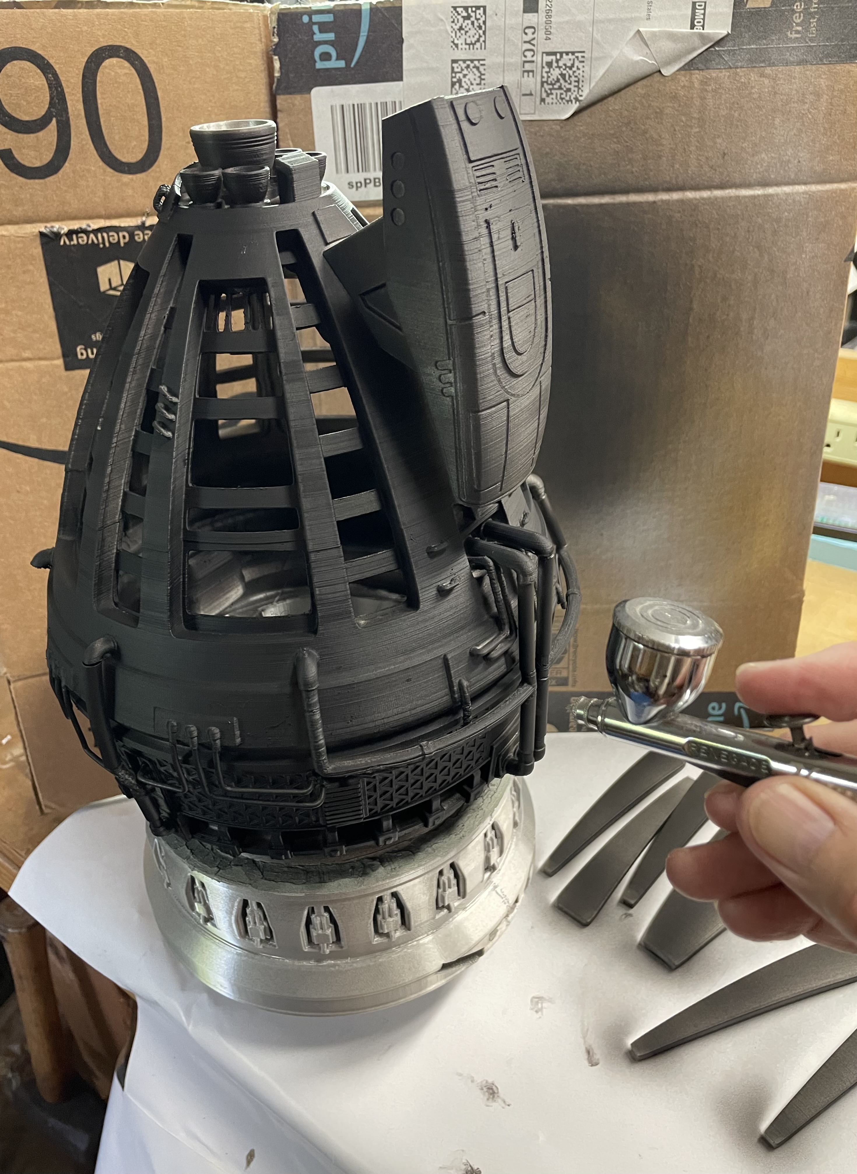

The detail on the abdomen of the Serenity was really pretty impressive and the designer of the STL files gave me several options in terms of what style of louvers to use and whether to have open or closed vents. Unfortunately, this abundance of surface features like fuel conduits, pipes and tubes created a real mess for my printing skills (or lack thereof). To make matters worse, my Ender 5 started having control board issues and the print quality really plummeted. As a result, many of these aforementioned, unsupported features were removed from the print or were badly reproduced and virtually unusable.
I decided to shave many of the tubes, conduits etc and reproduce them using Evergreen tubing, heat shrink tubing and various diameters of solder.
After several hours, much of the detail was restored or at least cleaned up to a point where I could feel good about moving on to the next step in the build. Once finished, any stringing or uneven surfaces were filled and everything received several coats of Vallejo flat black primer.

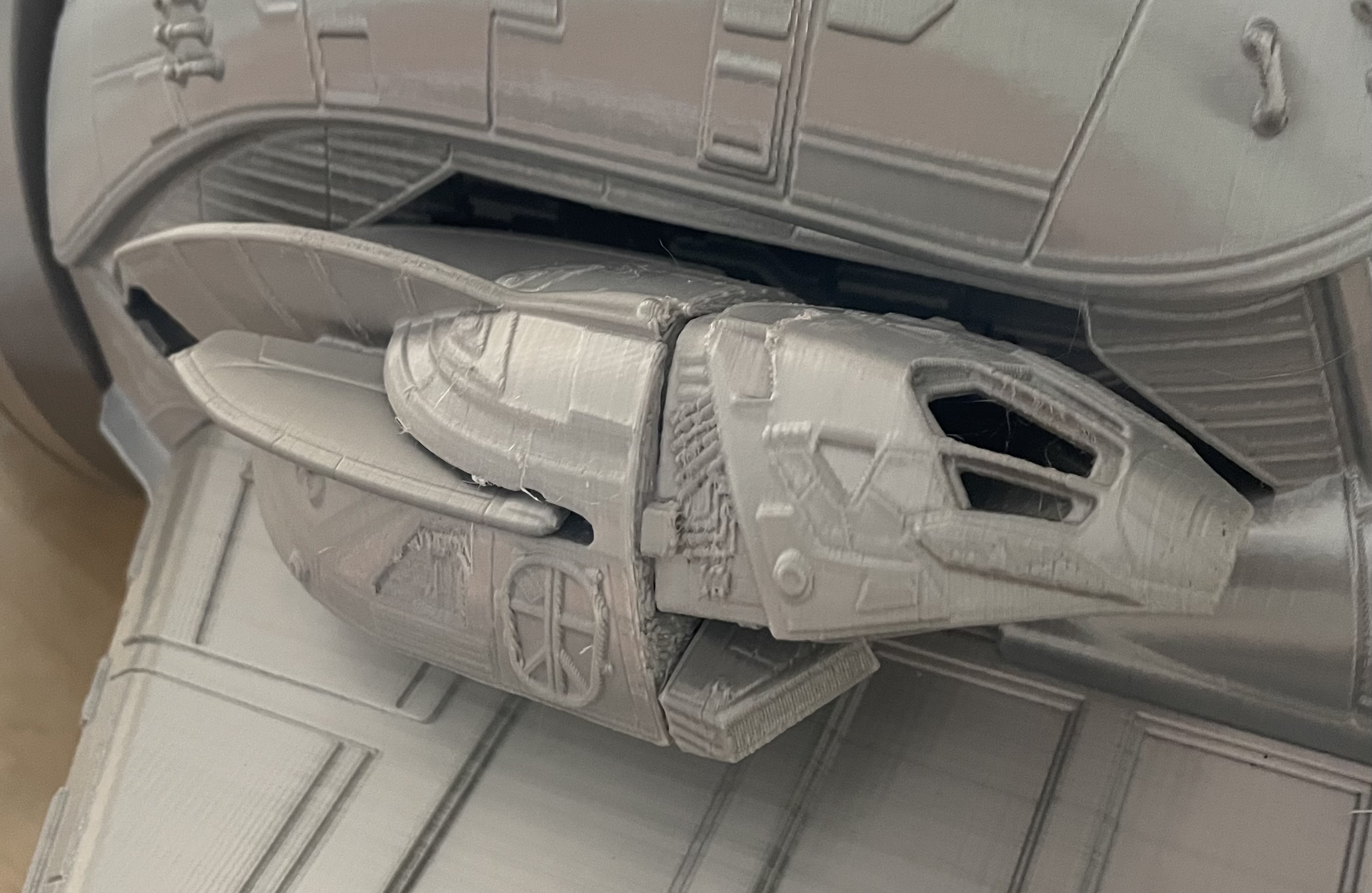

At this point, I decided to add two versions of the shuttle craft- one in the take off position and the other with it's wings fold but clearly visible inside the main body. I downscaled and resliced another Gambody offering, added flat black primer and dusted them with a light coat of steel paint. I embedded a piece of brass tubing in the seam of the wing, and drilled out the flying shuttle. This feature can easily be removed and reinstalled if needed.

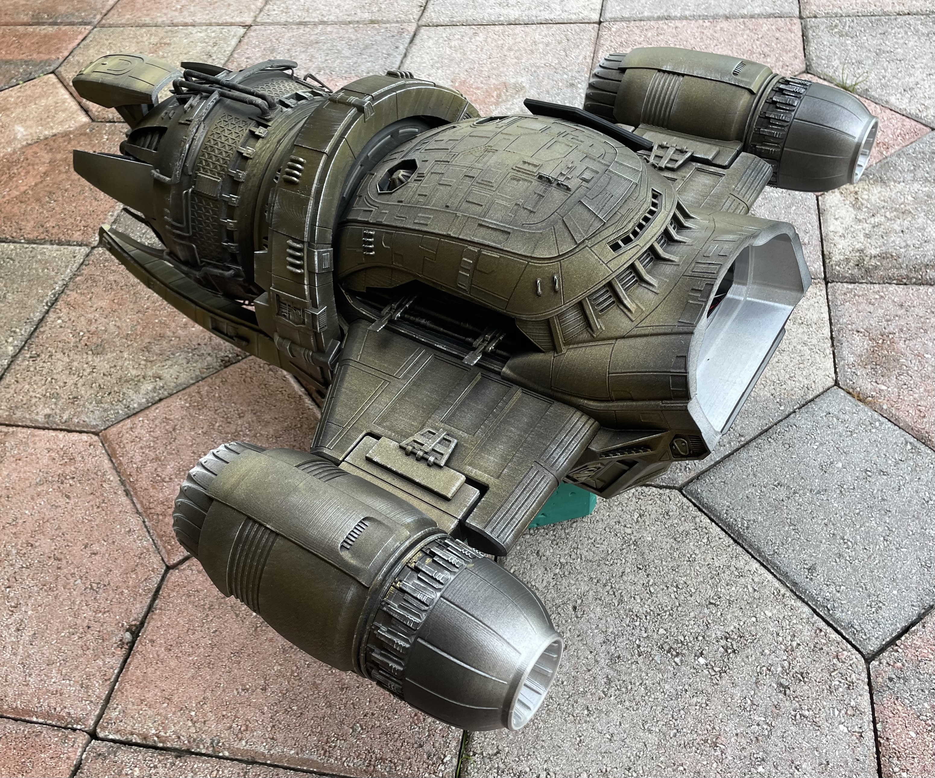

Final assembly is all but complete and final paint is about 90 percent complete as well. I have seen several versions of the Serenity online including movie/series clips from various sources but have to admit that I took some artistic license on my final choice of paint color. Most examples show the hull with a bare steel finish but I wanted something with more contrast. I applied Vallejo flat black to the entire spacecraft followed by a very light misting (believe it or not) of Vallejo metallic bronze. Some areas were left unpainted due to the aforementioned use of metallic silk PLA. I have also added the louvers to the abdomen in the open position and begun placement of the solar panels. The abdomen and upper fuselage are removable as previously mentioned. Please let me know what you think of the paint scheme.

I followed up with lots of dry brushing using Vallejo aluminium and flat black once again. The main engine nacelles will be painted a very light misting of transparent metallic blue and the rear thrusters will be dry brushed with smoke and gunmetal grey. Window panels were added to the cockpit as well.
WOW AMAZINF STELLAR!!! I have always wanted the Serenity like this for display etc etc. Thanks for sharing all the pics of your project. Tis Shiny Cap'n!!
