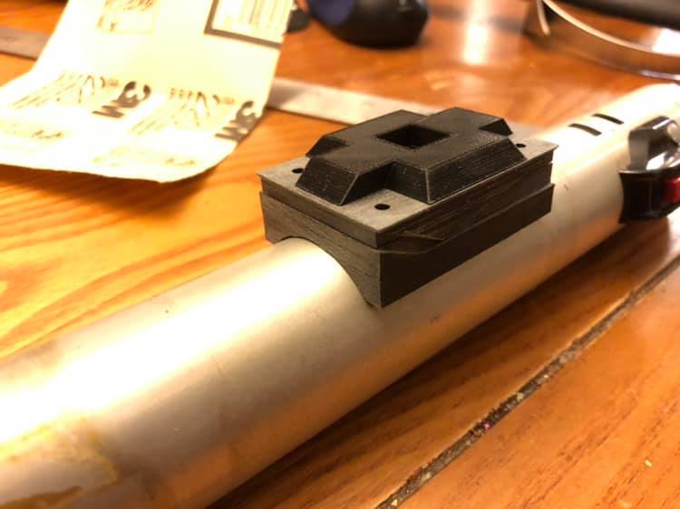

Here we have Dann 's V7 control box, mostly sanded and ready for paint. The radius is spot on. Very pleased with this so far, and very grateful to you, Dann, for sharing this file.

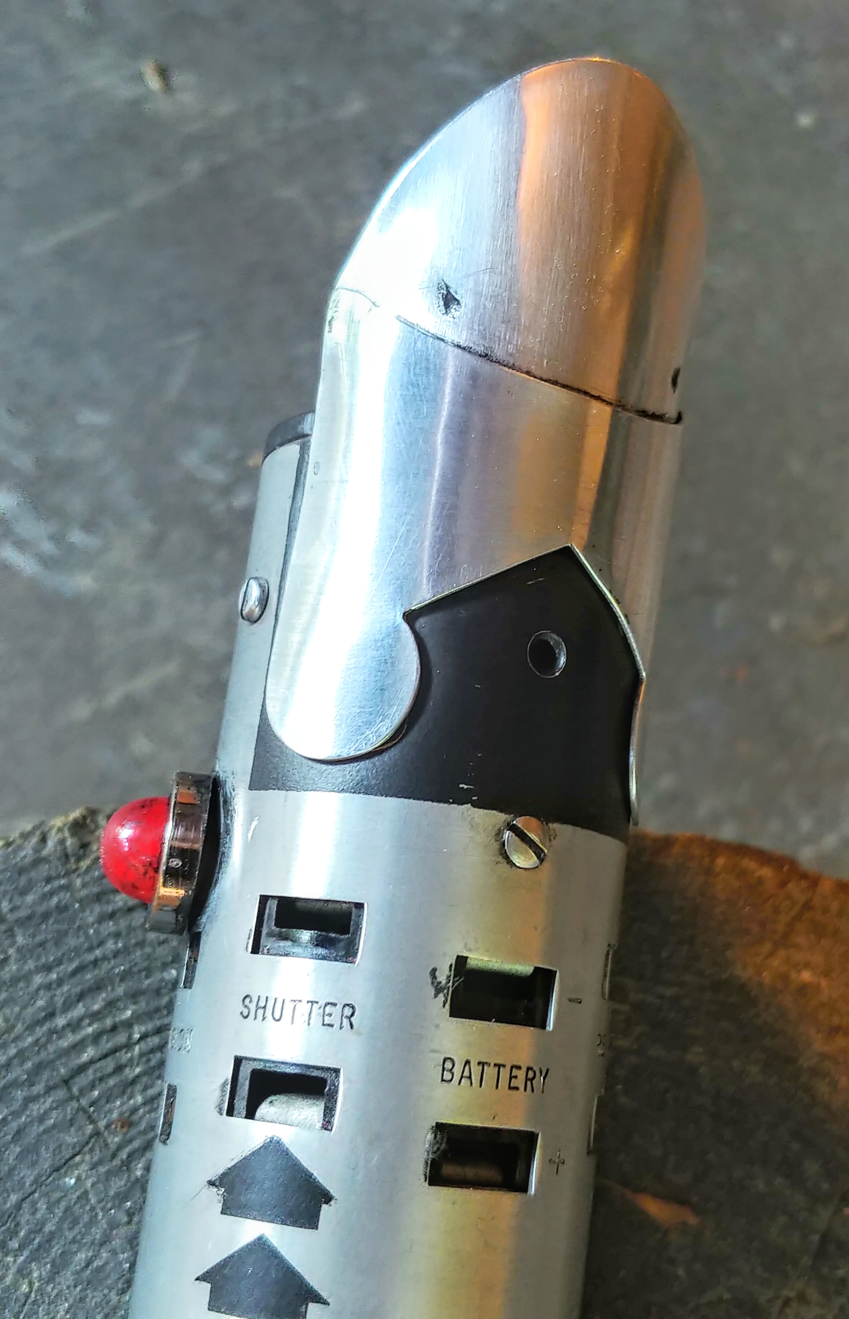

Also, the red lights came! Now all I need is gaffer tape and T-track and I can start in earnest.

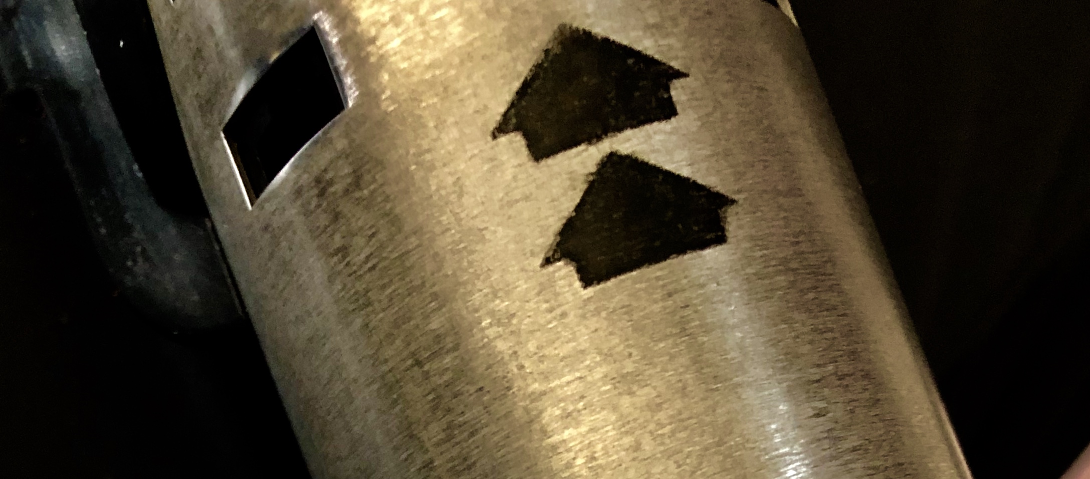

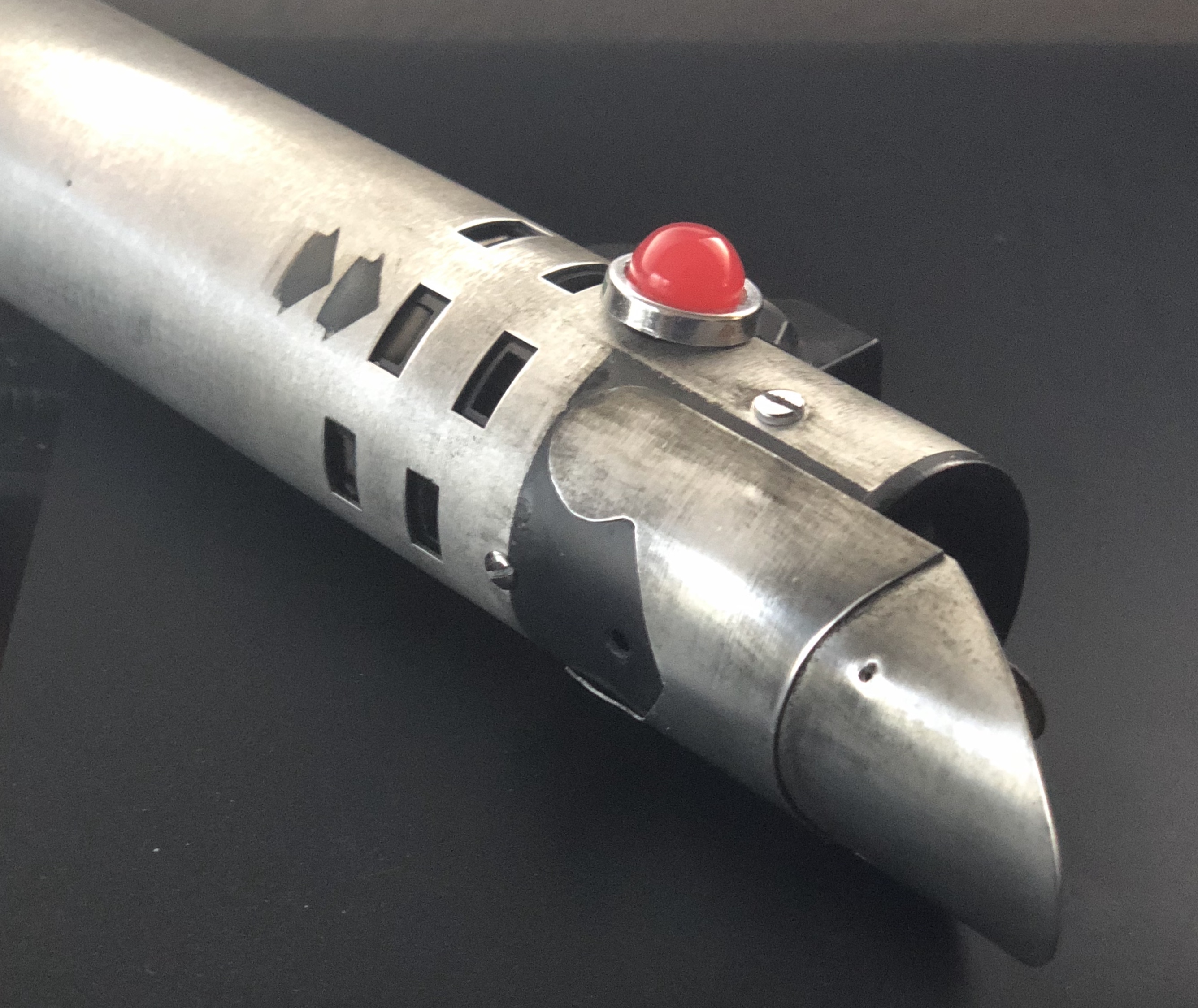

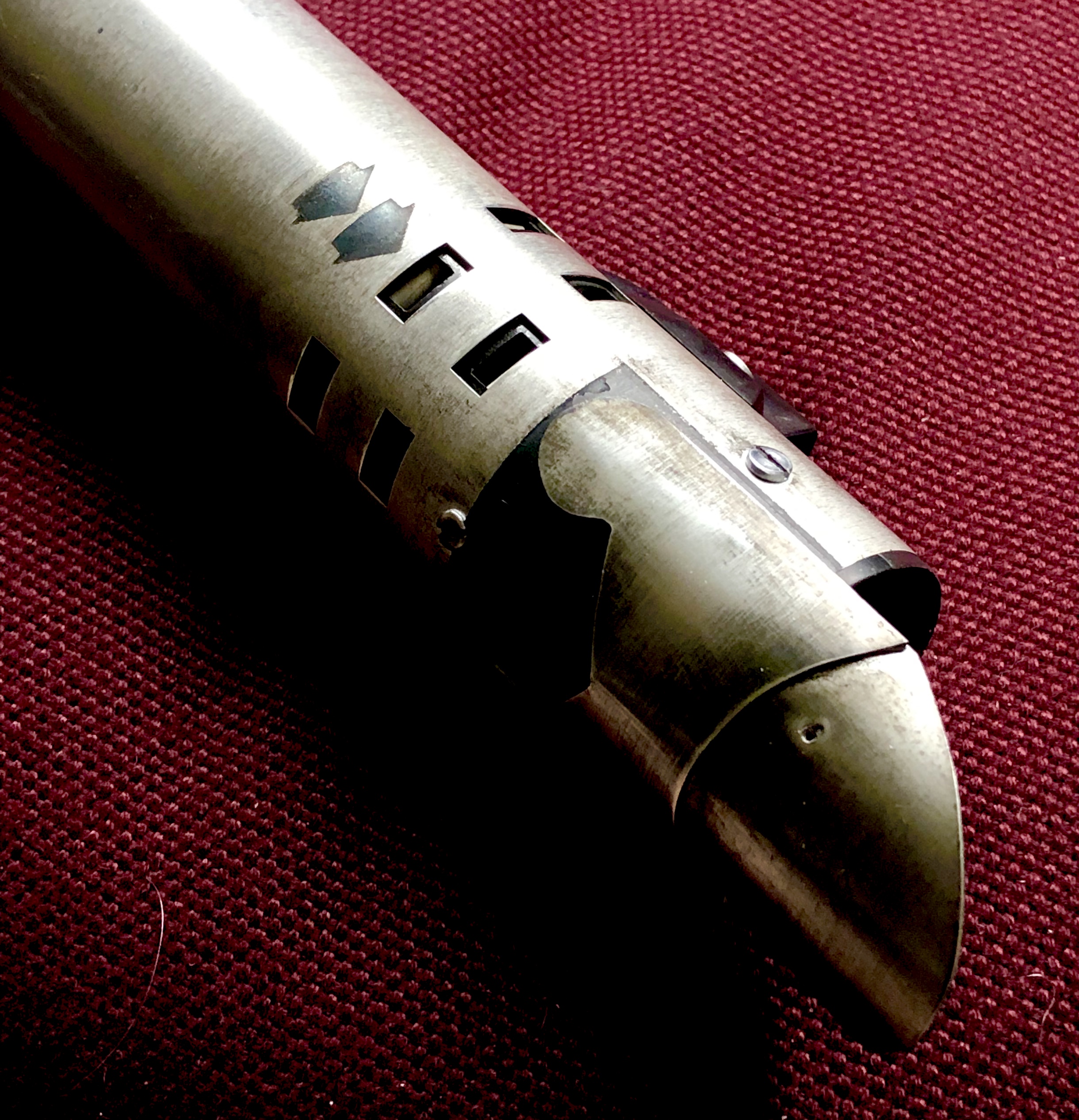

I took an alternative route regarding the large “Arrow Stickers”...
I worried that the stickers for the large arrows may not be permanent, over the years, and that painting the arrows would only lead to chipping. So, seeking a more permanent approach I used the portions of the sticker sheet surrounding the arrow stickers to create a stencil of the arrows. After cutting out the stencil, I pressed it down into position on the flash, brushed on layers of aluminum black, and pulled the stencil—perfect arrows!
I then weathered the new aluminum black arrows with extra fine steel wool, to align with my more weathered “V2” version for the hilt.
These arrows are tough as nails:

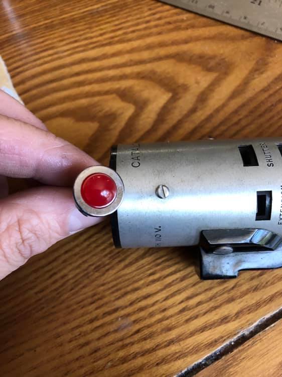

I went ahead and used the kit-supplied light.
To keep the light from being “lopped off” at some point, I used my drill press to drill out a mounting hole in the flash and JB Welded the light into the flash body:
Looks good!
When my lights came in I briefly considered wiring this and installing batteries. ...Put a spring in the control box, drill some holes to mount it and make a real switch out of the thing... A couple wires, some way to mount batteries... Drill a large hole to accommodate the stem on the light...
Then I decided that was all way too much effort for a very minor gag on a very minor prop. (Maybe next time.....)
Looks good!
I actually drilled and tapped for the fat stem on the light, just in case one day I DO decide to do this!
You can kinda see the hole in this pic.
