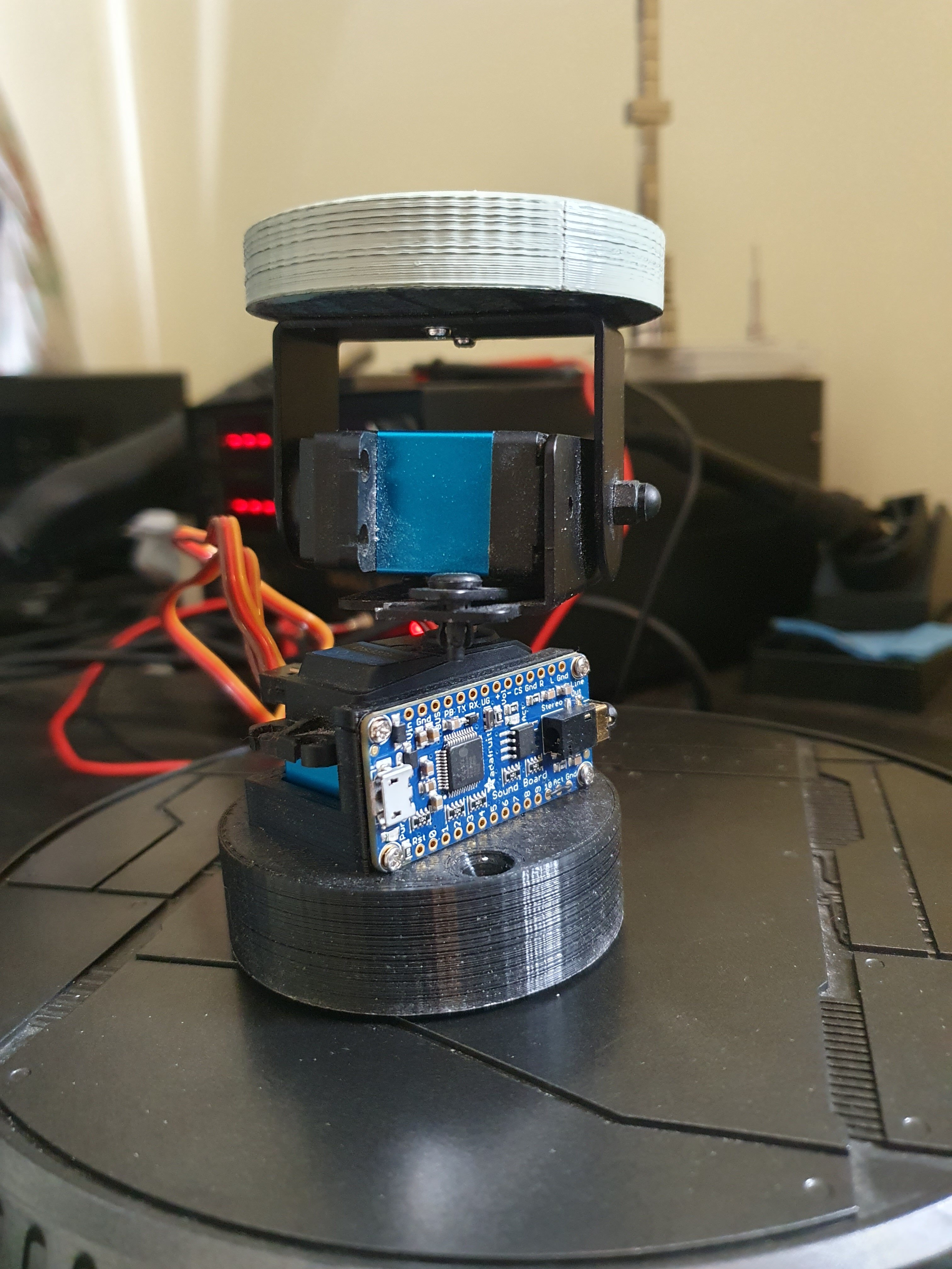

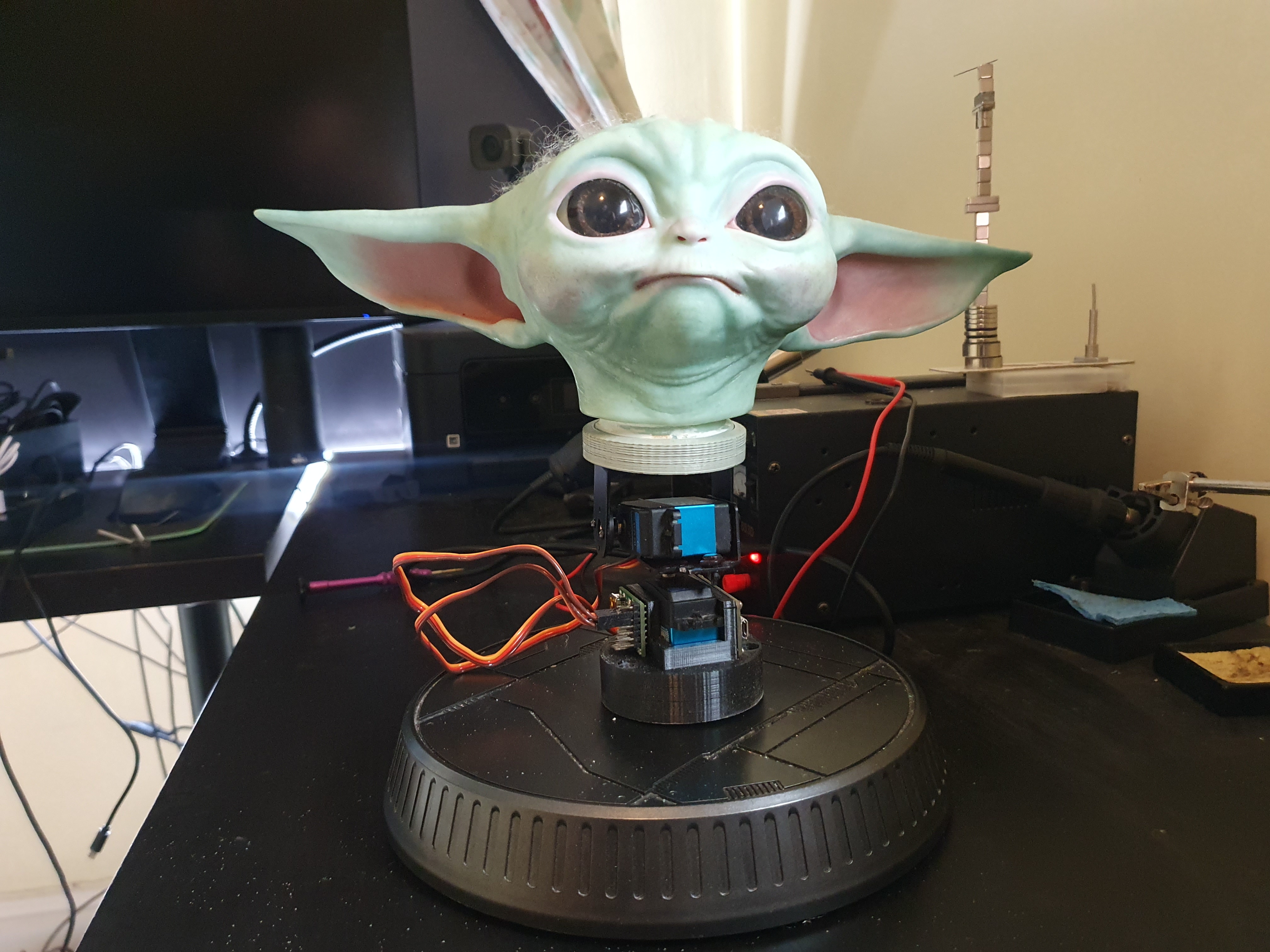

I kept the feet as metal wire, given how sunk in to the foam and resin, removing them was going to be nigh on impossible. But I replaced the arms with the tripod limbs, giving me a lot more range of movement than I had before. I also wired up a servo controller to two 35kg servos on a pan and tilt kit, powered by a 5V USB power bank.
The pan/tilt kit came with two HiTec 422 servos which were far too underpowered at 4kg. I originally swapped them out for HiTec 645 servos at 9kg but even they weren't enough. Eventually I bought the 35kg servos which may or may not have been overkill. This is my first time using servos so I didn't know how to calculate the required torque.
I completely gutted the head of expanding foam in a bid to cut the weight of the head down and give the servos a better chance (fun fact, the eyes are only half spheres presumably attached from the outside, which I wasn't expecting). I did the same for the body, taking out most of the biscuit foam I'd put in a year ago with my first attempt at pose-ability. This definitely gave me more work than I needed, but at least I could sand out a flat base for the servos to sit on once I had taken enough out for the neck to sit flush. I also had to trim a lot of the collar on the body away to get a decent range of motion with the servos.
I 3D printed a collar for the head and the servo base, so no gluing was required, I just screwed the neck collar directly into the mounting holes on the pan/tilt mount and screwed down into the body for the servo housing.

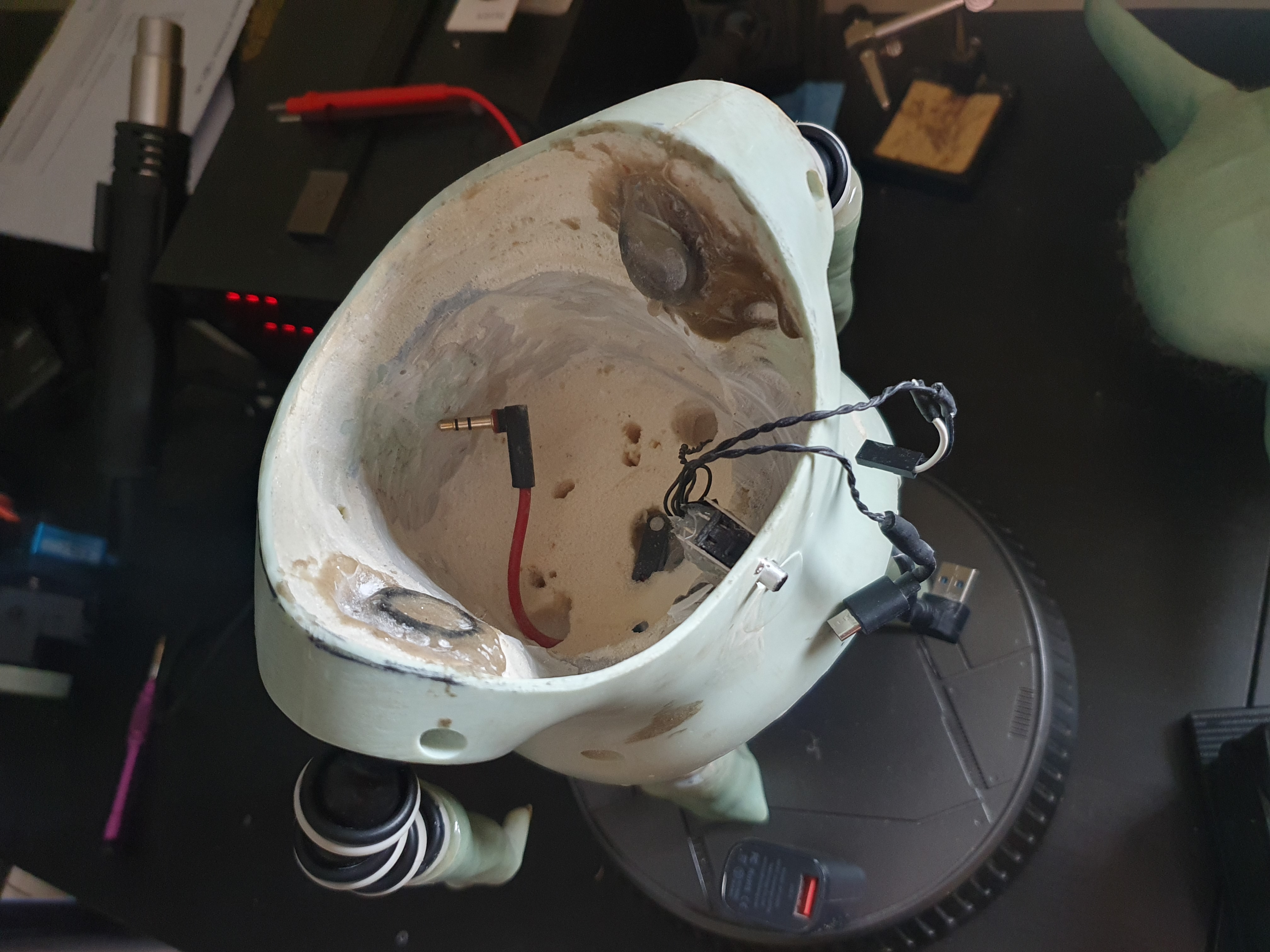

I've added a soundboard that randomises 7 cooing/gurgle noises (no cries just because without a moving mouth, it would look off). Originally I tried to make the speaker for the sounds self contained, which was possible, but with the size of the speaker and amplifier having to be quite small, the sound quality was terrible. I eventually settled on having a standard 3.5mm jack to plug in a mini speaker externally for better and louder sounds. This ended up having to be installed in the very unfortunate place between his legs, since there was no real estate higher up with the servos and having it stick out the front or back would only create an odd bump underneath the robes. Ideally, I'd have placed the speaker on the diagonal in a tail position because when he's positioned sitting, he has a tendency to roll back, so some support there would brace him up. But the only place for a battery was the butt. The benefit of make the speaker removeable is that if the sounds become annoying, I can turn off them by simply unplugging it, allowing the servos to continue functioning.
The battery is the smallest 5000MaH USB power bank I could find. I cut out a space for it which happened to sit very tightly against the shelf for the servo mount, meaning the screws holding the servo mount down could only screw in the front section. The USB connects directly to a slide switch which then takes power to both the servo controller and soundboard. As soon as the unit is powered on, the servos and the sounds function until it's turned off.
