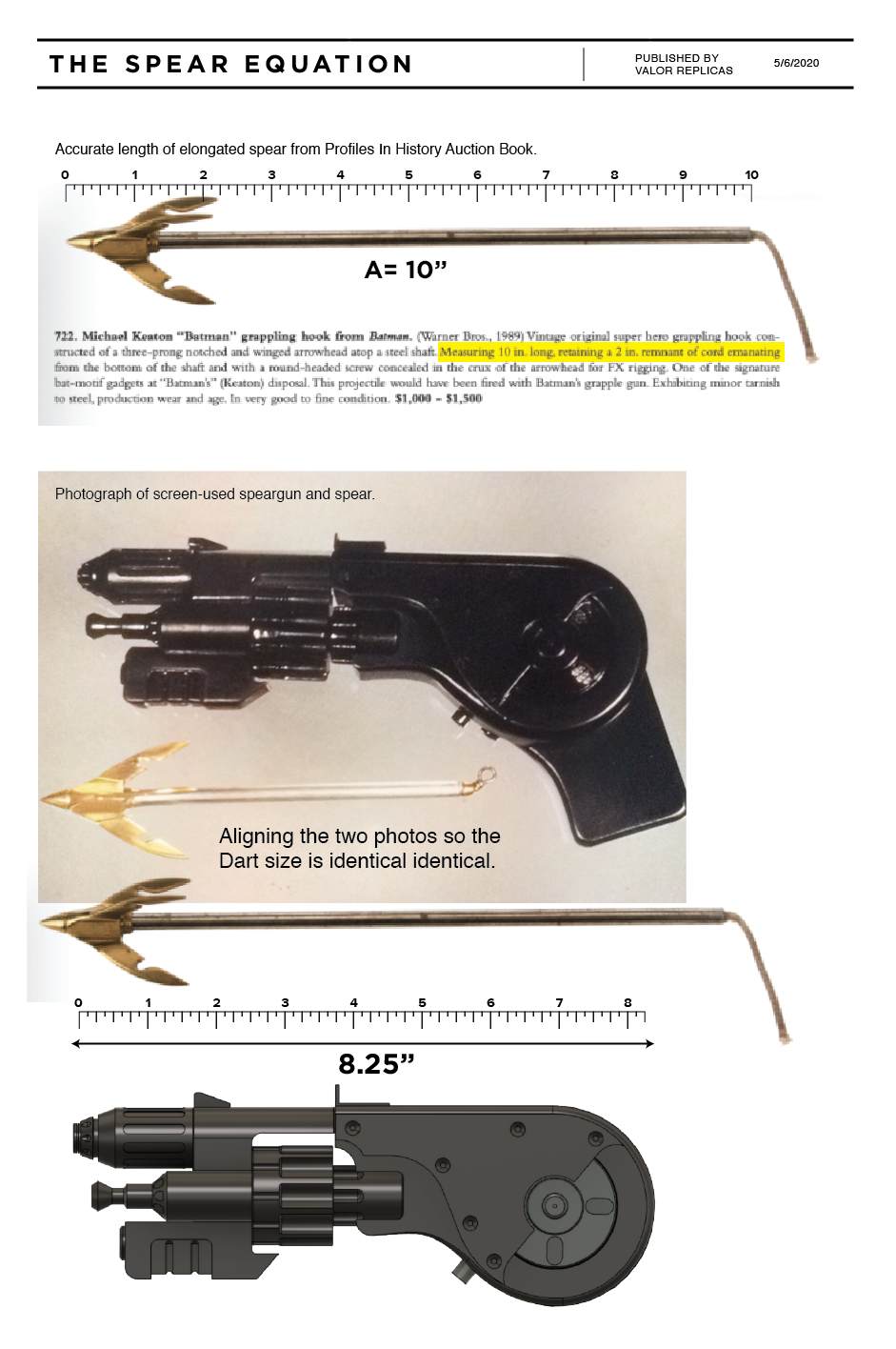

So , I'm still at this. Because now it's fun. I acquired two pieces of evidence with dimensions that I trust. One is confirmation (with photo) of a cast that definitely came out of a Studio mold. Second, an image of a loose Spear that went up for auction with an overall dimension listed.
Problem. Both of these come with slightly different overall measurements. *plot thickens*
Could the version on the belt have actually been intentionally made a little smaller to make it fit the belt better? I read about the swords from Robin Hood Prince Of Thieves and they said they made the famous swords in multiple sizes for specific scenes. They gave the example that when the Sheriff used it the prop was bigger so it would seem more unwieldy. Just a thought. I read something similar about Captain America's shield.

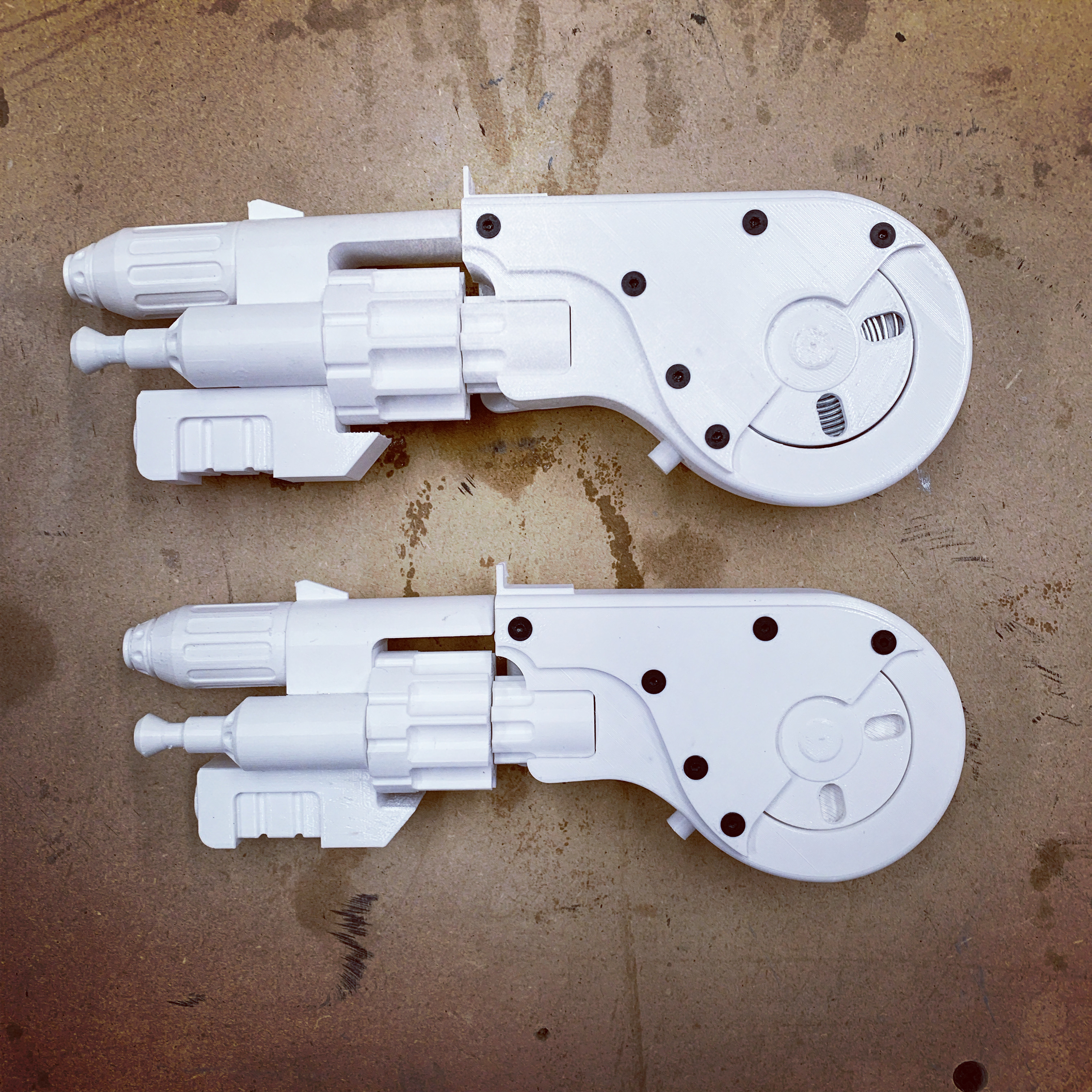

Of course! Sharing is caring! At the same time (with the help of some friends) I have have been chipping at the last details to get the speargun where I want it. My goal has always been to create an "accurate" replica of the screen-used guns. Recognizing that there were several guns. I wanted a replica that captured the screen-accurate appearance to MY satisfaction. I'm not saying it's perfect, the most accurate, or better than any other replica out there.
That said, after all this nonsense, I think I'm locking down on an 8" length to my gun. For reason that matter to me. Partly because I believe it is damn close to at least SOME of the guns used. And also because, in my hand, it just FEEEEEELS GOOD!
My plan from here is to build 2 guns using 3D hubs services. Parts either in Formlabs resin, or black SLS. Still exploring options. The dart will be all metal, made from a combination of cut and 3D printed brass.
Stay tuned.

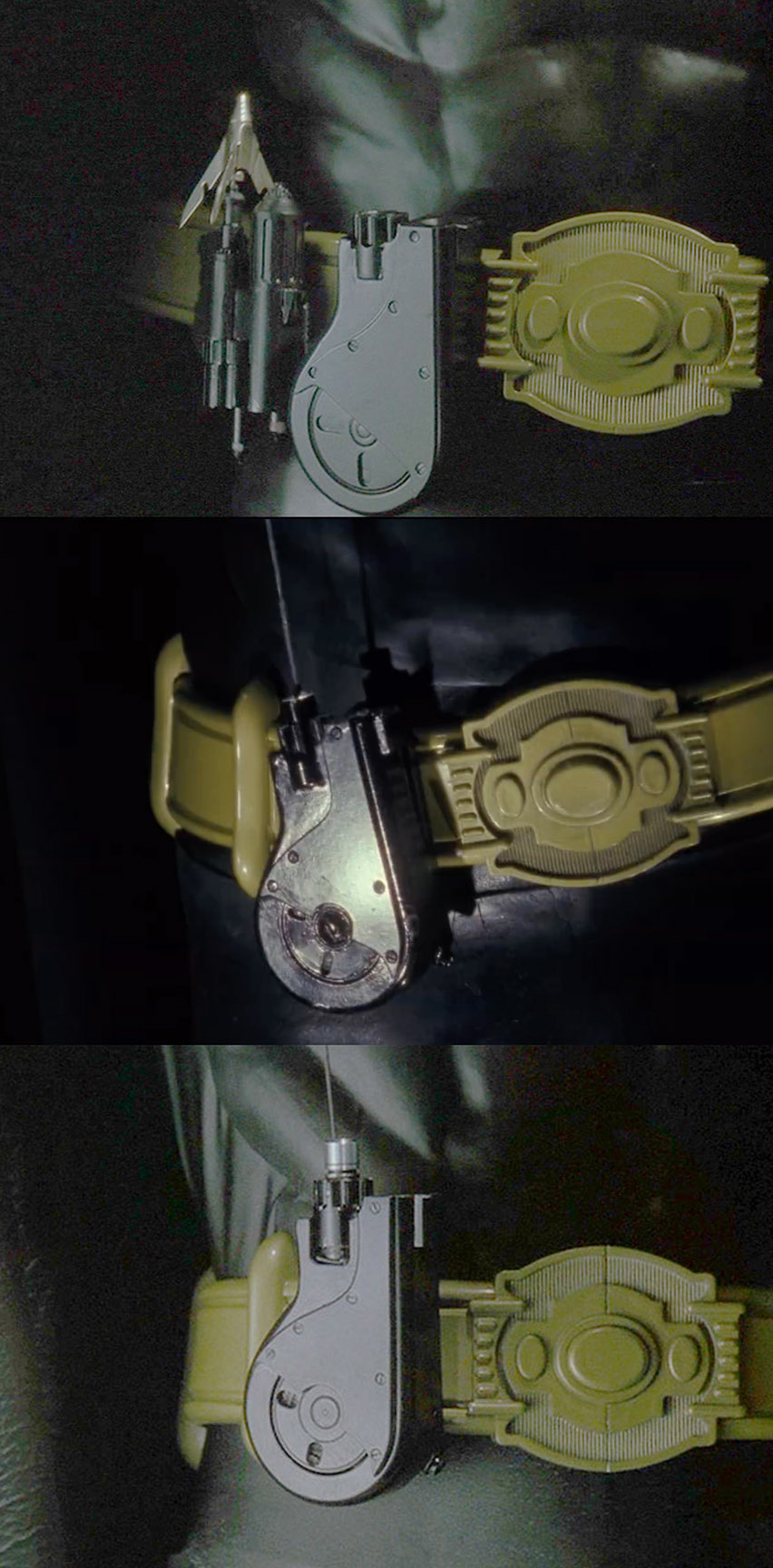

Here's a fun example of how inconsistent the guns were in Batman 89. These three scenes are all from the same scene - the grapple ride up to the catwalk. Let's notice the differences in just 25 seconds of film:
  • Pic 1: This Speargun rotates around the belt: 6 screws on the Reel Plate. NO semicircular cut out around the center of the Reel Plate. Large diameter reel.
  • Pic 2: After he shoots the grapple, this Reel Section is reattached to the belt: Now there's a semicircular cut out at the center of the Reel Plate, but there's only 5 screws. And the reel diameter got smaller. The paint job sucks. Other details have changed as well.
  • Pic 3: Vicki is about to grab the reel. Bad to 5 screws and a better paint job.
I get it, these are three different props used for very specific effects. And there were certainly others. This though, is why trying to make a "definitive" speargun (like a lot of other props) is an exercise in making choices.
I do think there's a 6th screw on the middle pic. It's obscured by the light, but you can see the round screw head and the direction of the slot in it.

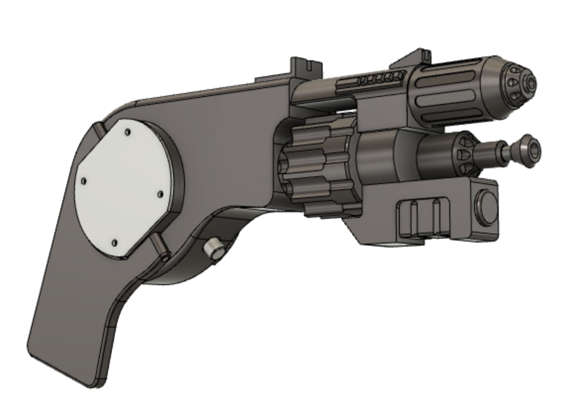

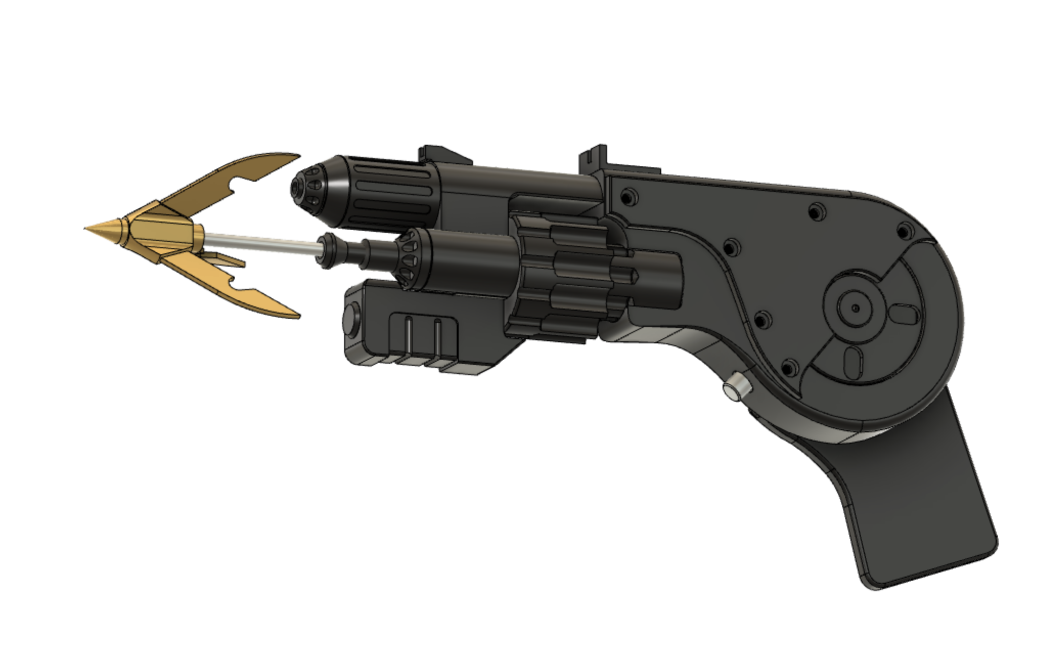

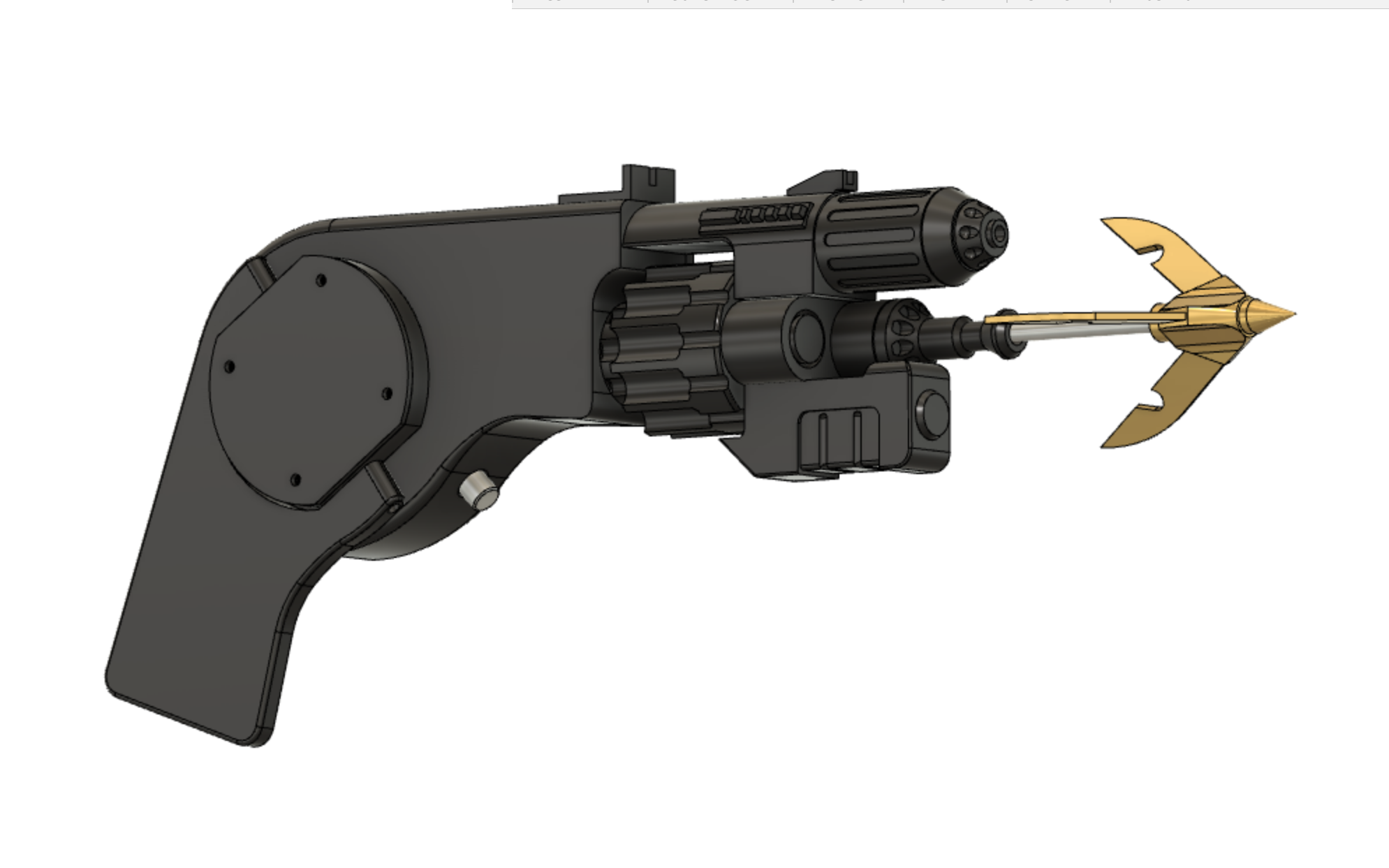

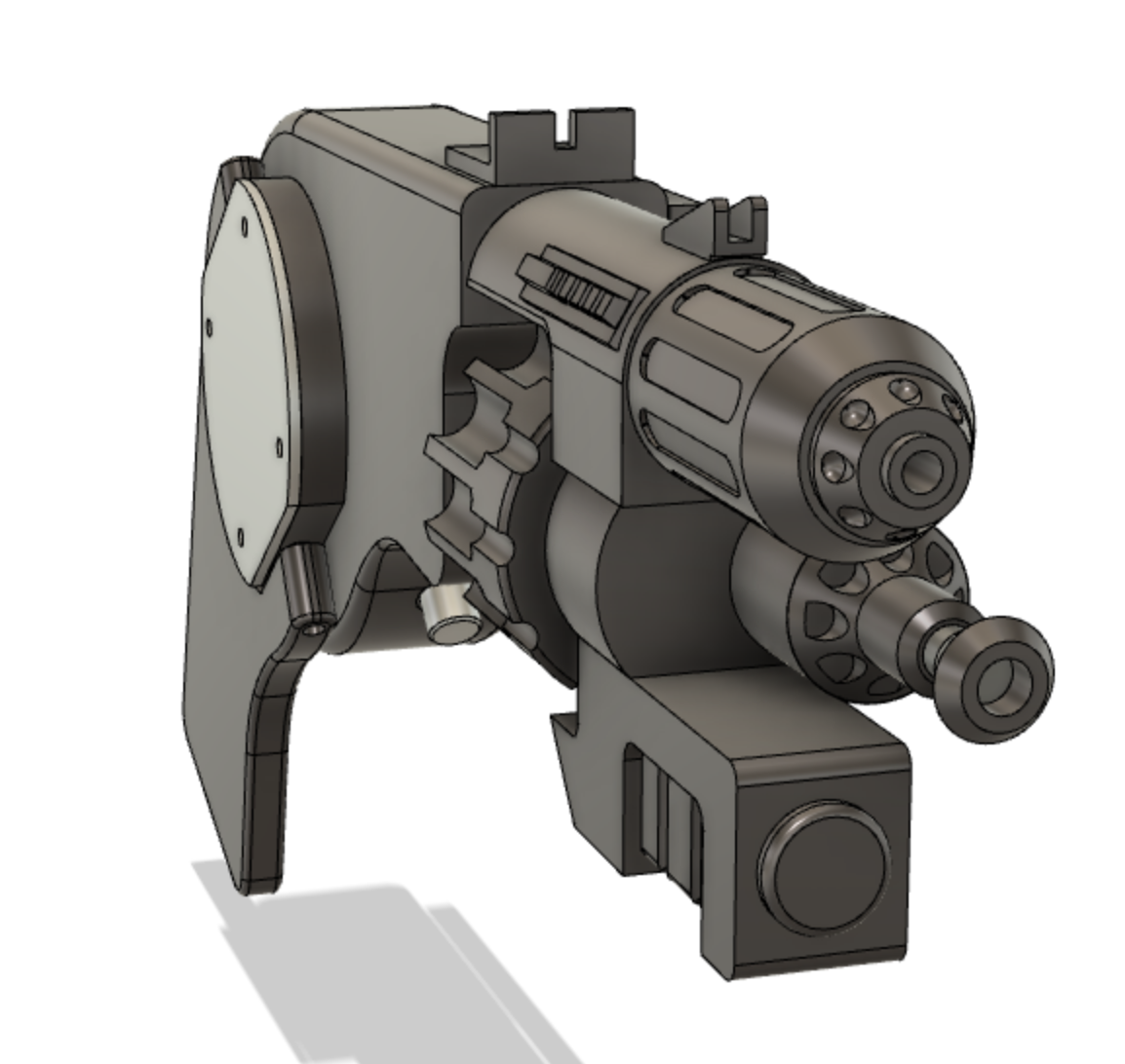

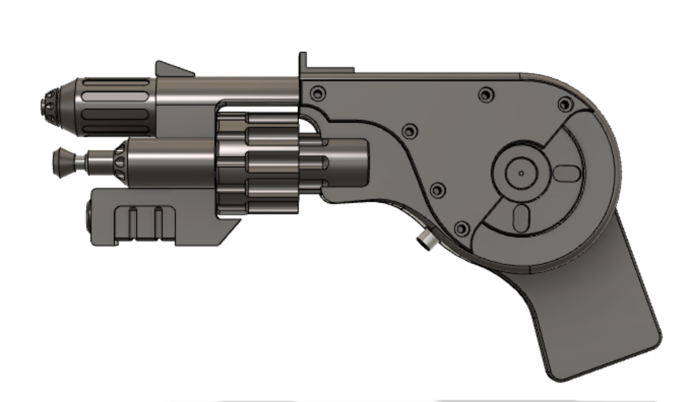

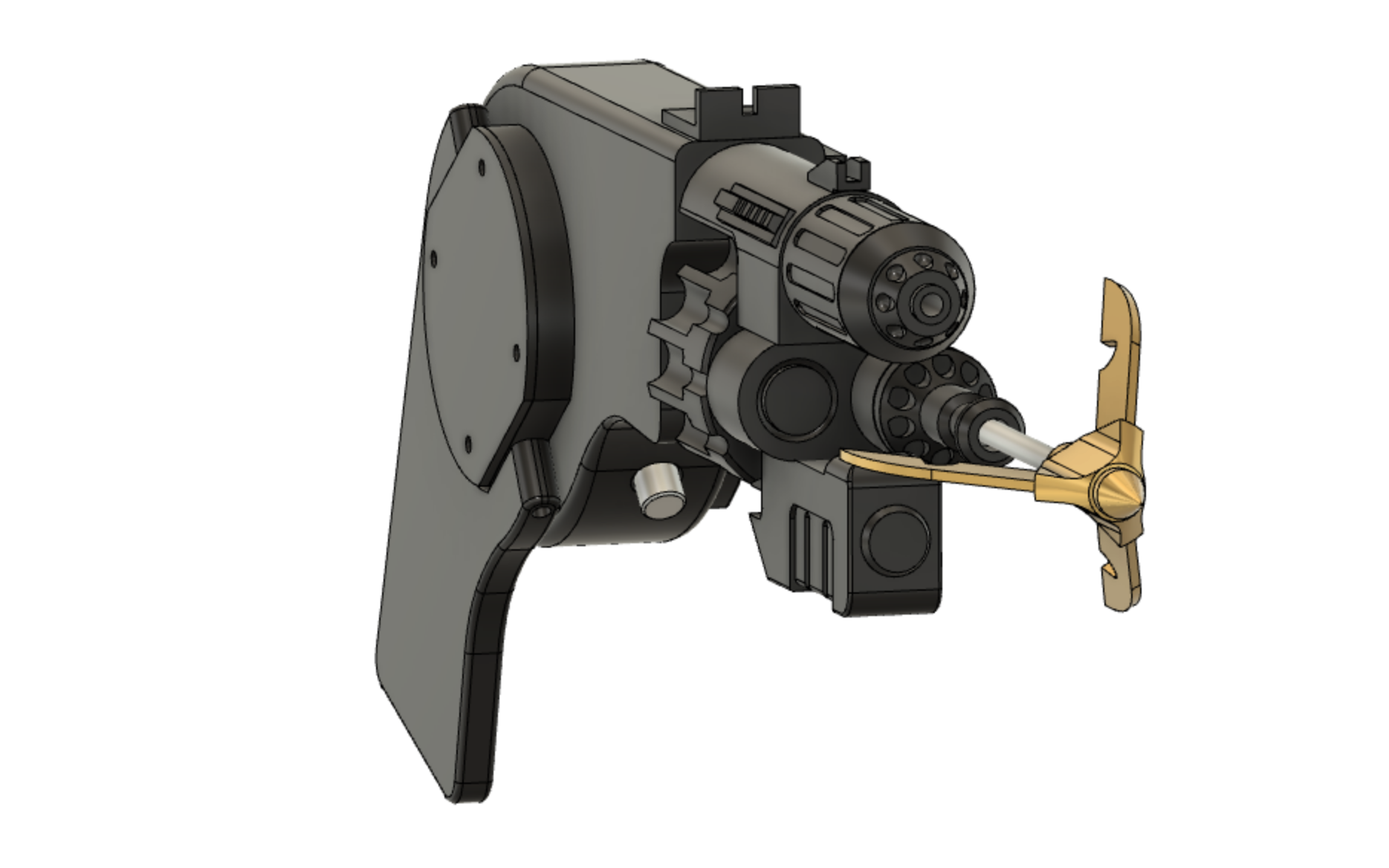

Okay, after a round of last minute accuratizing based on access to some exclusive pics, I think I'm happy with where this has landed. I'm prepping files for printing. I ran into a bit of a snag with one online vendor. 3dhubs refused to print this because it is clearly a firearm *eyeroll*
My plan is:
  • Most speargun parts will be printed in dyed black HP MultiJet Fusion material. Which is a sintered black Nylon. This is a highly detailed process that results in a slightly textured black finish
  • The Dart rod is stainless steel
  • The gun will have a brass tube the dart slides into so it is solid
  • All metal screws and hardware
  • The Dart tip is 3D Printed brass (also laser sintered)
  • The Dart will have brass fins laser cut from real brass
  • The Side panel will be cut from aluminum sheet painted black
