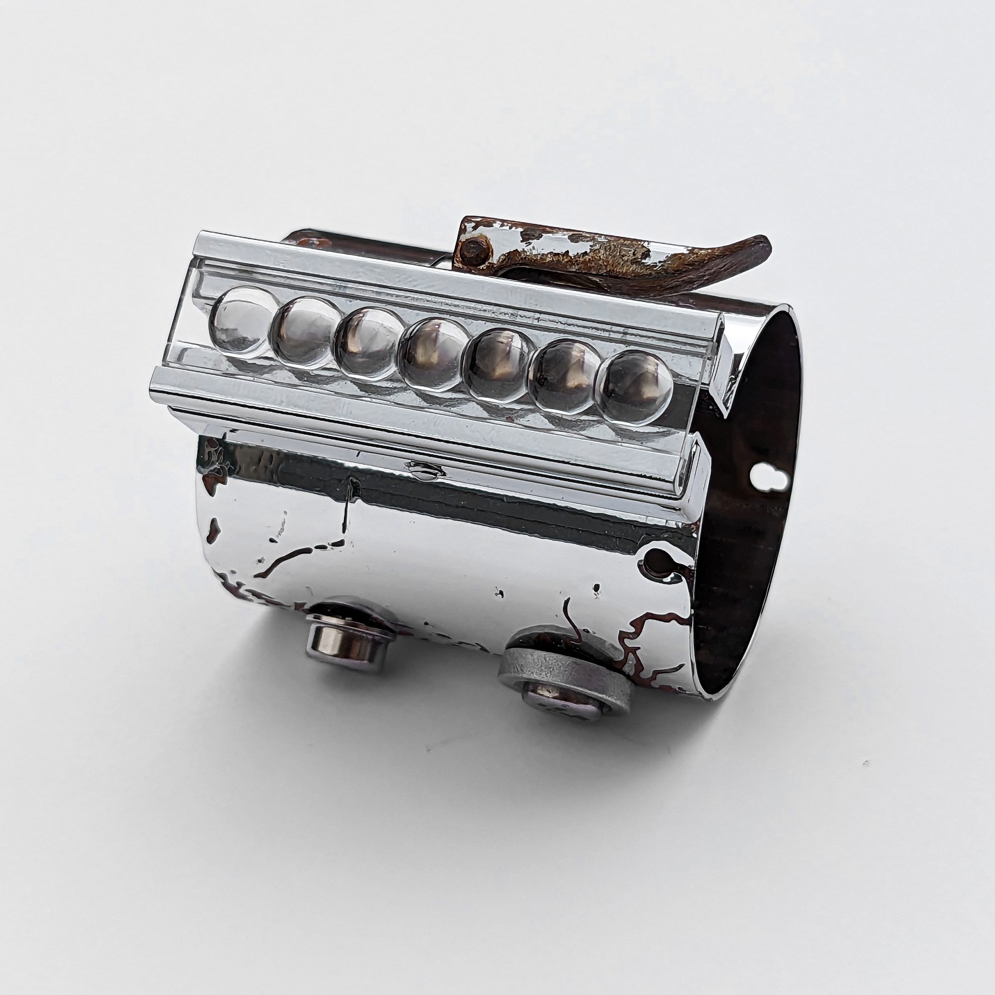

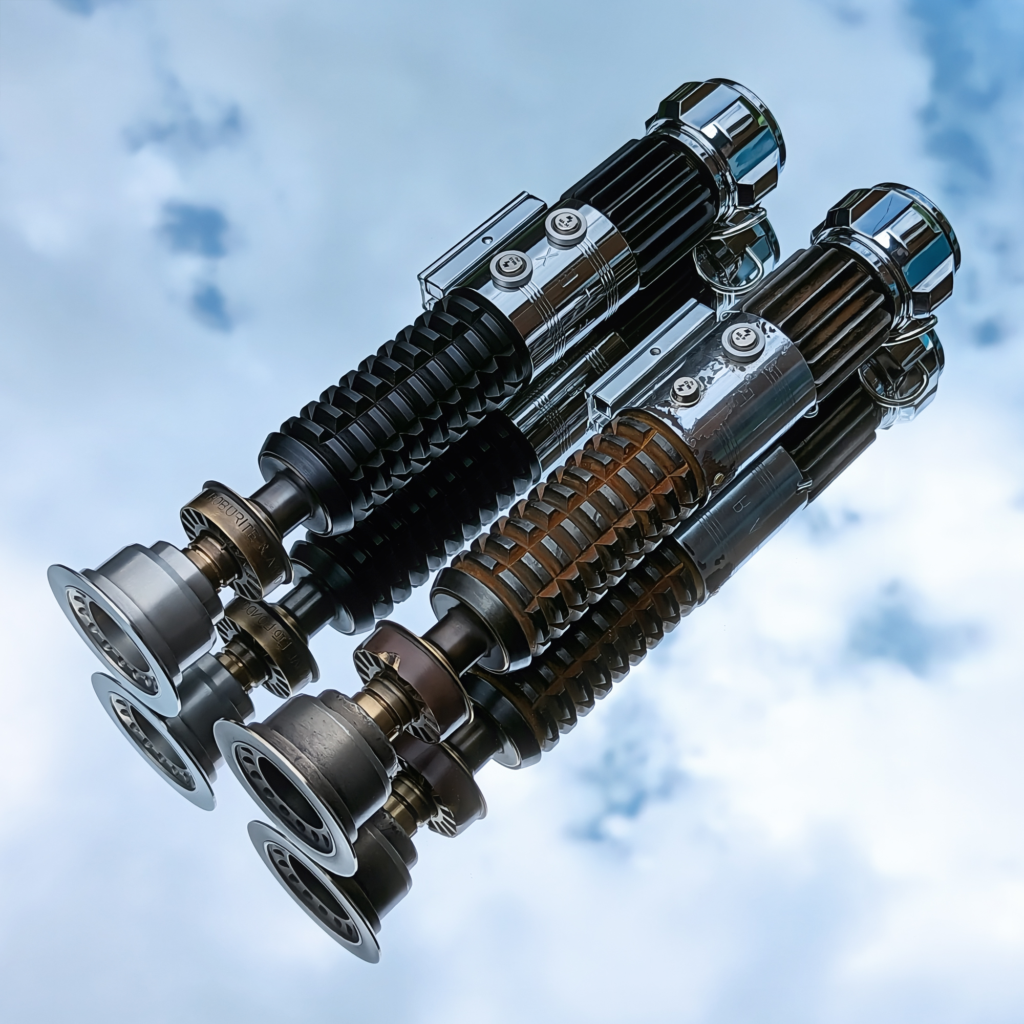

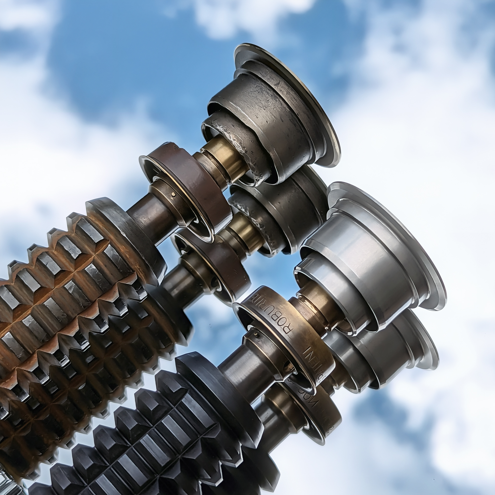

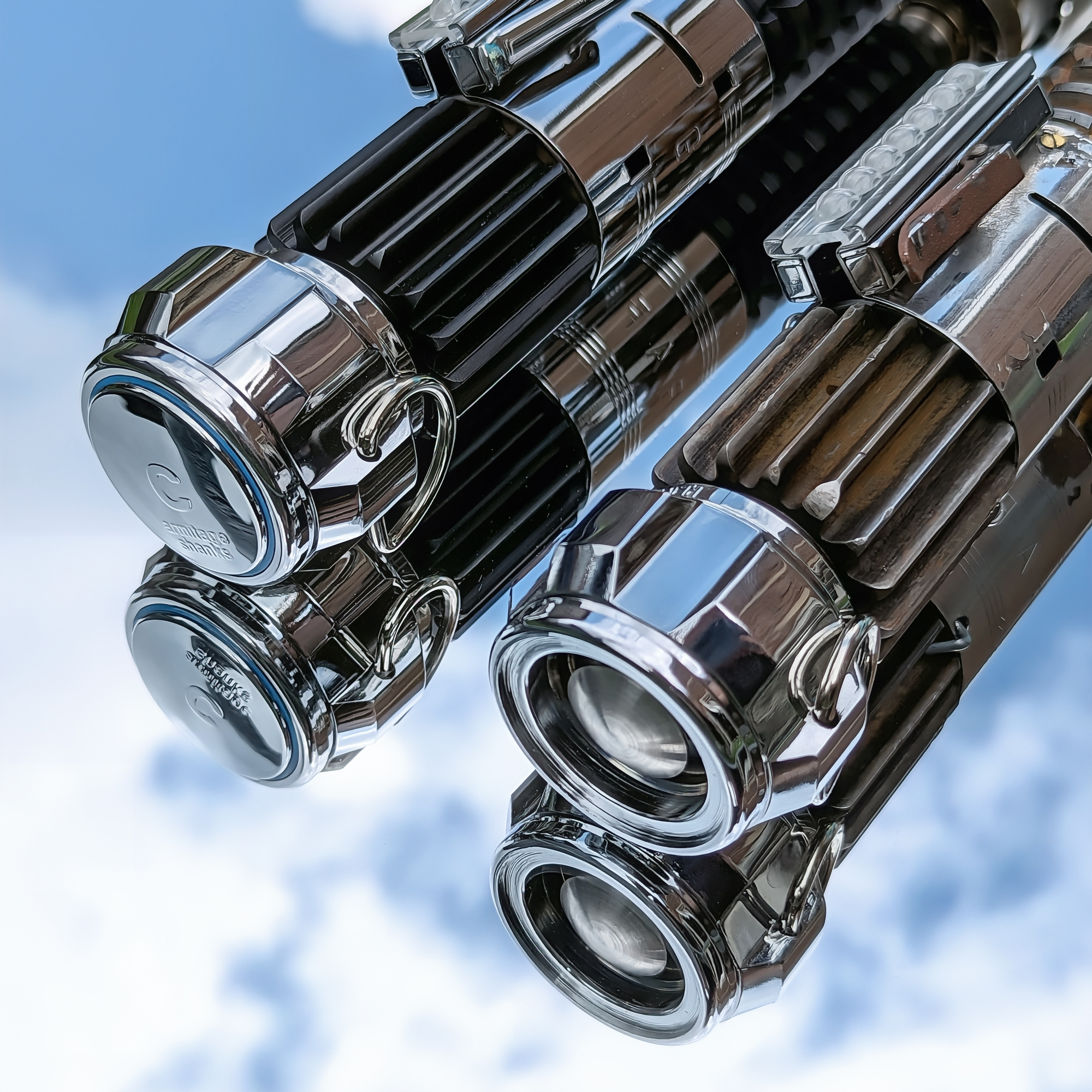

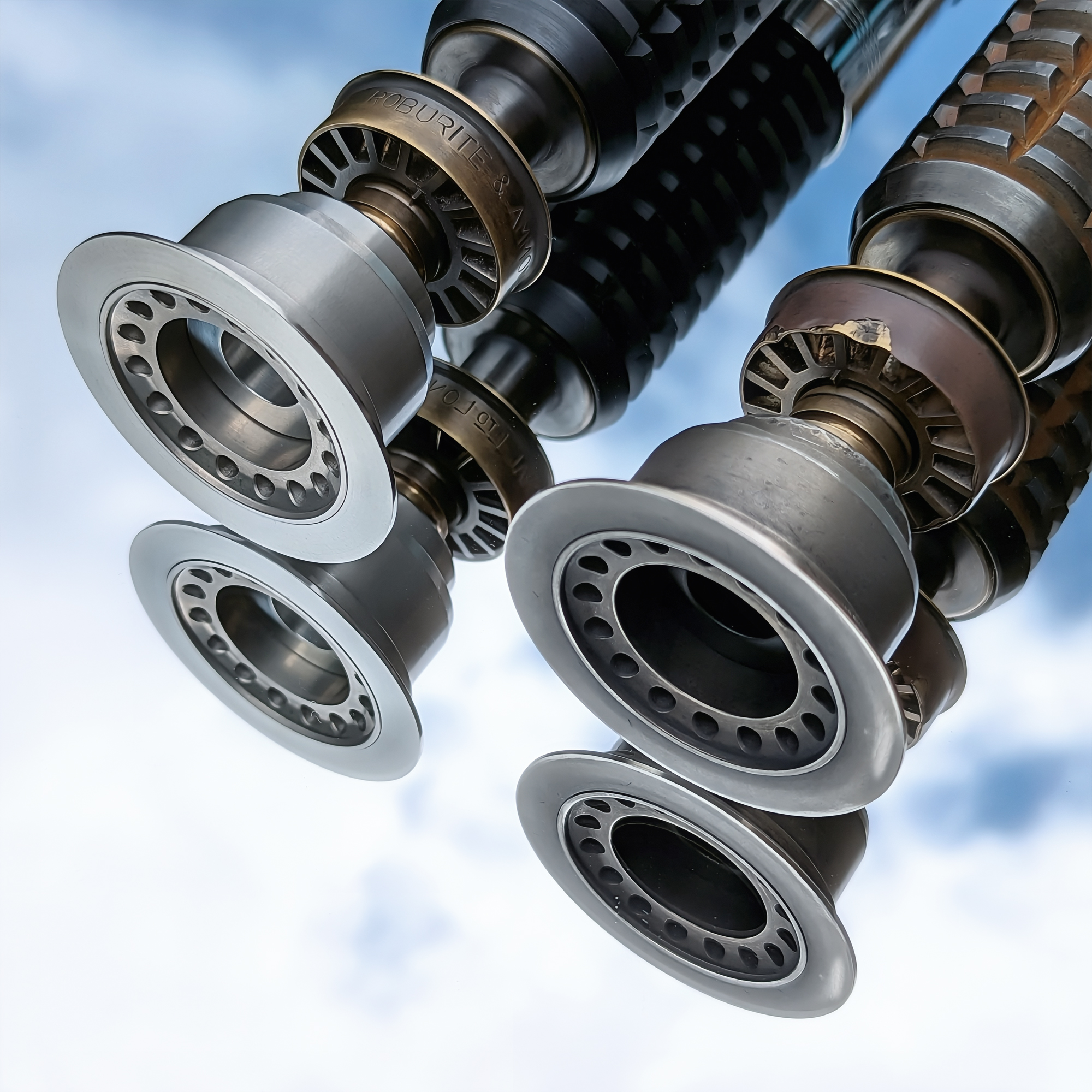

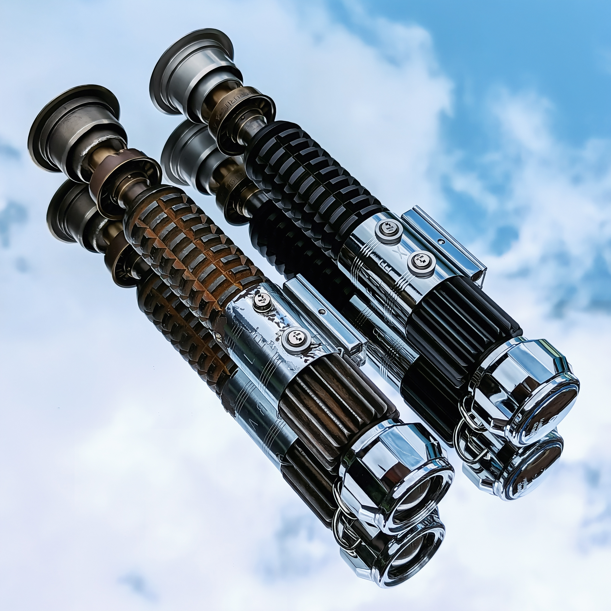

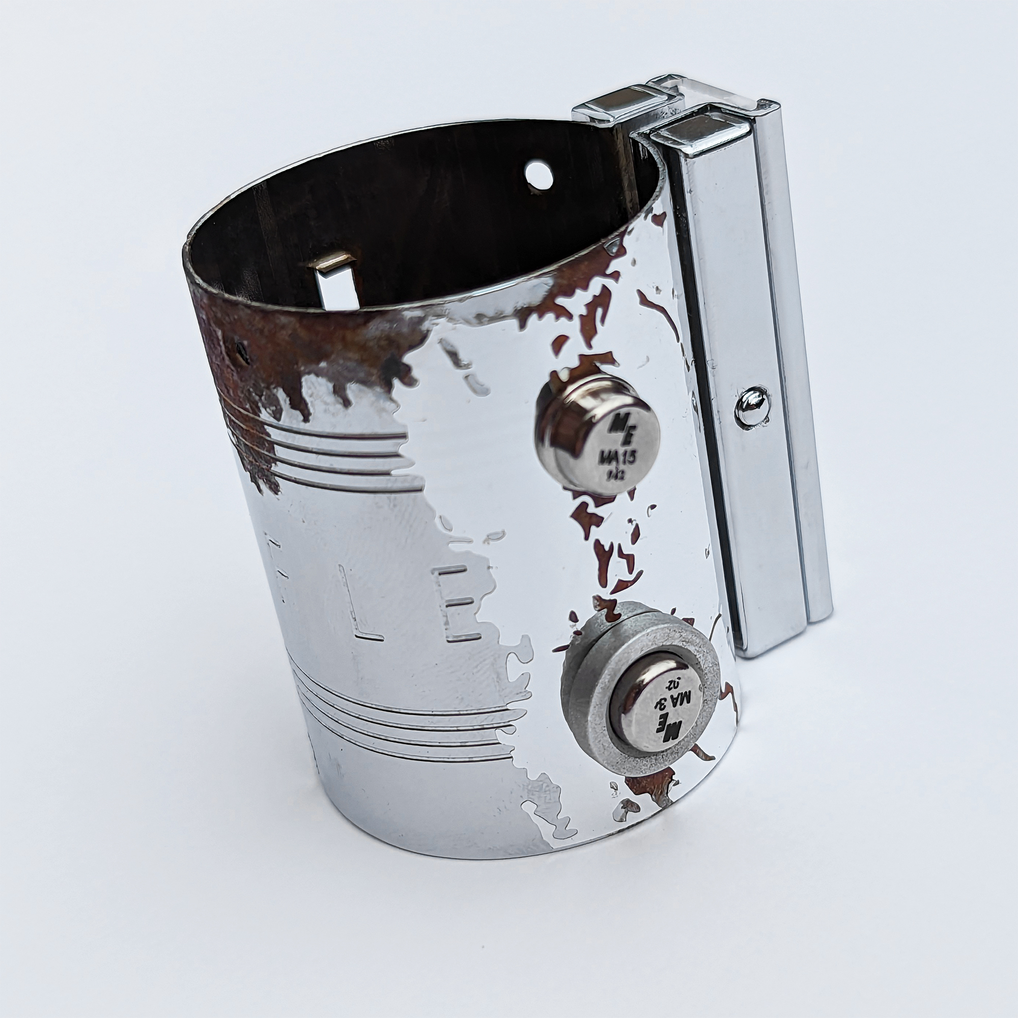

For "ThinNeckThursday" this week I took some beauty shots of a finished un-Weathered hilt next to my weathered build for comparison:
I did intend on swapping the clamp over on my weathered build in time for these, but didn't quite have one ready unfortunately. I've been experimenting this week with the final method for weathering my clamps and it's taken a little longer than I expected. The one in the above pictures has the rust painted on, as this third party replica is made from stainless steel and not plated.

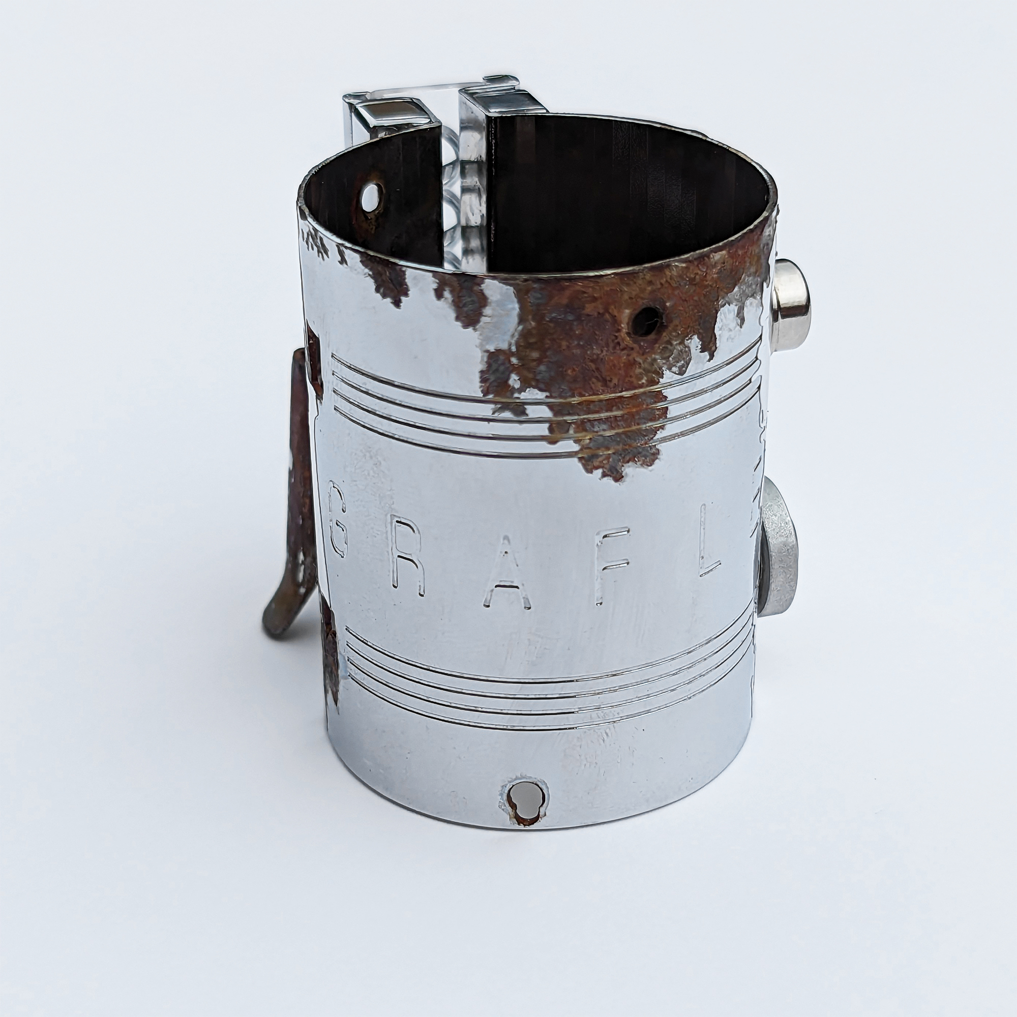

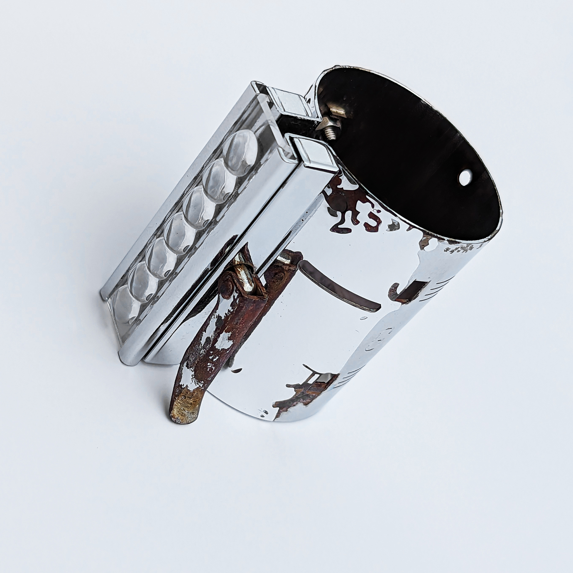

I've finally settled on a method for selectively removing the plating and getting the underlying steel to rust.
After MUCH experimentation with chemicals and acids, I've decided the most controlled method is to grind off the plating by hand using a rotary tool.
The rust is then kicked off with white vinegar followed by several applications of water spray. The process is sped up using a heat gun:
Please bare in mind that this is freshly applied foil and doesn't yet have any additional dirt and grime. So it still looks VERY clean!
Please consider this a WIP.
The rust seen here is genuine rust though, and I'm really happy with how it's turned out in the end. :)

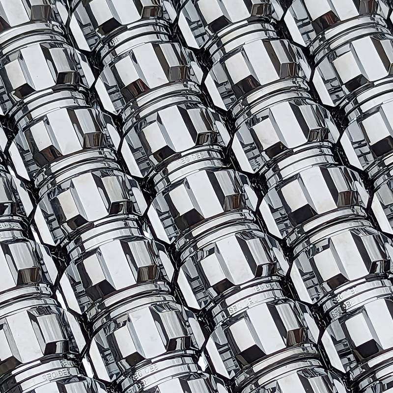

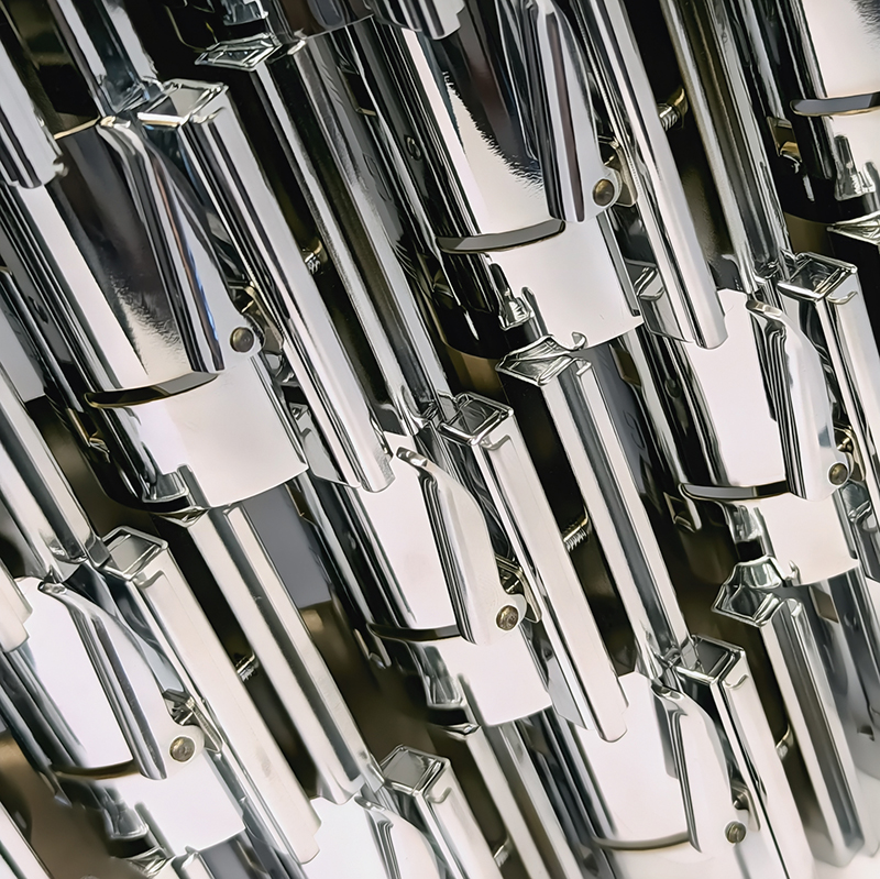

Much of last week was spent assembling the various sections for the un-weathered hilt orders.
The Injection moulded parts arrived, and it took a while to go through every piece to check for imperfections and make sure nothing was missing.

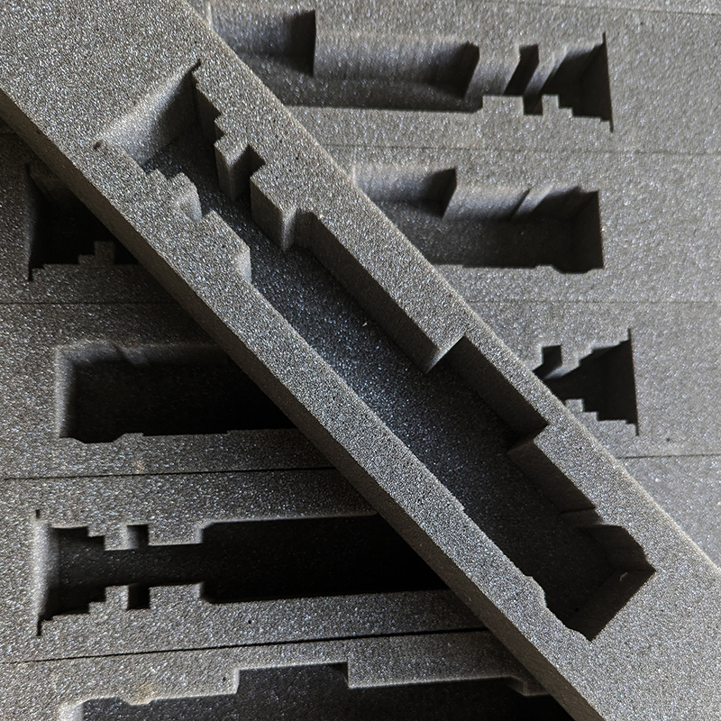

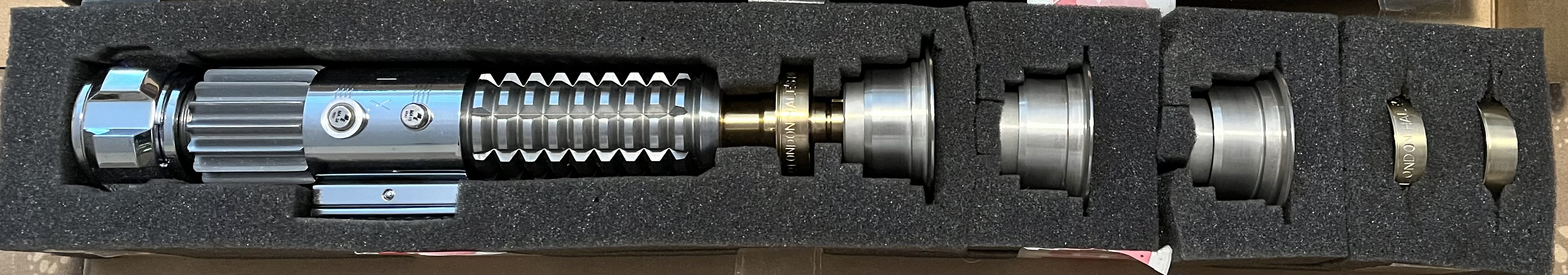

I'm really happy to say that the foam inserts have finally arrived now too!
This will speed up the whole shipping process massively, and will hopefully be a more enjoyable unboxing experience too now that I'm able to ditch the bubble wrap!

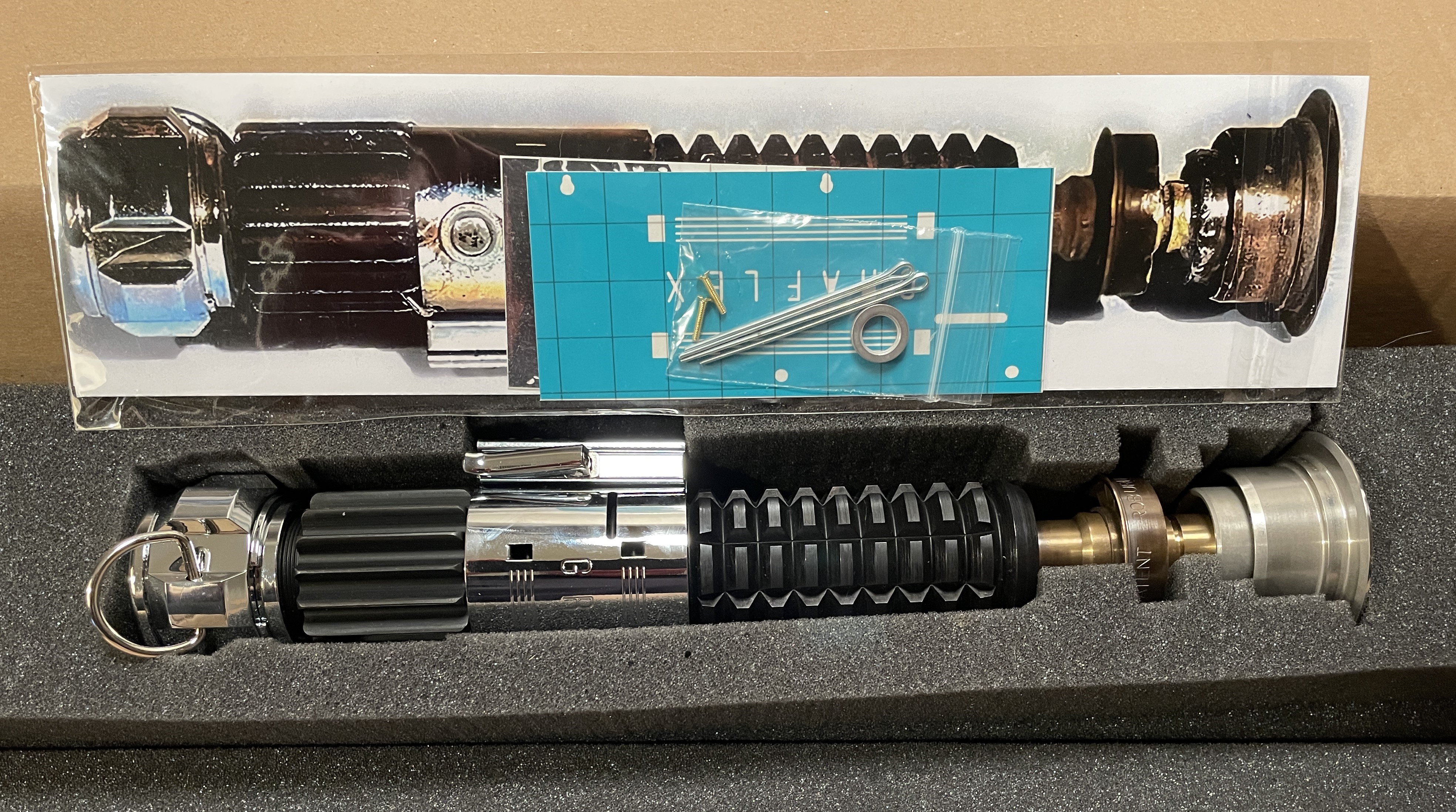

This astonishing work of art arrived via UPS today. Your Obi Wan ANH Lightsaber is stunning, it has a forensic level of detail and a seriously, solid heft. It will take me a while to fully take it all in - but congratulations, it is an extraordinary achievement.

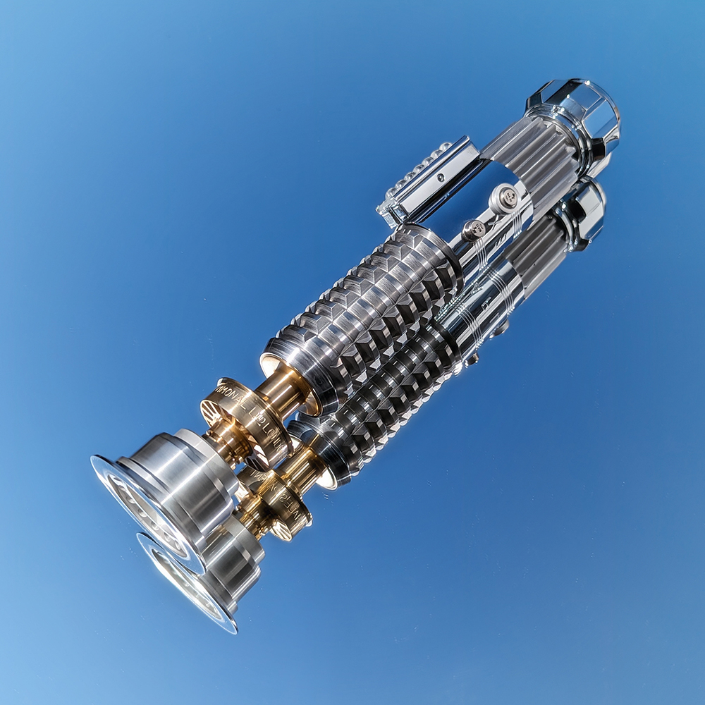

I took this image of one of the few fully machine finished orders as I don’t think I’ve posted one previously and not sure I’ll see another one any time soon:
It’s a huge relief to finally be shipping complete orders out to people! (If a little nerve racking too!)

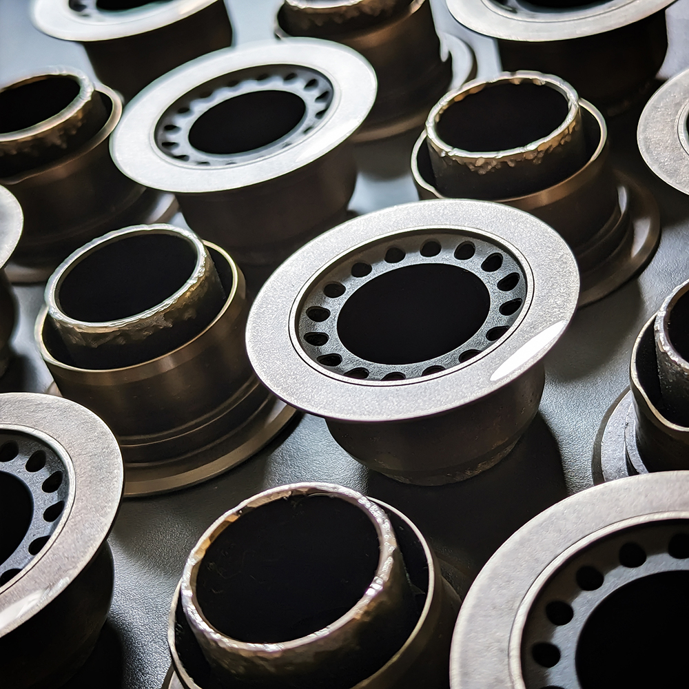

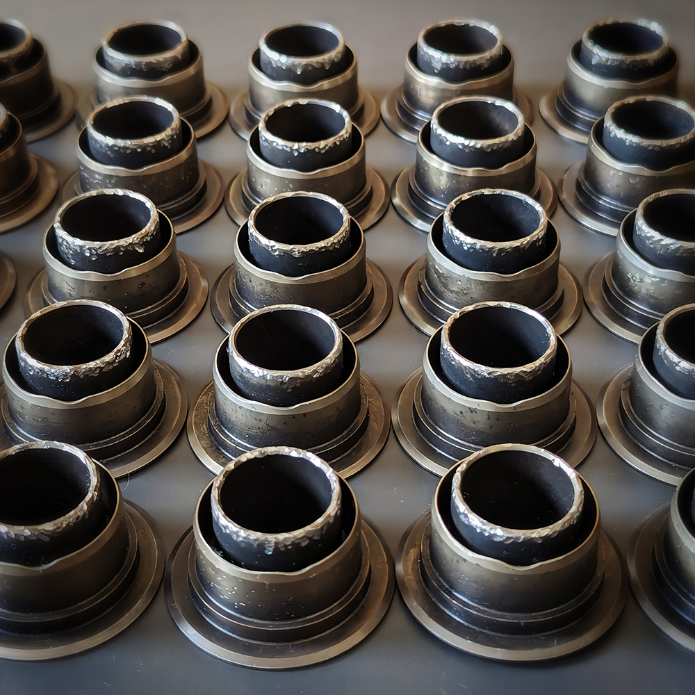

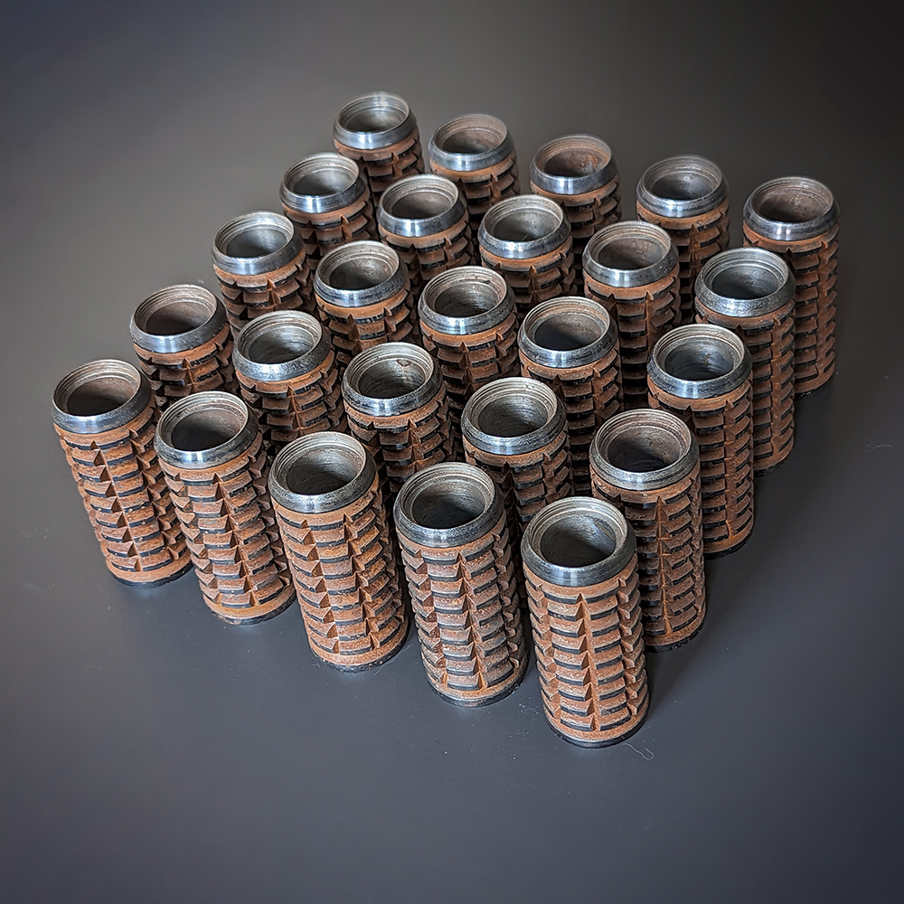

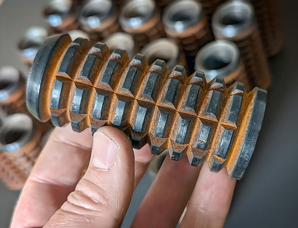

The Process for rusting the steel is working well, and all grenades are finished and ready for install:

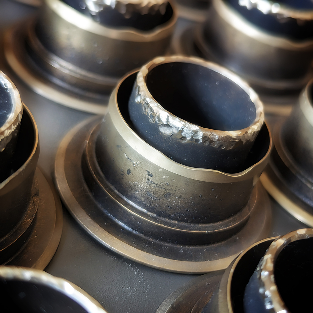

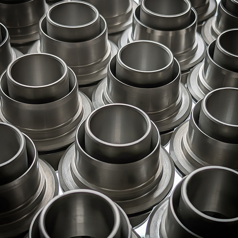

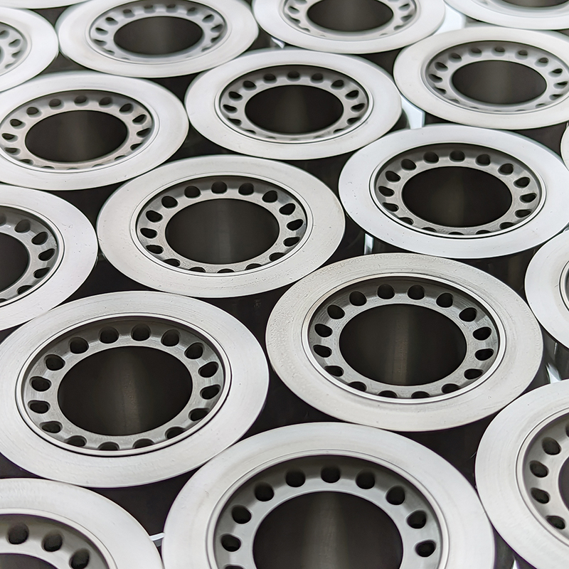

Emitters are all done and ready for installing too. These are particularly time consuming so it’s good to have these finished and ready to go. (y)

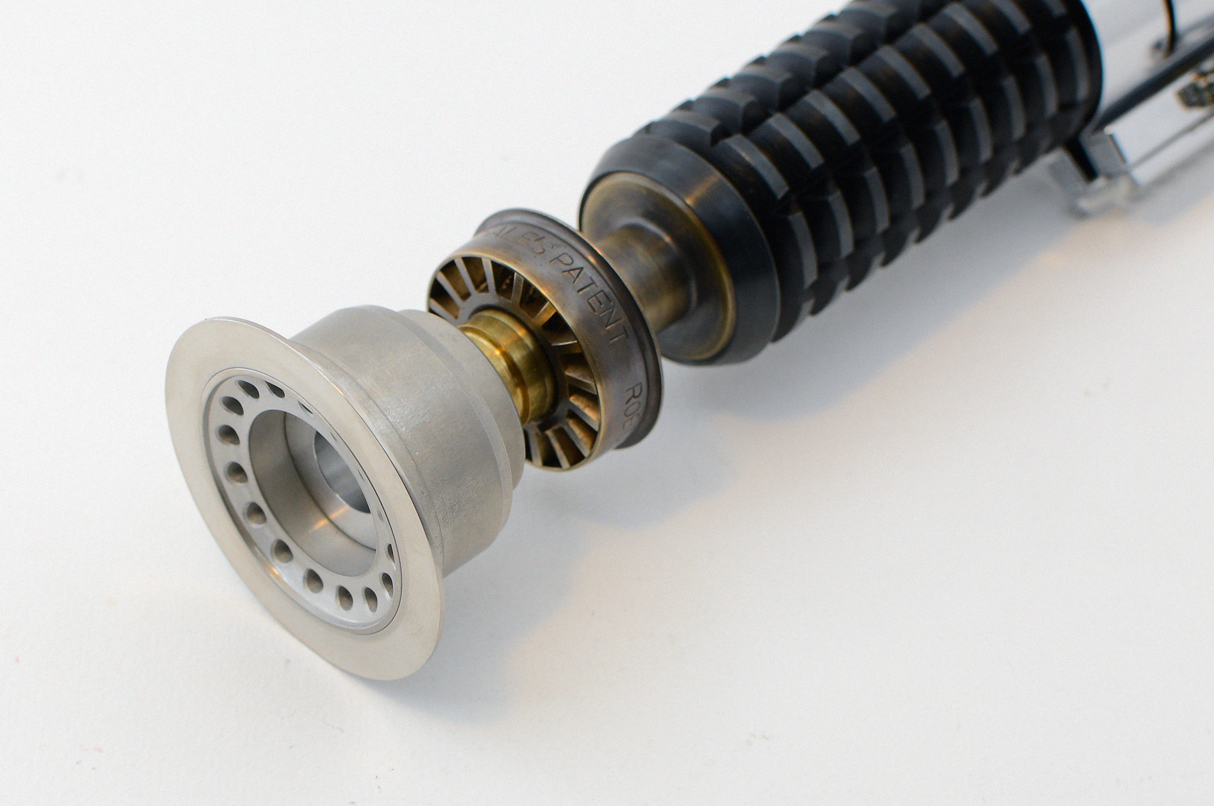

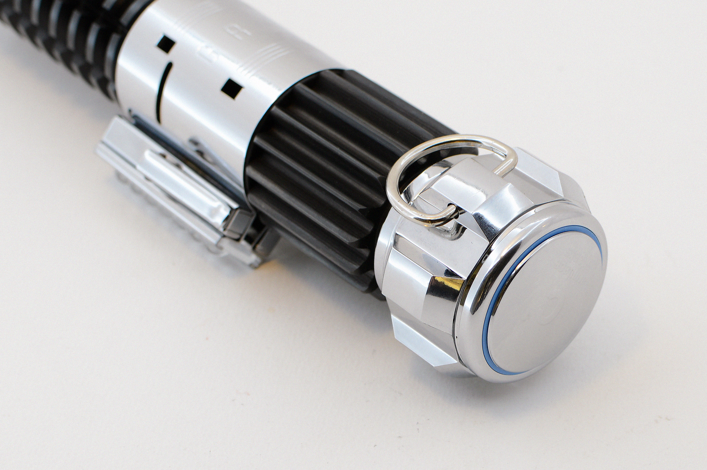

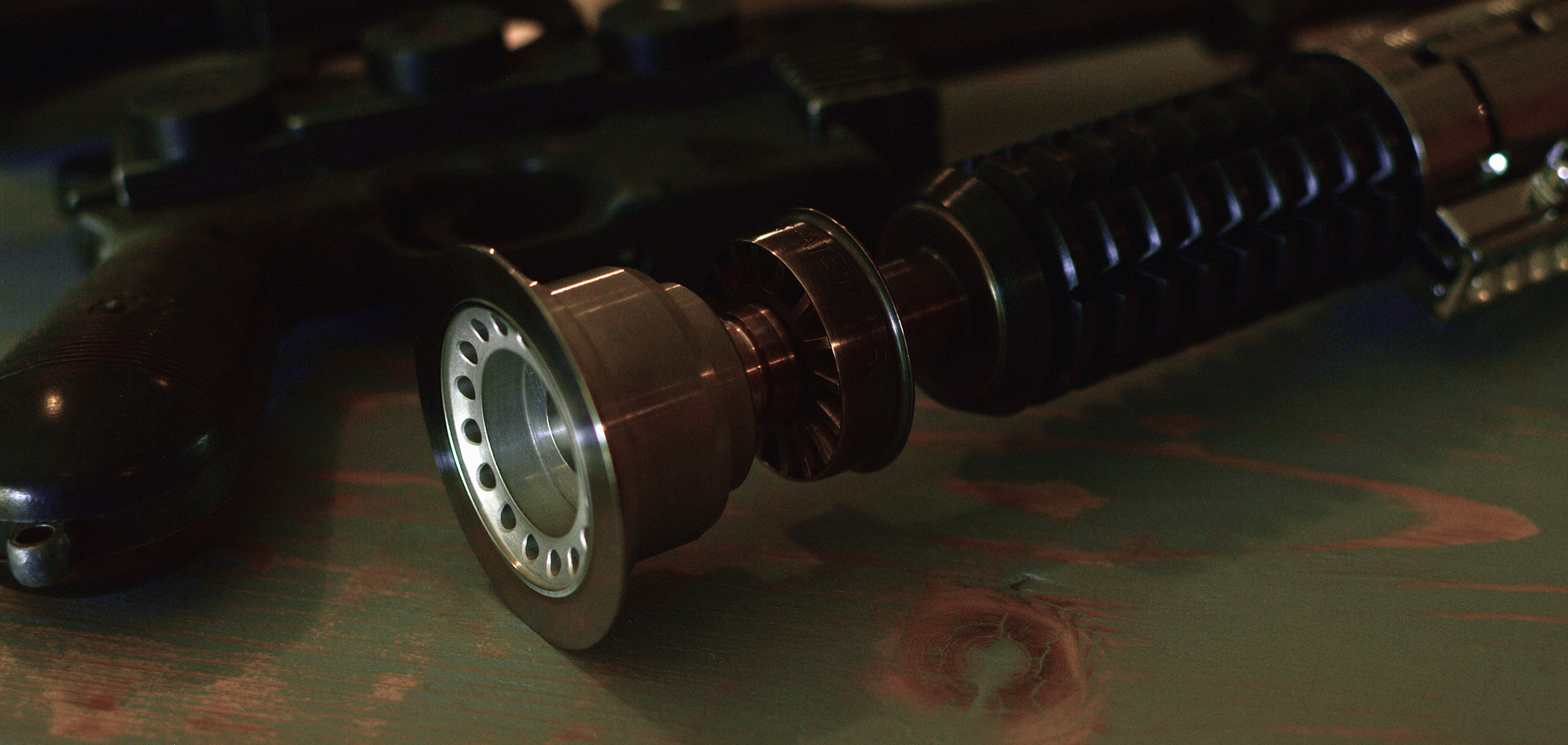

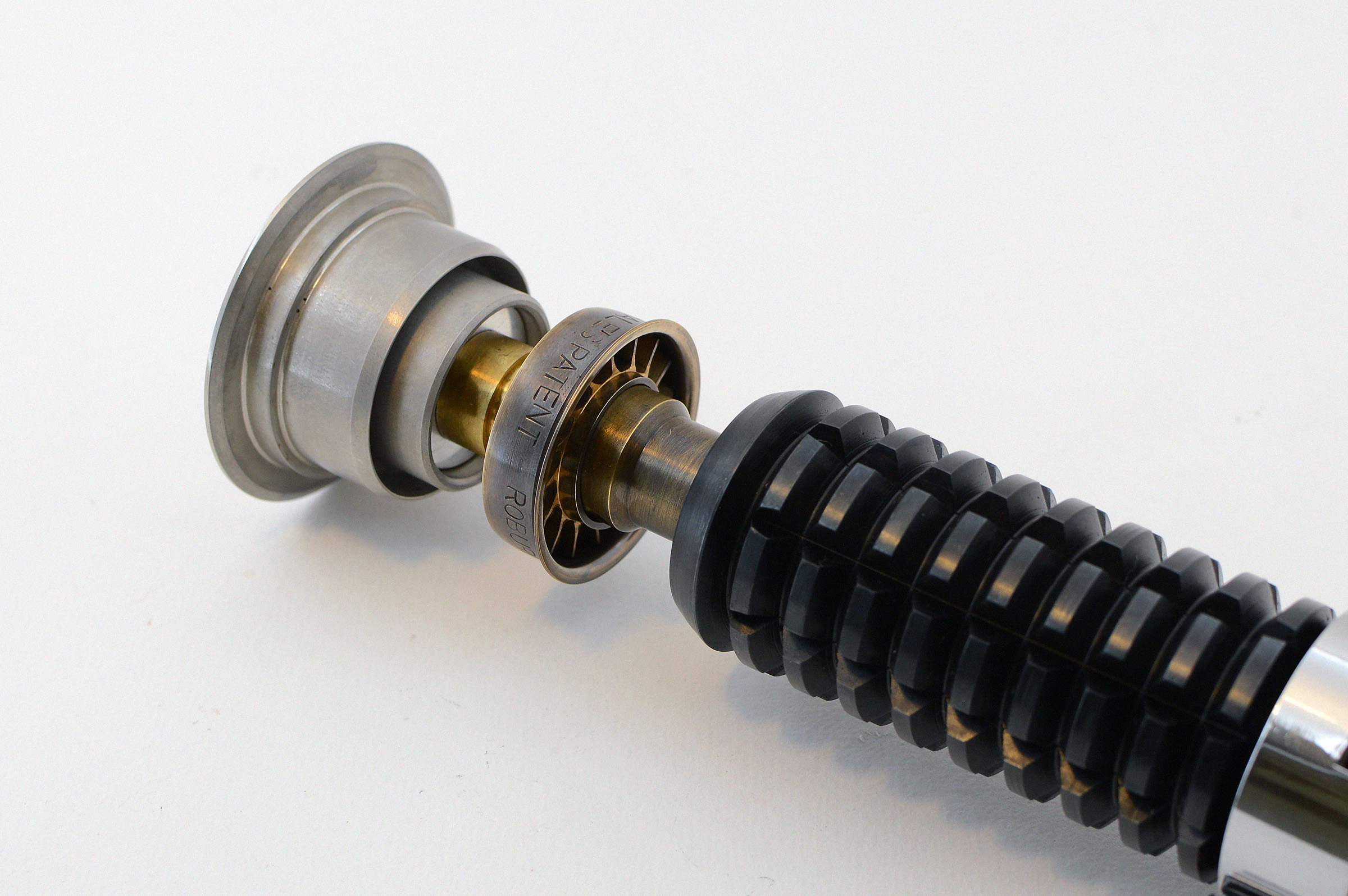

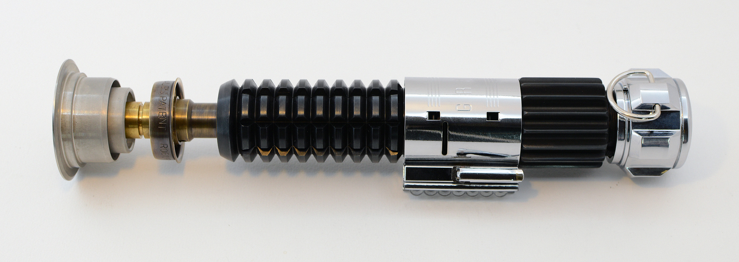

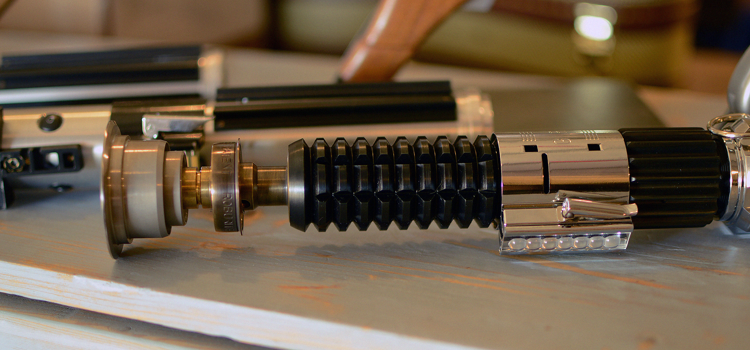

Dave, I have received my saber today and it is an amazing prop!
this is one of the best replicas I have bought since collecting and it is exactly what I hope to receive everytime I order from someone. I know this run has been difficult, there has been a lot of delays and this certainly caused a lot of stress on your end, but the result is absolutely great, you can be proud about it!
There was certainly a bit of stress on my end as well, I never ordered before something from a 3D model! not seing prototype photos before paying was a big gamble, but this time at least, it was worth it! I have to say this has been a confusing run for me, at first I wanted only the emiter to change on my saber as it was the only part I wasn't satisfied with, then came the break down of prices and I had to go with the full saber as the emiter alone was too expensive for me, weird I know, but I was thinking I would do my own mix of parts and sell one of sabers when I was satisfied with my final saber, and now that I received the saber, I'm really struggling to know what I'll do! My original idea of this saber is pretty weathered and I was thinking of harvesting a few parts from your offer and improve my saber with it, but I like what I received so much that now I'm hesitating keeping both sabers and have a bit of an idealized clean saber, and a weathered beaten up saber! This doesn't really happen to me Dave, I have one of each prop in my collection, never two, but your saber as received is extremely good!
kudos again, you achieved something real nice :)
here are some photos to share some love for it :)
so yes guys, as received, "unweathered" option, look at this!
a bit of a low light mood photo:
and proudly resting with a few other of my props on my poor man display
Thank you Dave for the real great saber!
