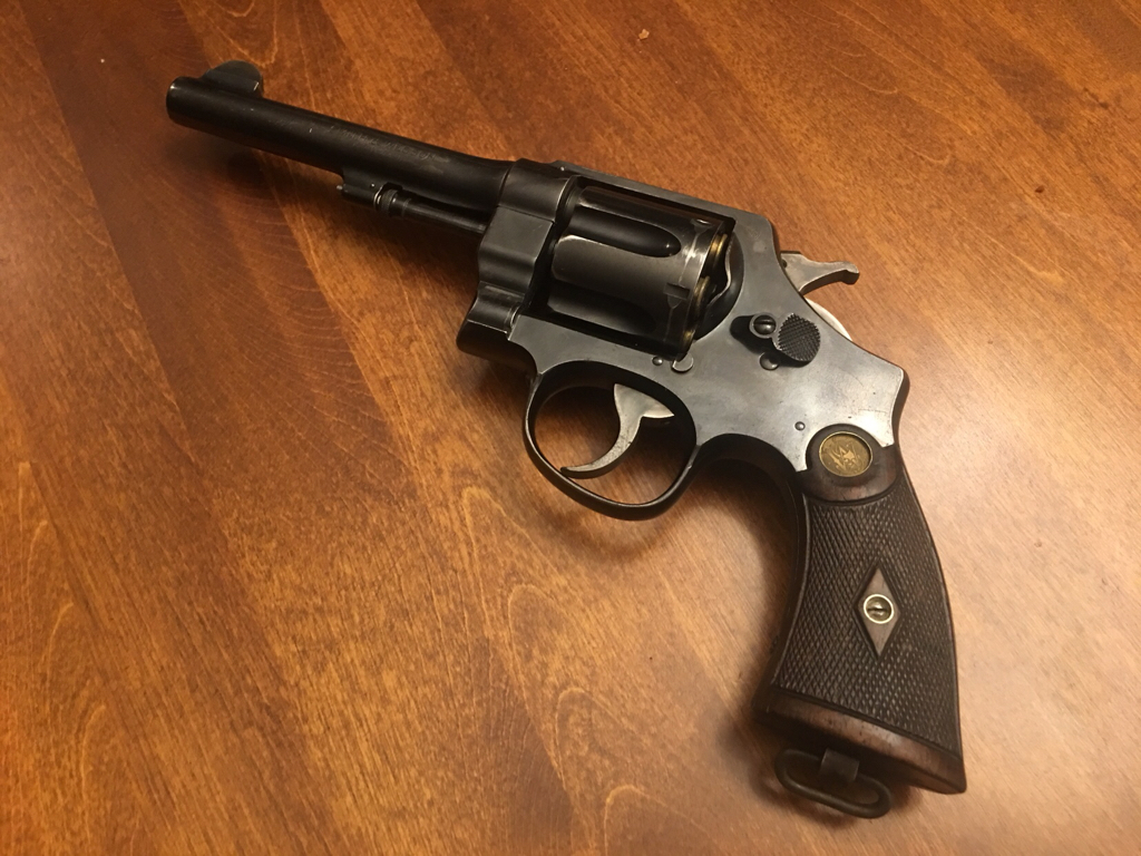

Very nice Scott! Mine is all wrong, being a 45ACP with a barrel from a 1950. Haha. But i really wanted a revolver that could shoot 45acp, and preferred not to cut the barrel of an historically relevant item. It took me a long while to find one that had already been modified in a way that ruined its collectors value, but not in a way that prevented me from Indy’ing it. So my commitment to screen accuracy of the sight blade has mostly been for you guys, as the rest of my pistol doesn’t technically cut it :p

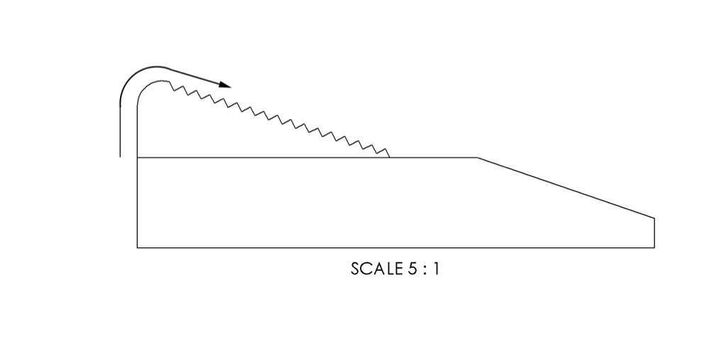

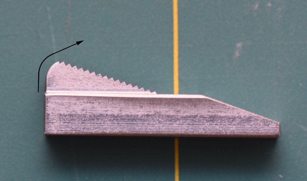

Hey all! Good news and bad news. Got the batch of sights in, and they look fantastic as far as the quality of machining goes. Unfortunately, they machined the shape of the sight blade a shy different from what my CAD data showed. The difference is very subtle, and in fact without the recent propstore photos, would be impossible to even tell the difference. However, they just weren’t quite as perfect as I’d hoped, so I’m having these recut, and expect to take another few weeks.
Here’s a quick pic of one of the “blemished” sights. Rather than scrap these, I’m considering offering them as an inexpensive add-on for anyone who purchases the correct sight. Perhaps folks would like to have a spare in order to experiment with the finish, etc.
With out a comparison pic, I seriously can’t tell the difference
I saw it... also, looks like one corner got over de-burred... So... did you see my post above your update? Thoughts?

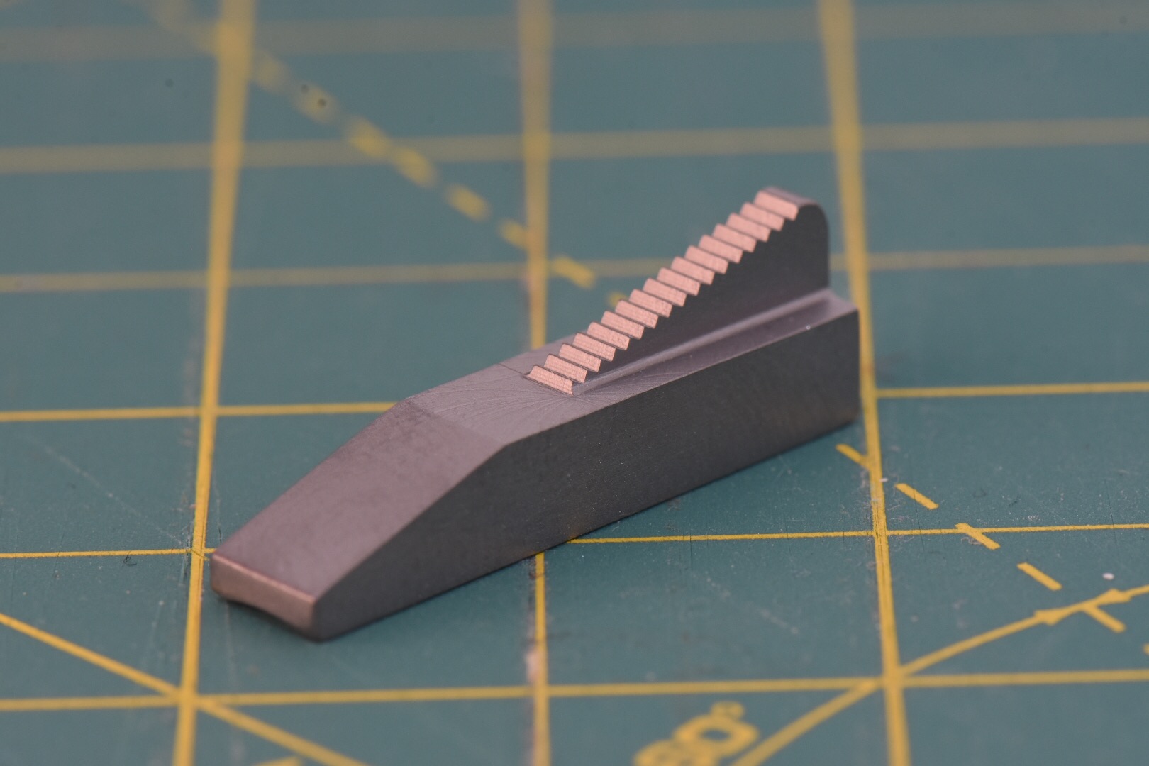

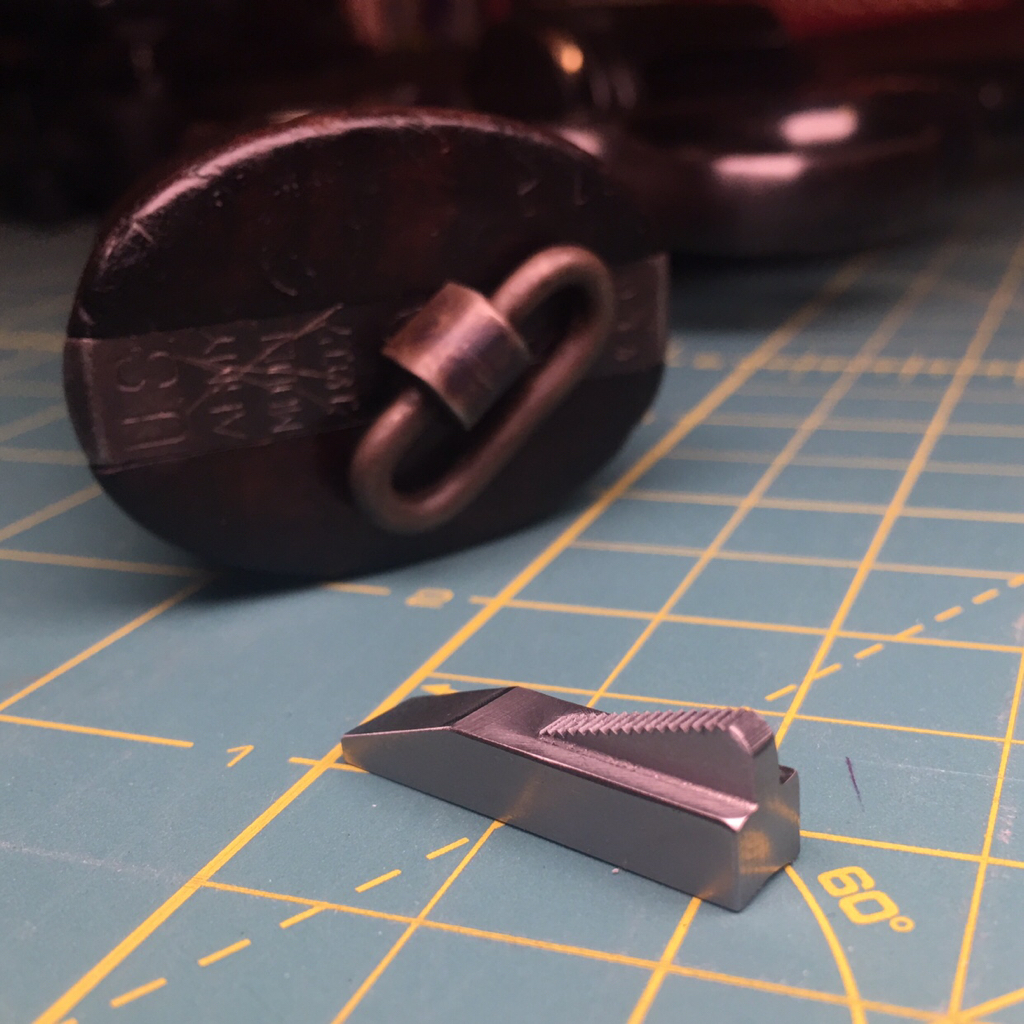

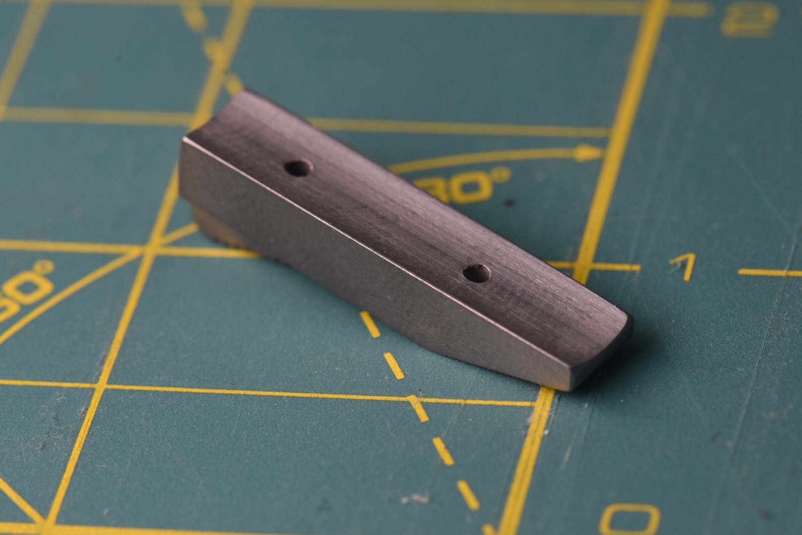

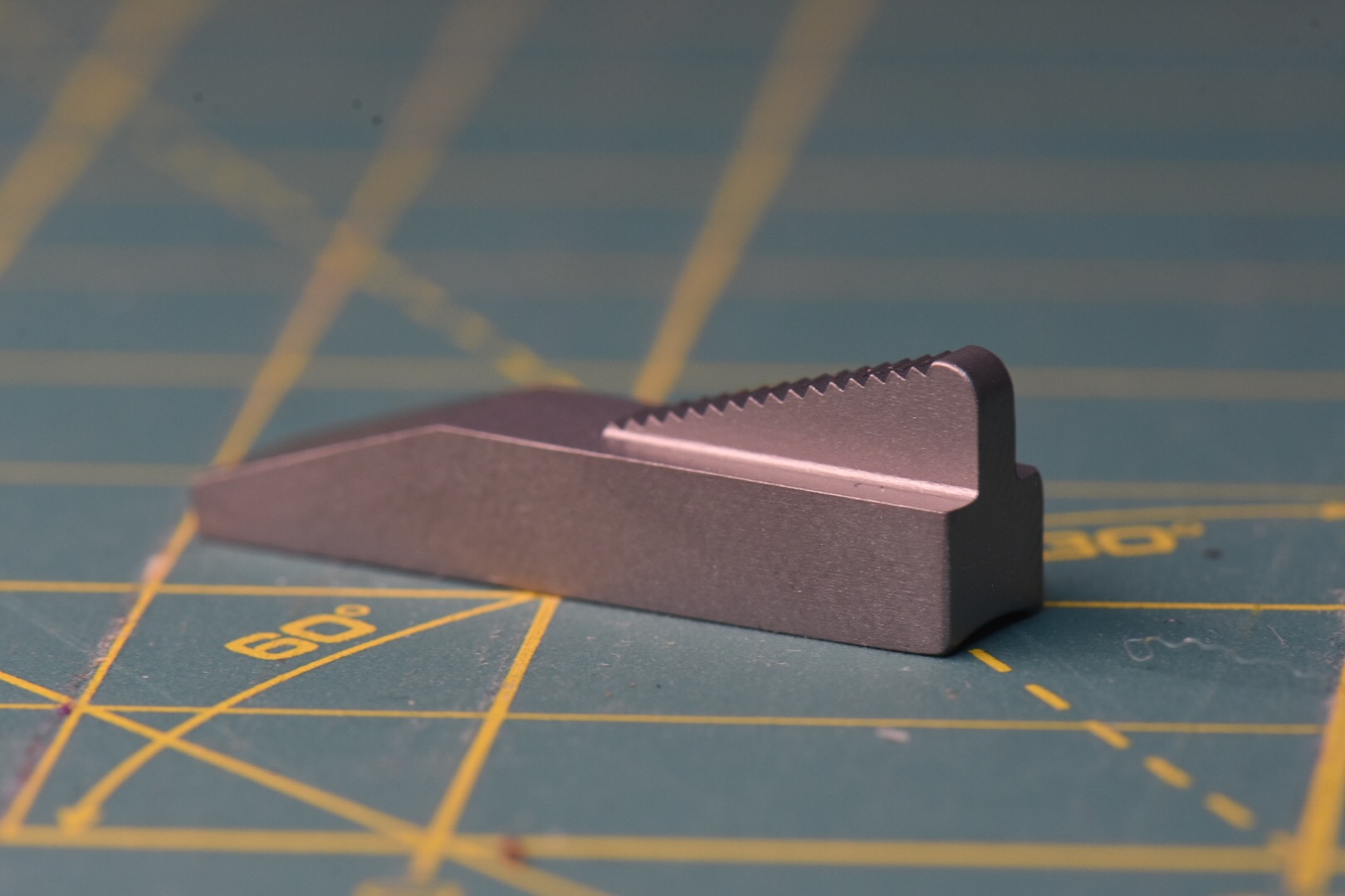

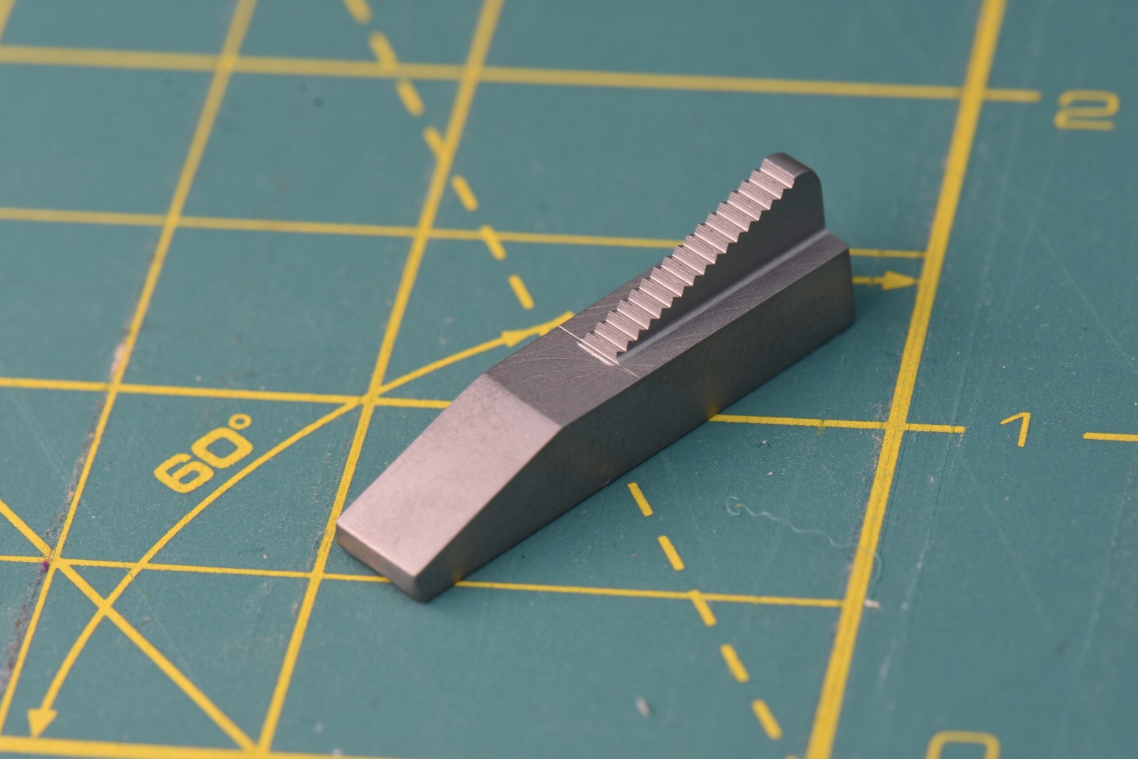

Hello all! Good news! The front sights are complete, and they look great. Dimensionally as accurate as I could make them, down to the number of serrations down the ramp. I've hand sanded the flats, and then had these lightly beadblasted for a nice semi-satin finish, and to remove what machine marks I could. I'll leave the final finish up to you guys, as some folks may wish to leave them as-is before blueing, or sand them further bringing them to a more brushed or polished look. Order/Payment info DM's will be incoming shortly :)
Since only a limited number of these were made, the priority goes to anyone on the signup list prior to this post, but feel free to post if you would like one should any remain.
And of course, pictures!
