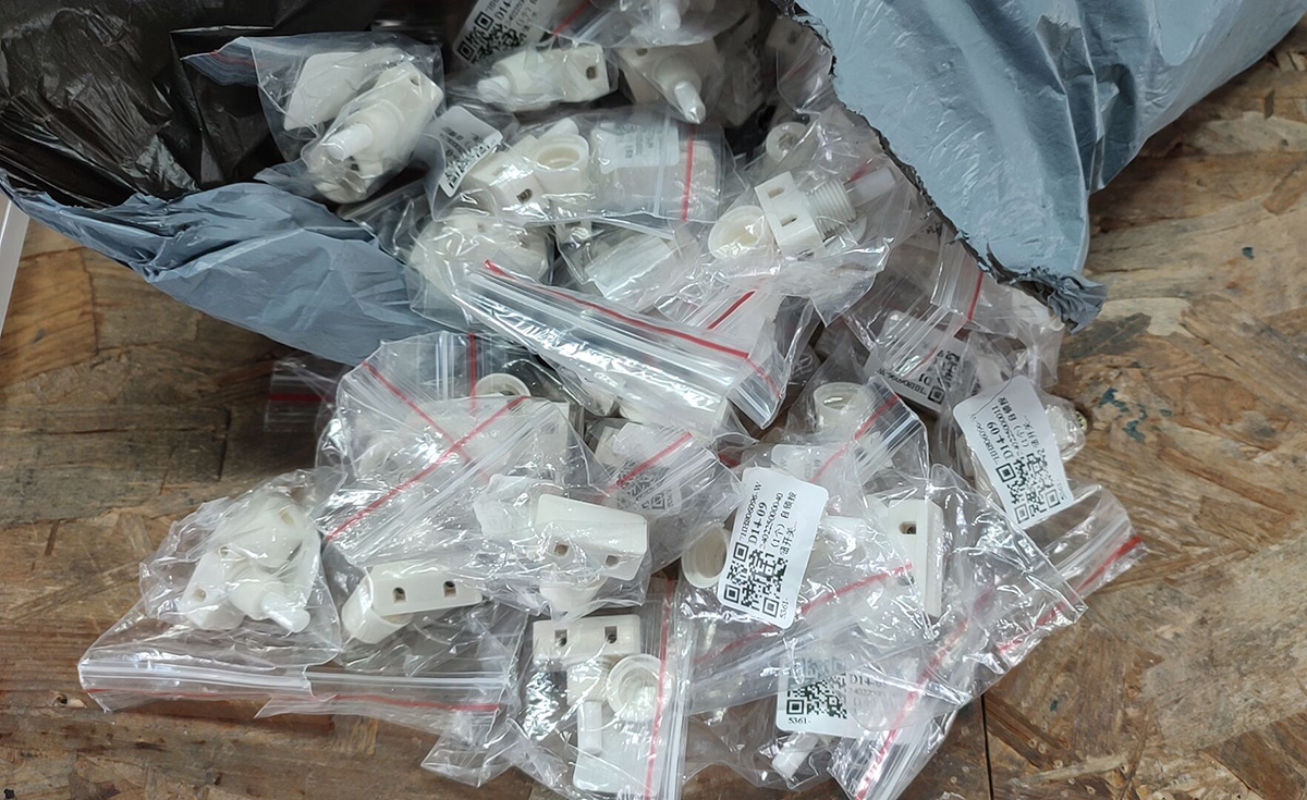

I'll now be ordering all the aluminium tubes and stainless steel 8mm rods.
The white switches and motors are already ordered :)

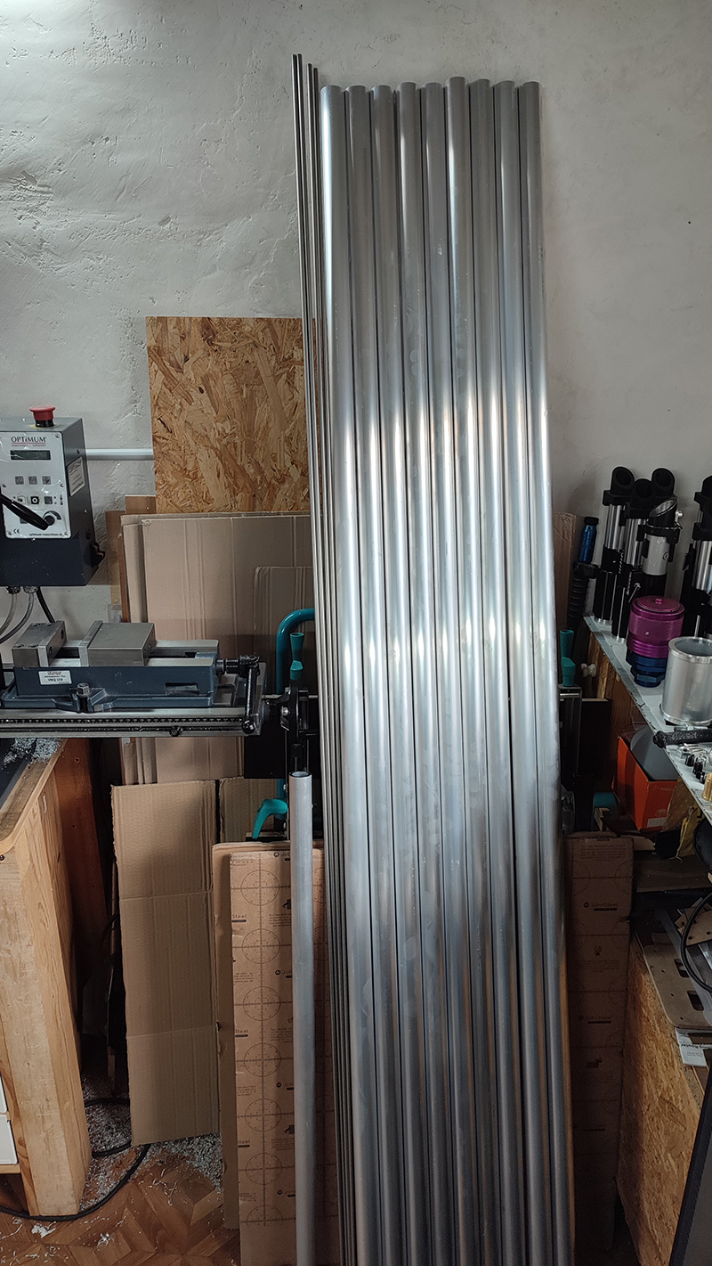

Aluminium is ordered for the run.

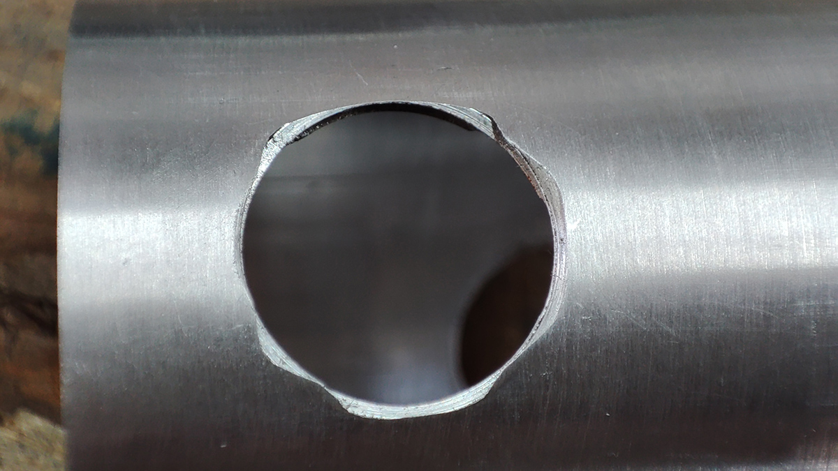

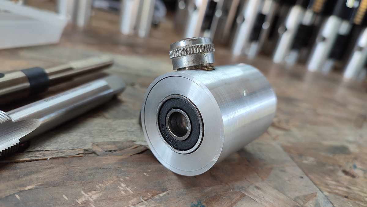

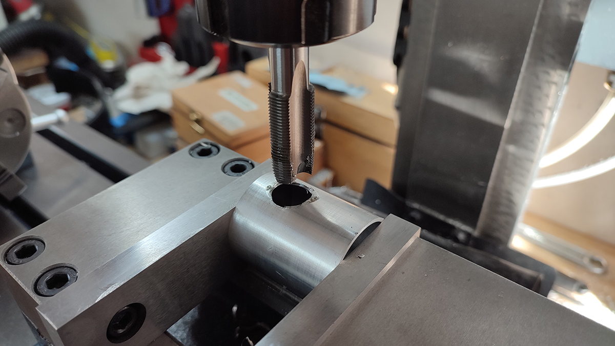

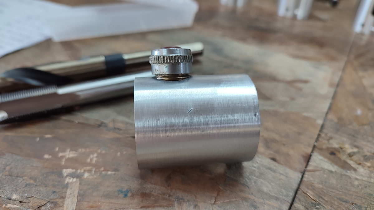

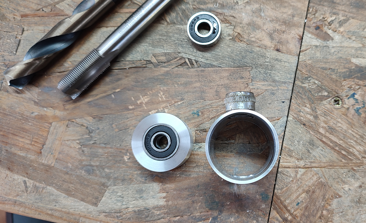

I have received the new UNEF 5/8" tap today and tried a new hole for the red button, it works very well now.
I get the exact result I wanted, which is the red button only threads a little bit and rests against the inner core. That gives the exact look of the original.
as you can see, the core is inside and the red button rests on top of it.
threading a tube gives weird results, but anyways, it seems to work very well.
I have some more investigating to do though as the glass eyes I have on hand are not threading all the way for some reason. Either as a result of the fact we are trying to thread them into a tube, or because UNEF 5/8" is still not the proper size?
weirdly enough, the red buttons I have measure 15.6mm at the threads and the glass eyes measure 15.8mm. I don't know, it's surprising, but I'll make it work.

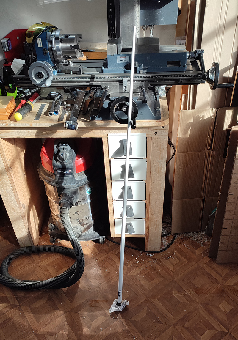

also received this boat antenna today and will play around with doing a blade for my motorized prototype :)

Hey there,
quick update on this project, aluminium and stainless steel arrived today :)
I'm still pretty busy with the Barbican run and other smaller things right now, so I'll probably not start on this before 1st of March.
