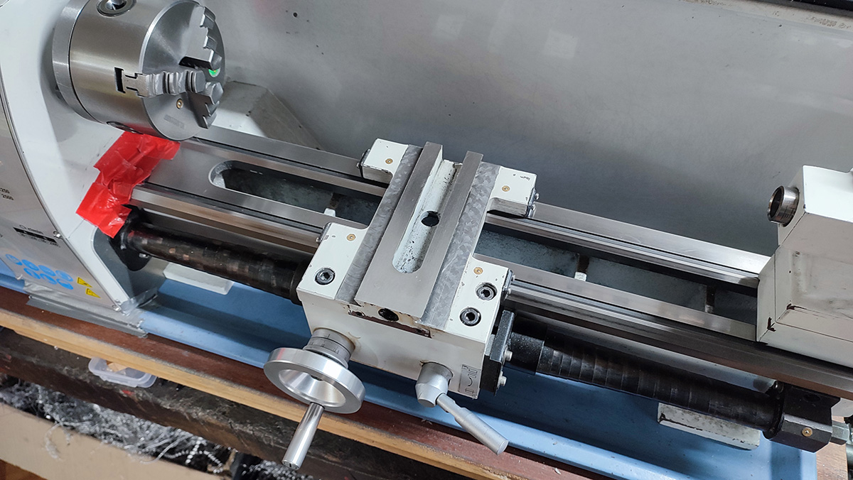

here is the lathe without any tool support anymore, good opportunity to cleanup everything as I never removed the big charriot before.

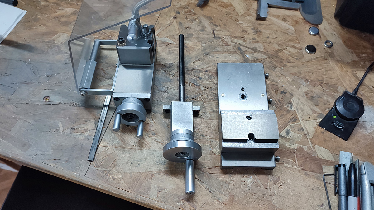

all the parts...

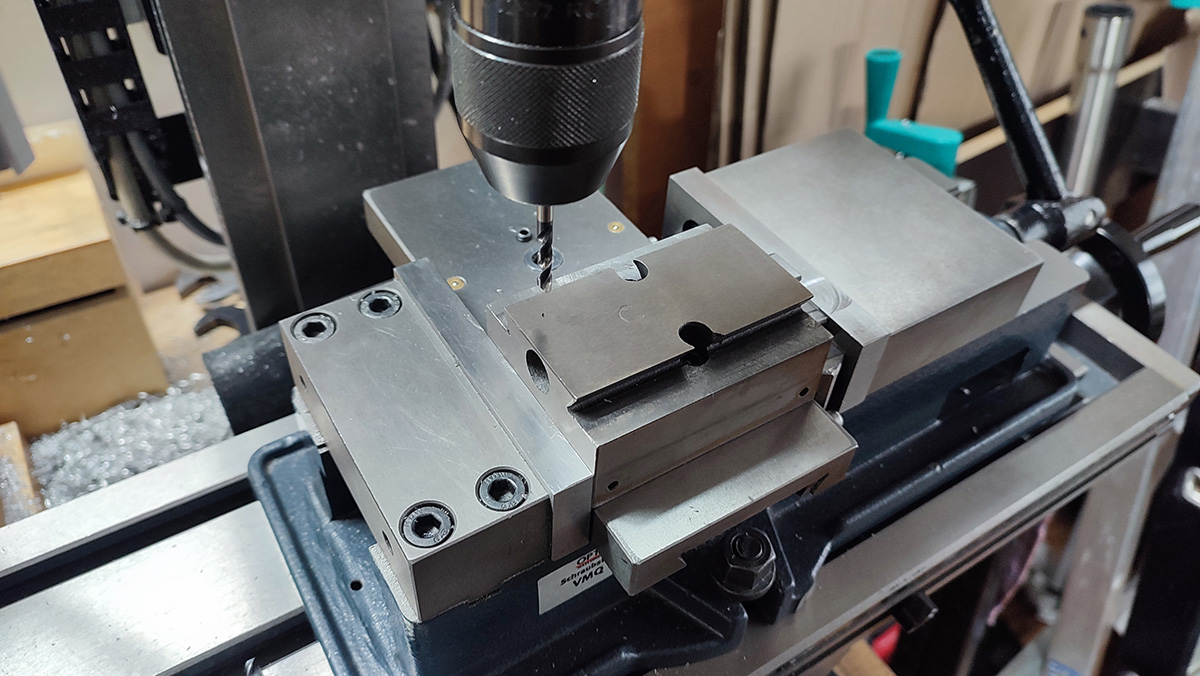

and now we want to drill a 6mm hole into 5cm deep of tool steel! yay!
luckily I have great drill bits now that will drill into really anything, so it's not that hard anymore. It was a lot harder the first time I had to adapt that tool holder to the lathe!

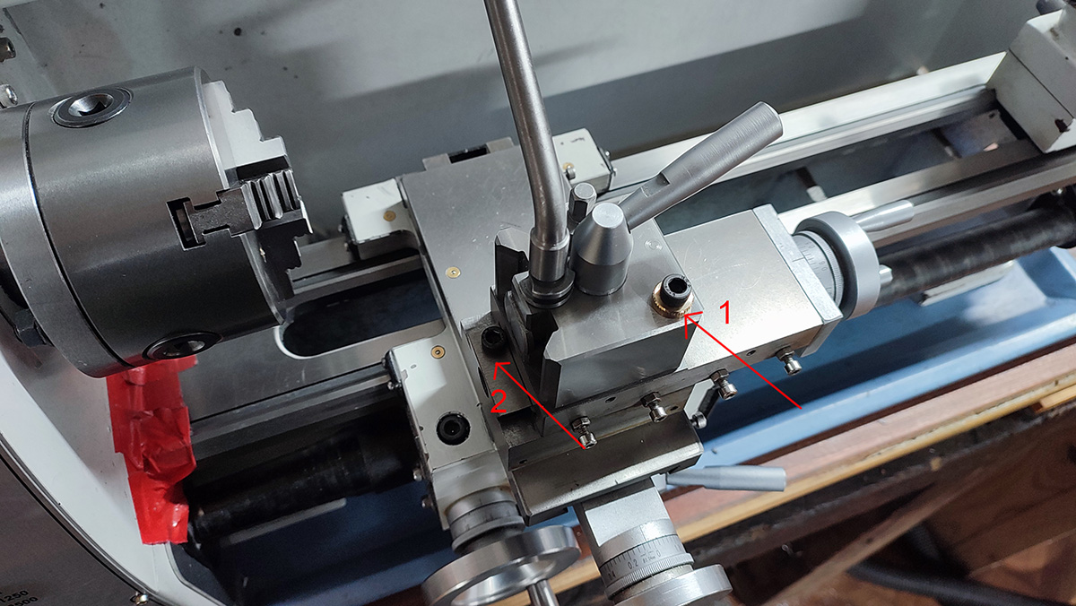

anyways, didn't take other photos of the process, but here is the lathe reassembled with the two additional 12.8 quality steel screws:
Screw #2 can obviously only be there when I do knurling and needs to be removed when using the chariot. screw #1 can be there most of the time and rigidifies the whole tool holder nicelly
#2 is doing a great job at keeping the charriot perpendicular now. However, with my last test, it seems the tool holder is still rotating a bit now even with screw #1! I have tightened everything a bit more tonight, i'll see if it works or if needs a 3rd screw!

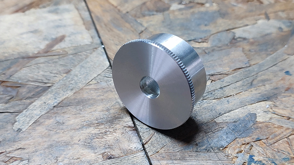

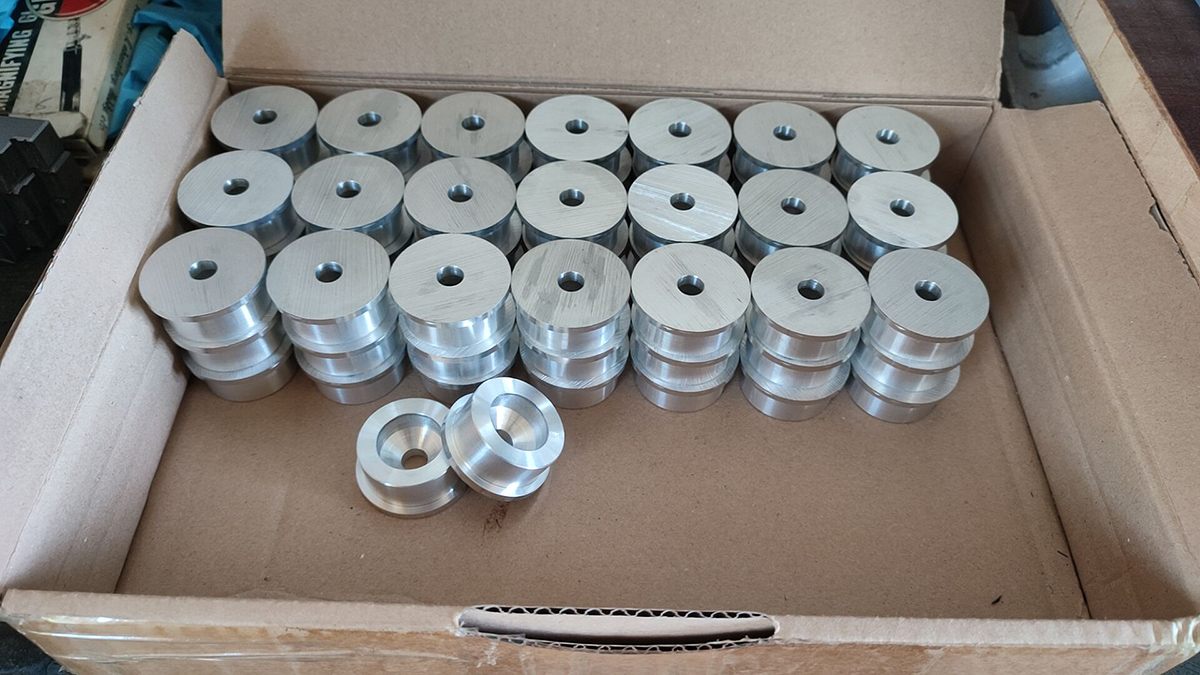

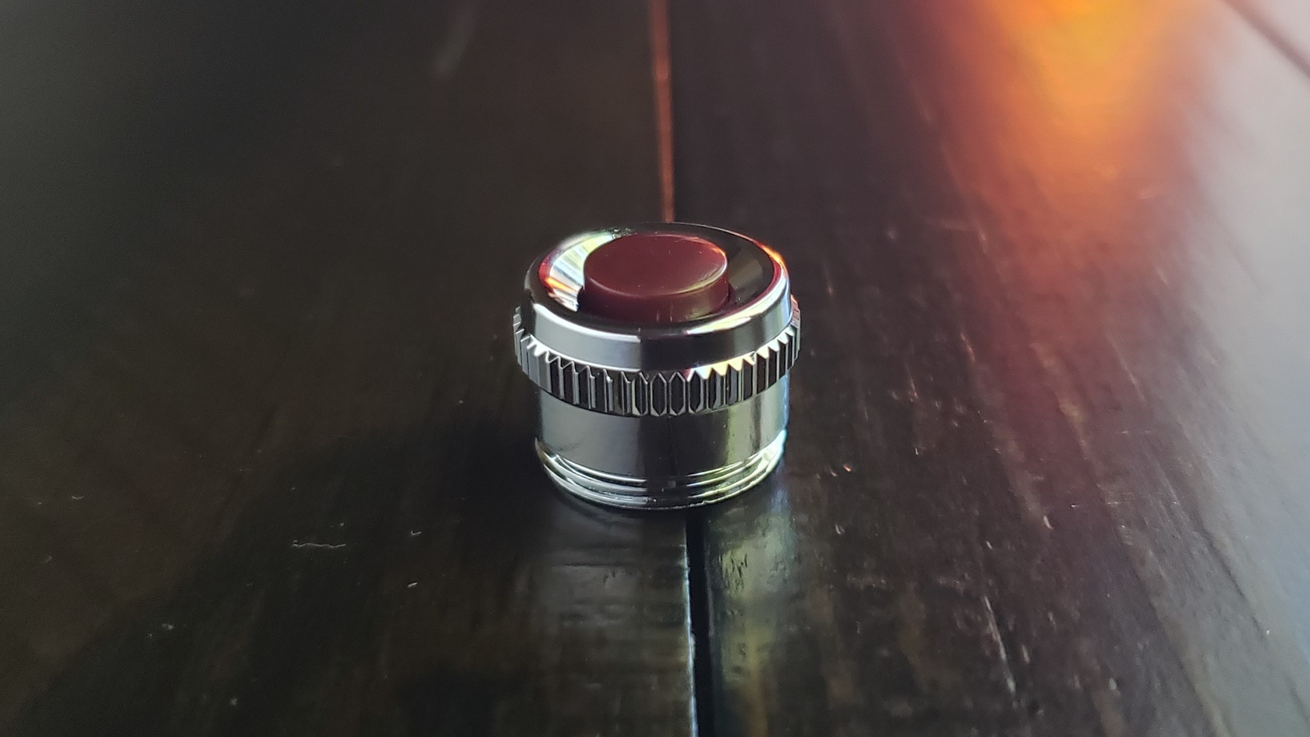

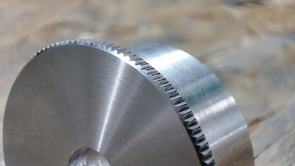

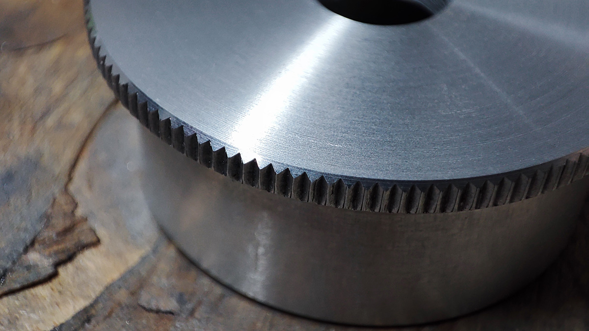

in any case, mostly successful, this is the best straight knurling that came out of that lathe so far! knurls are well formed. I have still a bit that I would like to improve, but it has mostly to do with how to hold the part. But it looks like we will get nice knurled end caps for this run
