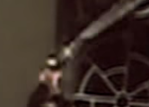

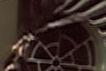

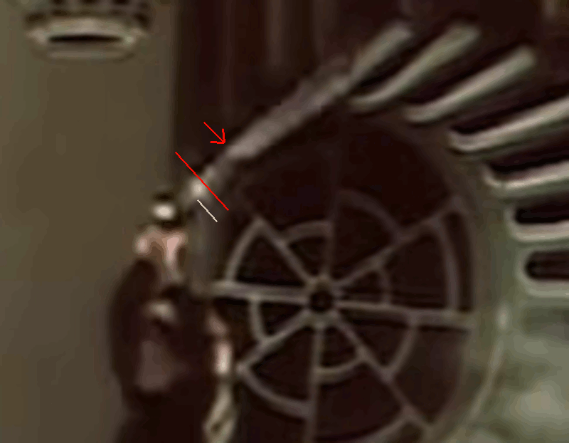

As I've posted on other threads, one of the ROTJ V type sabers does have a blade that extends well into the neck/grenade section.
(Composite of 2 frames from the 'woodchopping clip where the blade makes an exit - red arrow is a distinctive part of the blade that allows me to line them up - red line is app the emitter face; white line end of blade.)

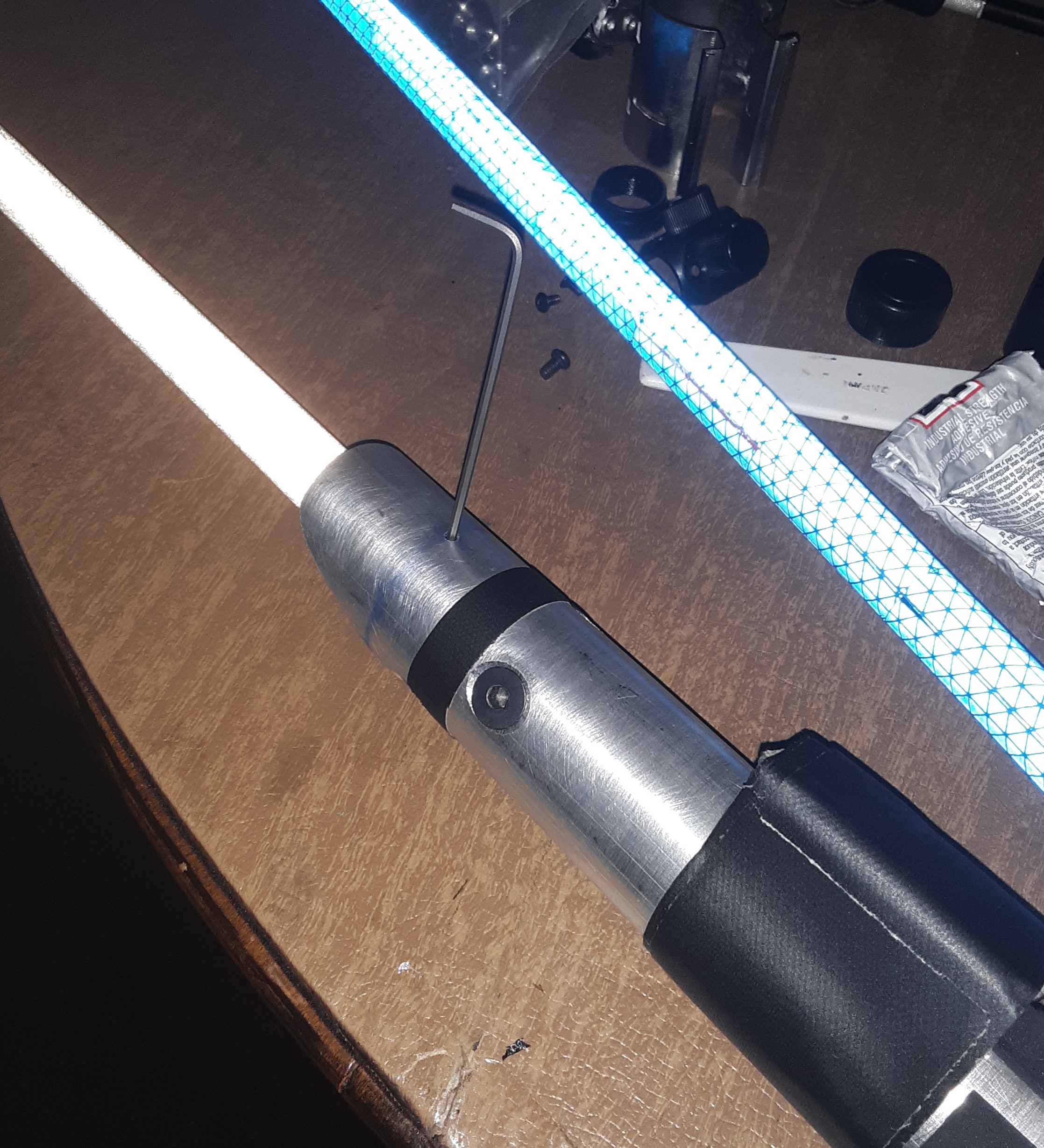

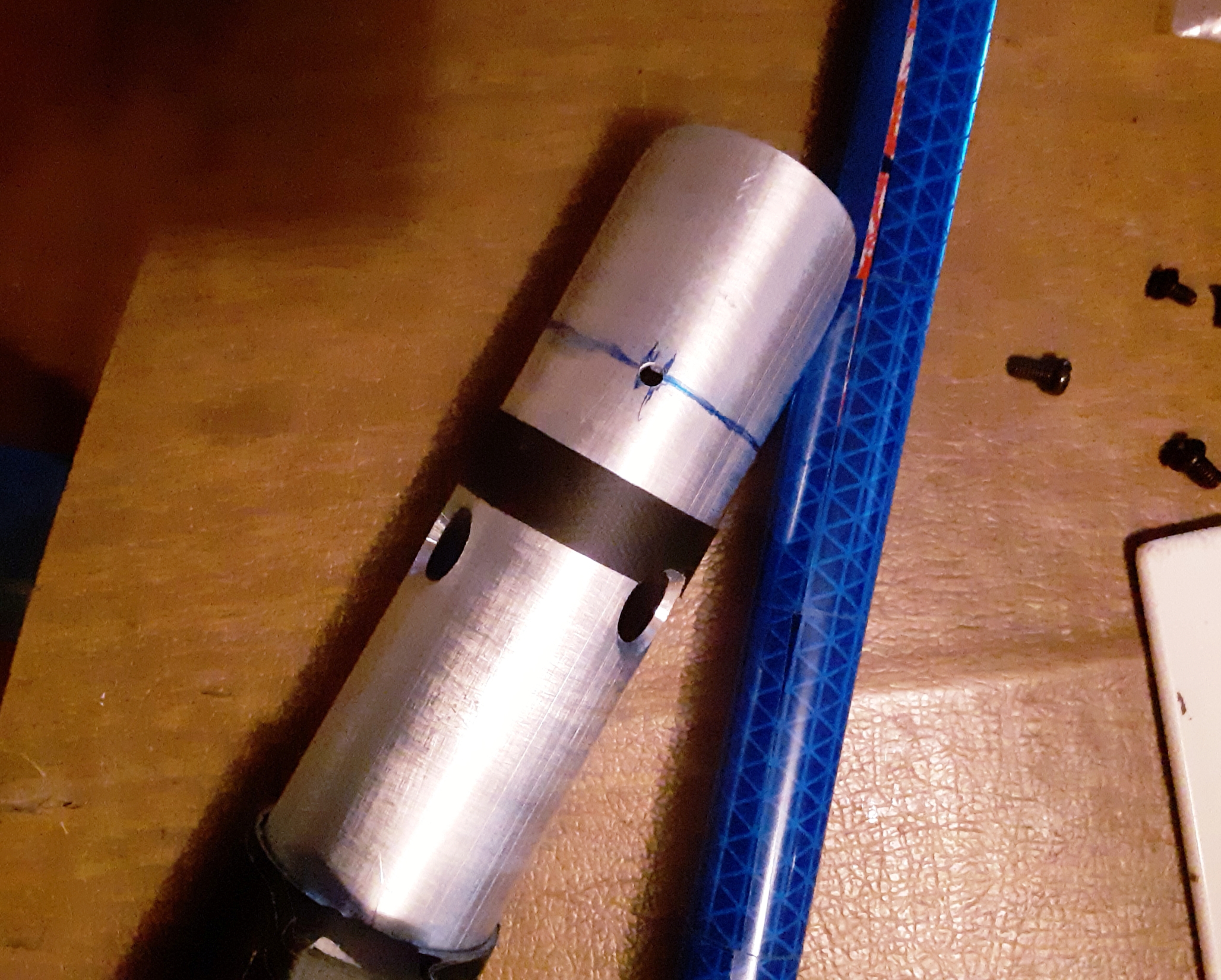

Ive made an alteration to this saber! I still may make a second, making this an artists study per se.. but in the meantime..
Brandon said there was a tapped hole ariind where the red button would be. I wrote it off originally being such a small detail (and how much muscle went into making this, i was tired) but ive changed my mind.
I dont know why it was tapped, maybe for a modified red button or something , but i do know i cant take the blade off this thing because i cant get to both set screws on the blade. After seeing kurtyboy 's version and getting inspiration i felt this was a stupid thing to be hampered by... if only i could get access to the rear set screw...
So i killed two birds with one stone. I didnt tap the hole but i realized its location would be very close to the bottom of the emitter. I drilled a hole just wider than the allen key needed to loosen the blade collar.
Now i can access both the collar set screw in front and in the back!

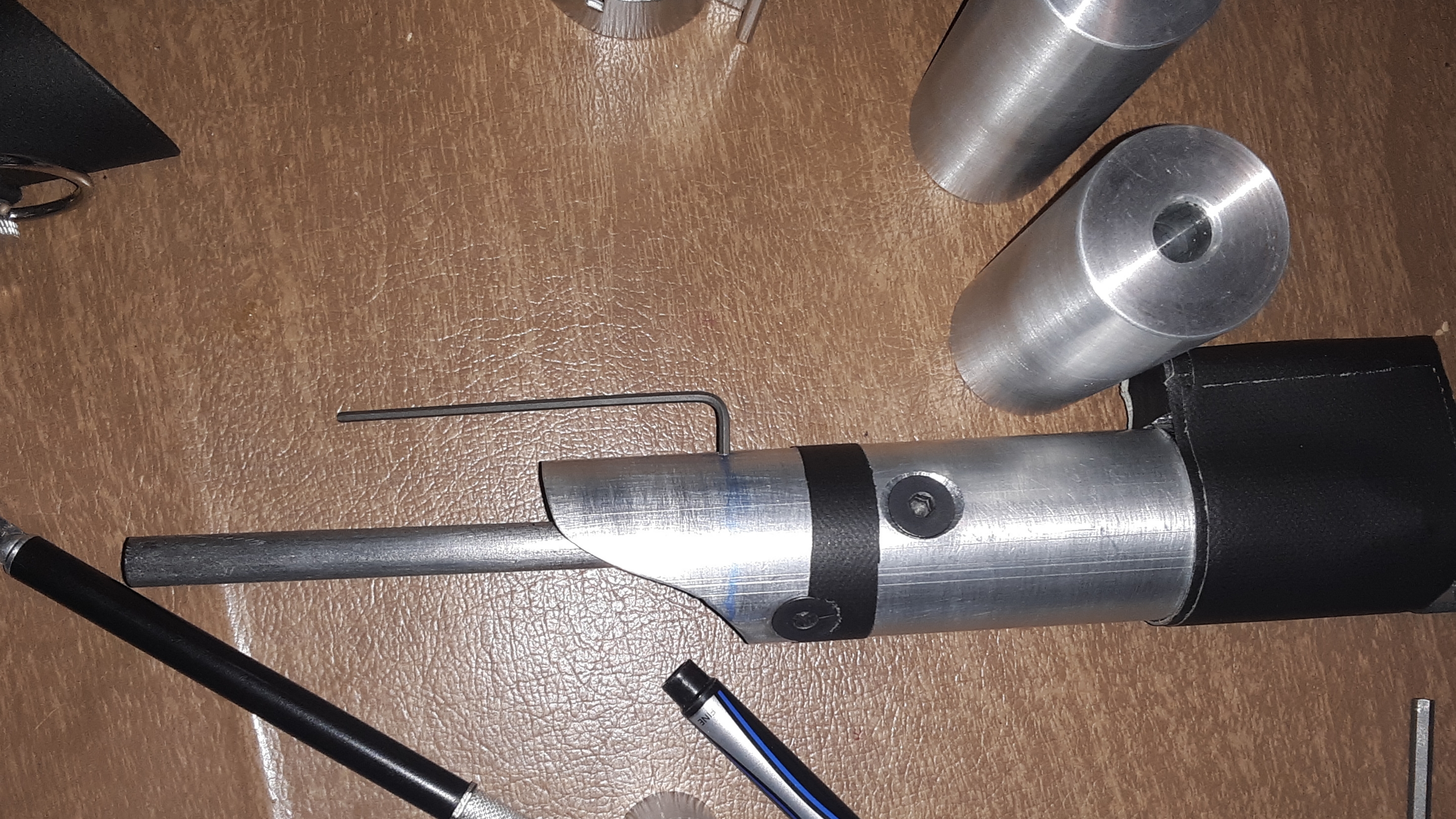

So i killed two birds with one stone. I didnt tap the hole but i realized its location would be very close to the bottom of the emitter. I drilled a hole just wider than the allen key needed to loosen the blade collar.View attachment 1256010View attachment 1256011View attachment 1256012
