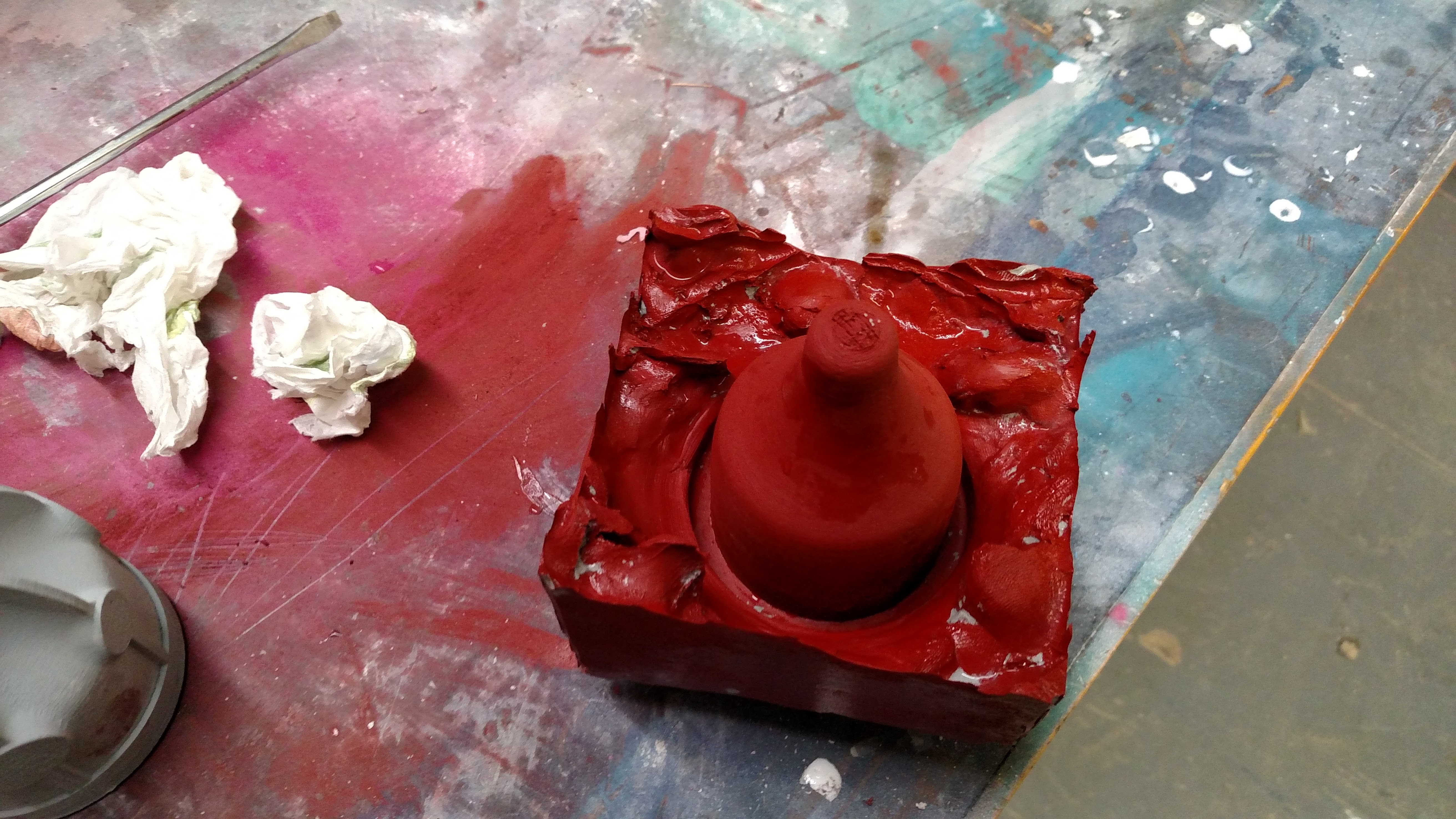

I'm back from out west and will be pouring rubber on Wednesday

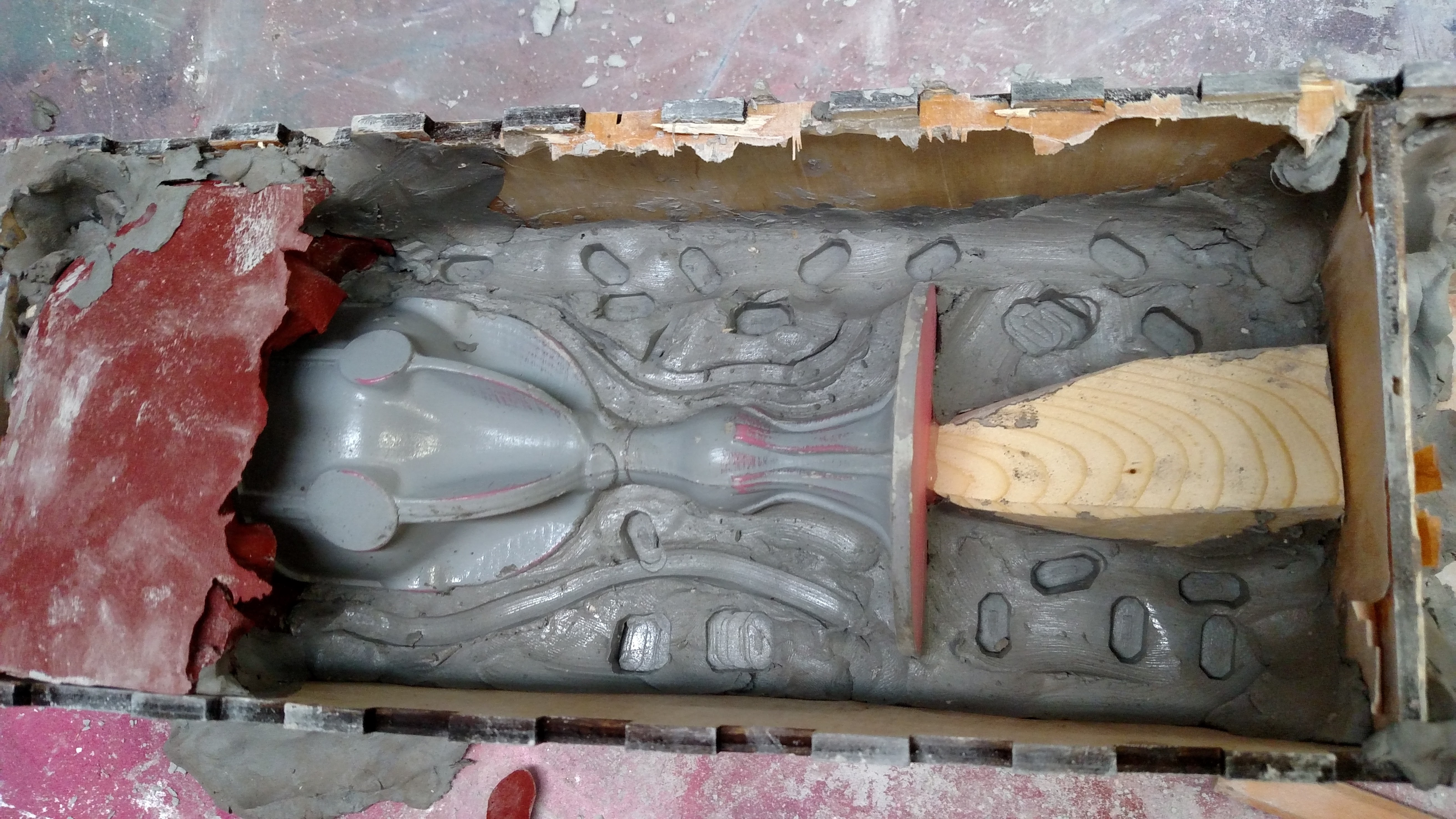

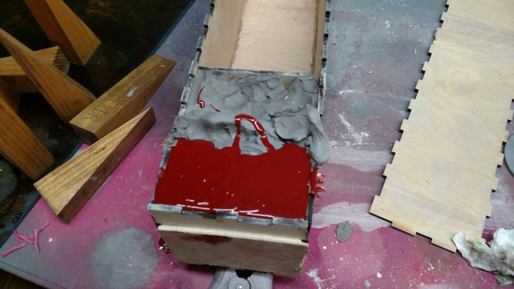

I'm doing this one in three parts to try and avoid the problems I was having on the other attempts.
Sent from my XT1254 using Tapatalk

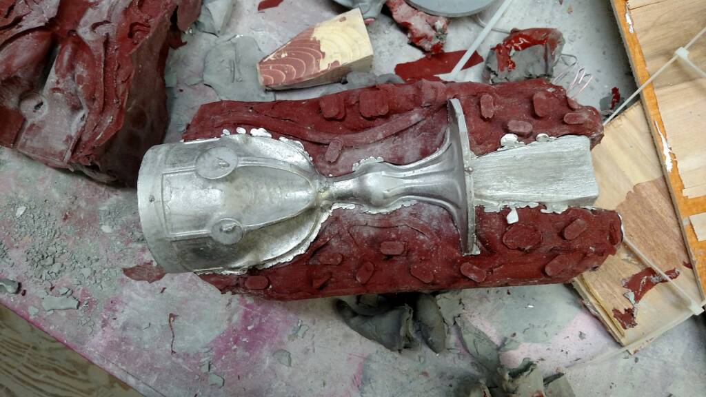

second part of three is done. I don't have a finished picture of that one yet but it did demold well, came out great.

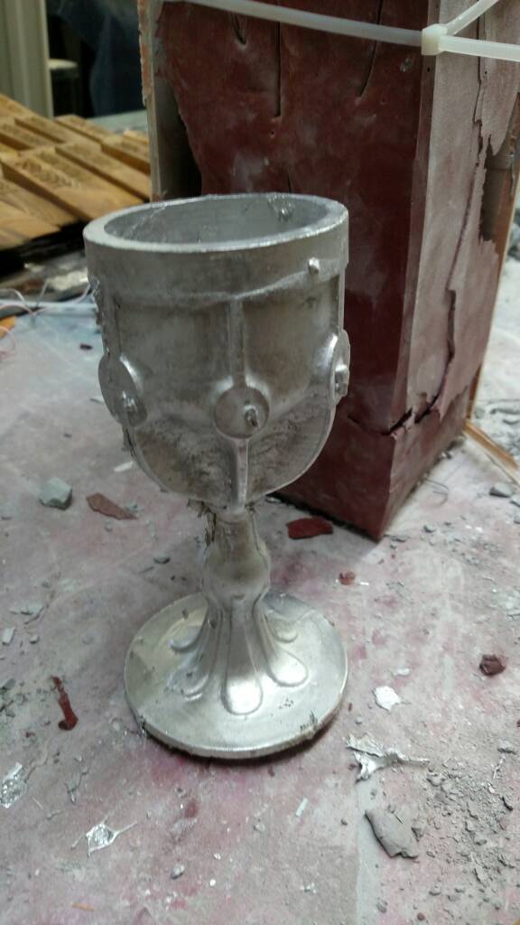

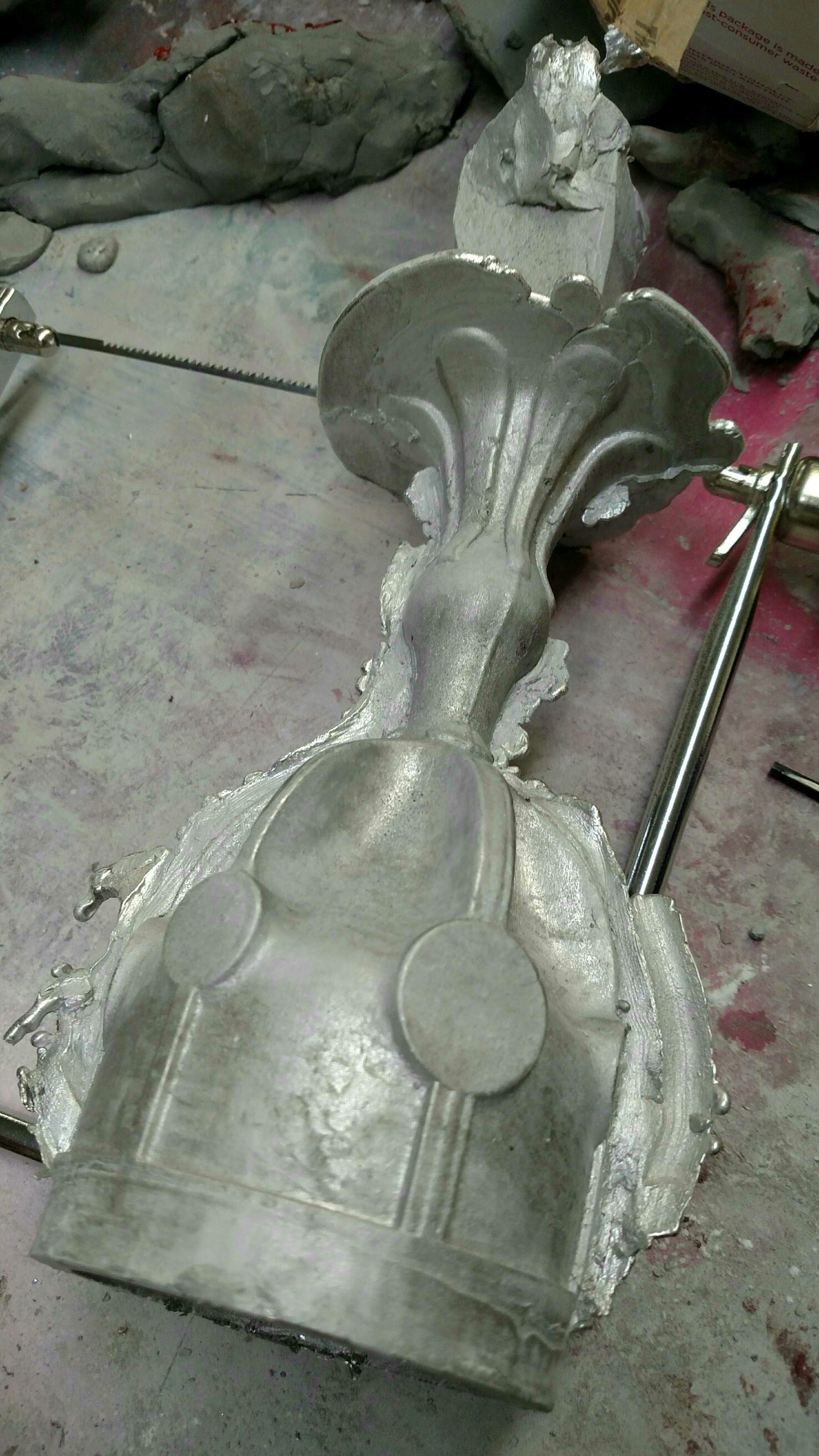

First pull from the new mold! Great surface finish in the area on the base I was concerned about before, and it's much easier to get it out without tearing the mold this time.
The only problem on this pull is the missing section where air got caught in one of the fins. I have straw tubes inside the mold to allow for venting. I poked some more holes to allow for better venting in this particular area and am casting another one shortly.

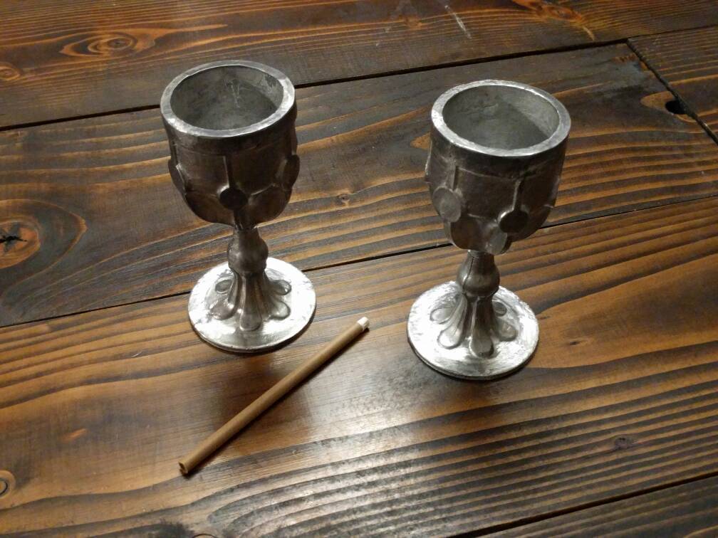

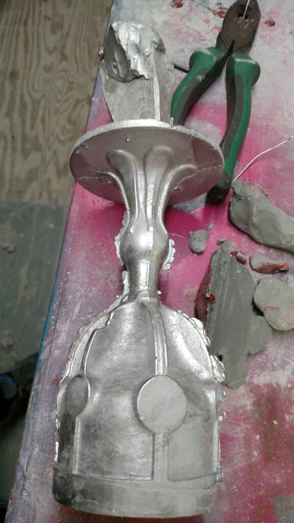

Second pull,. Fixed that issue, but I think I poured to cool, and not fast enough. Base didn't come out

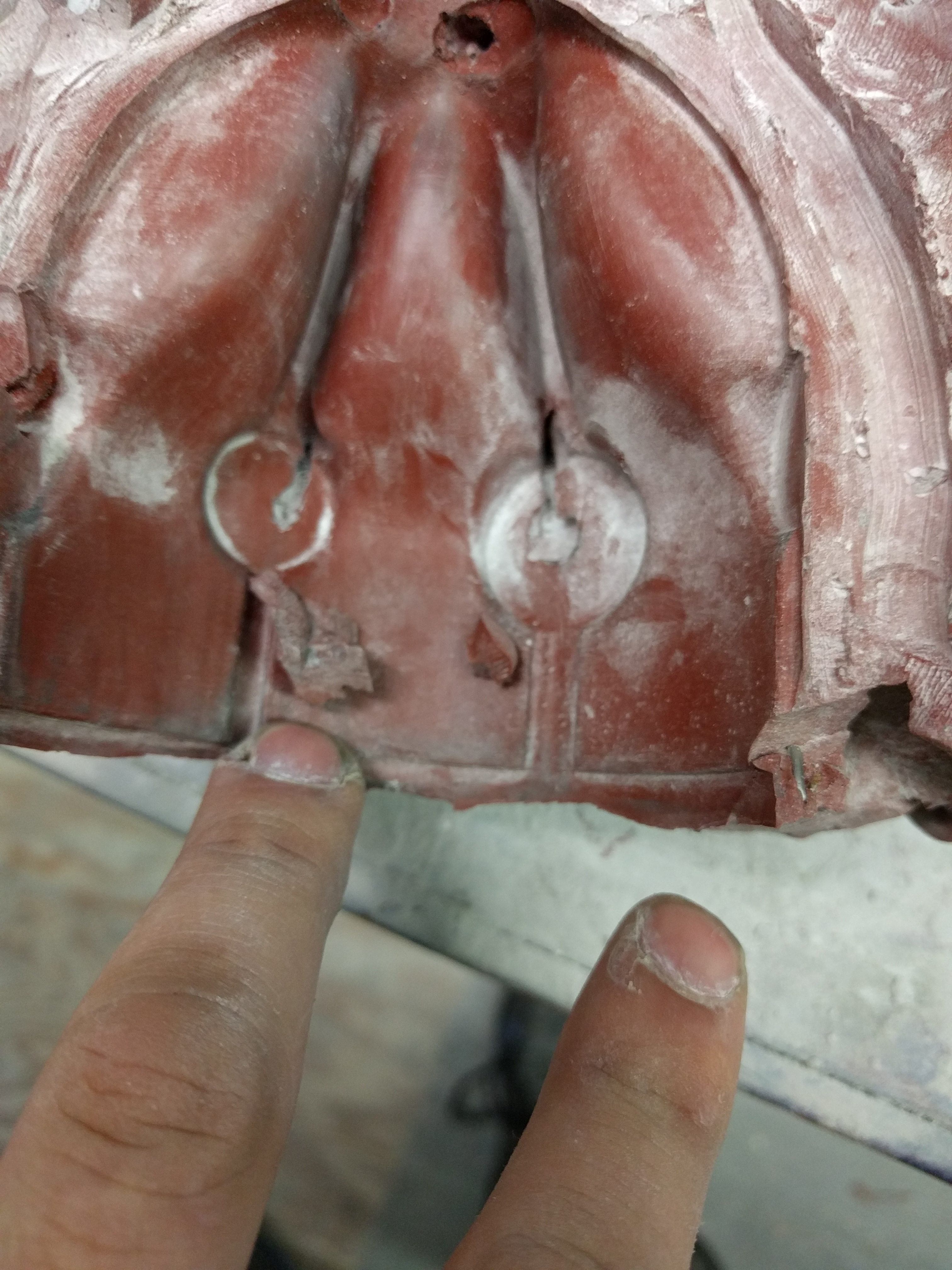

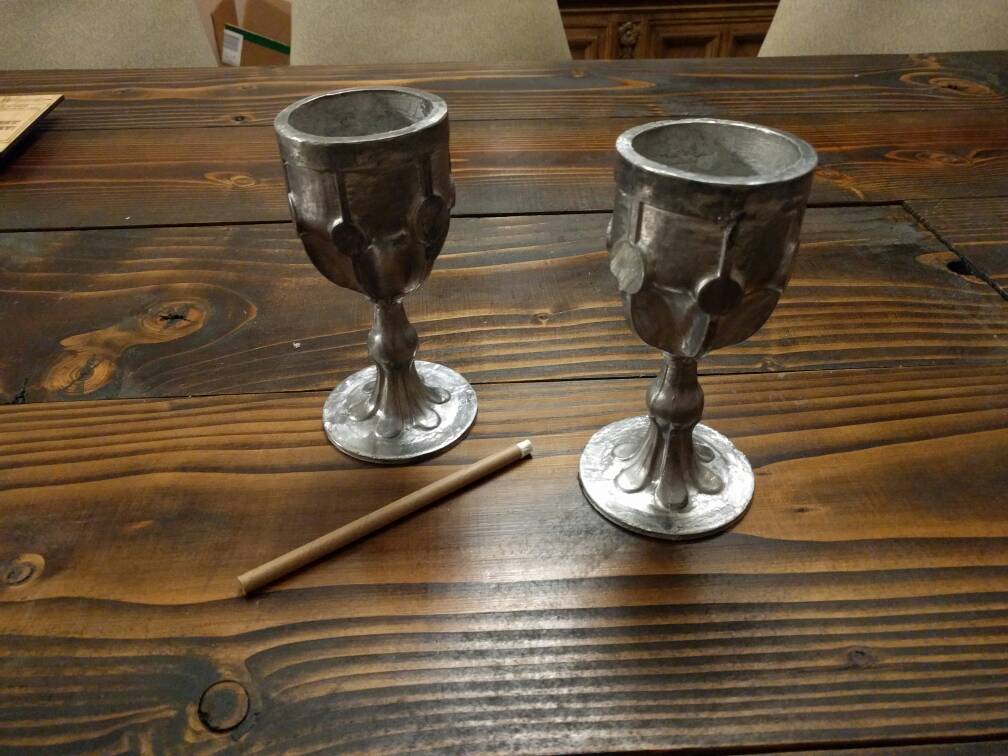

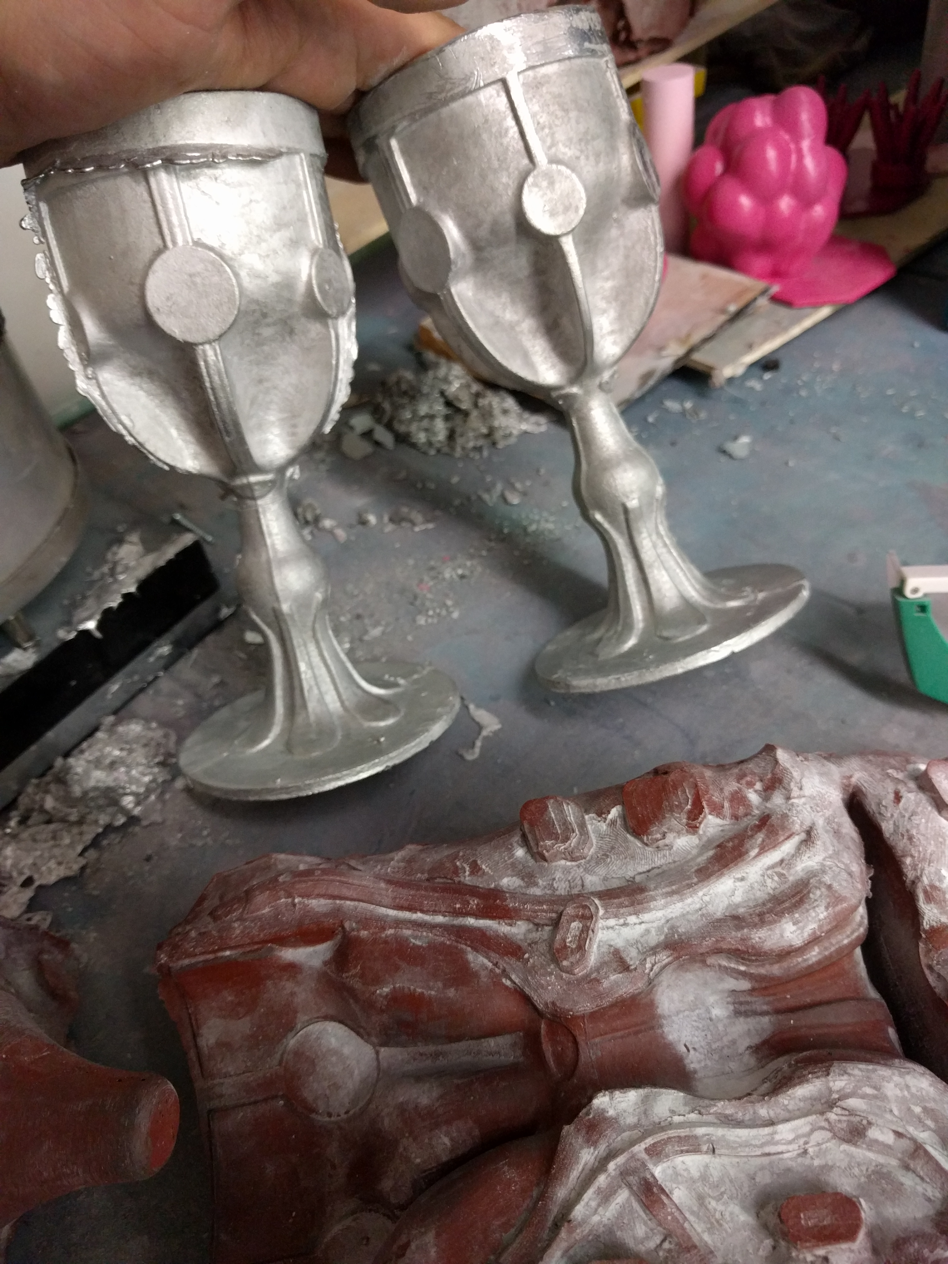

I was able to get it together and get the method down. I have two successful cast goblets in addition to that first one I made. So the first set is ready to go. unfortunately, one piece of the mold that had torn that i kept pinning in place finally gave way, so I have to redo one of the 3 pieces to the mold. I've ordered more rubber which should be here tomorrow or thursday, and i'll redo that section of the mold. the problem i was having before was 1, i was squeezing the mold together with the clamps too tightly. this was rectified using electrical tape and rubber bands. The other problem was that the mold wasn't going together all of the way, resulting in a tilted brim, which I've resolved. The last problem was all the little bits of the mold that were wearing out and having to be pinned back into place. the metal is very heavy. it was pulling apart the mold halves. The clamping was causing a lot of leaks too if i squeezed to hard, so it was hard to both squeeze it together to stop the leaks and not squeeze it too much causing leaks. The combo of electrical table and rubber bands to hold it closed, and then a lot of clay to stop leaks seems to work. and just when i got it down, that one part of the mold had enough and i just cant keep pinning it in place. I also lost a small 3x5mm piece, so it's just not worth it anymore and time to redo it.

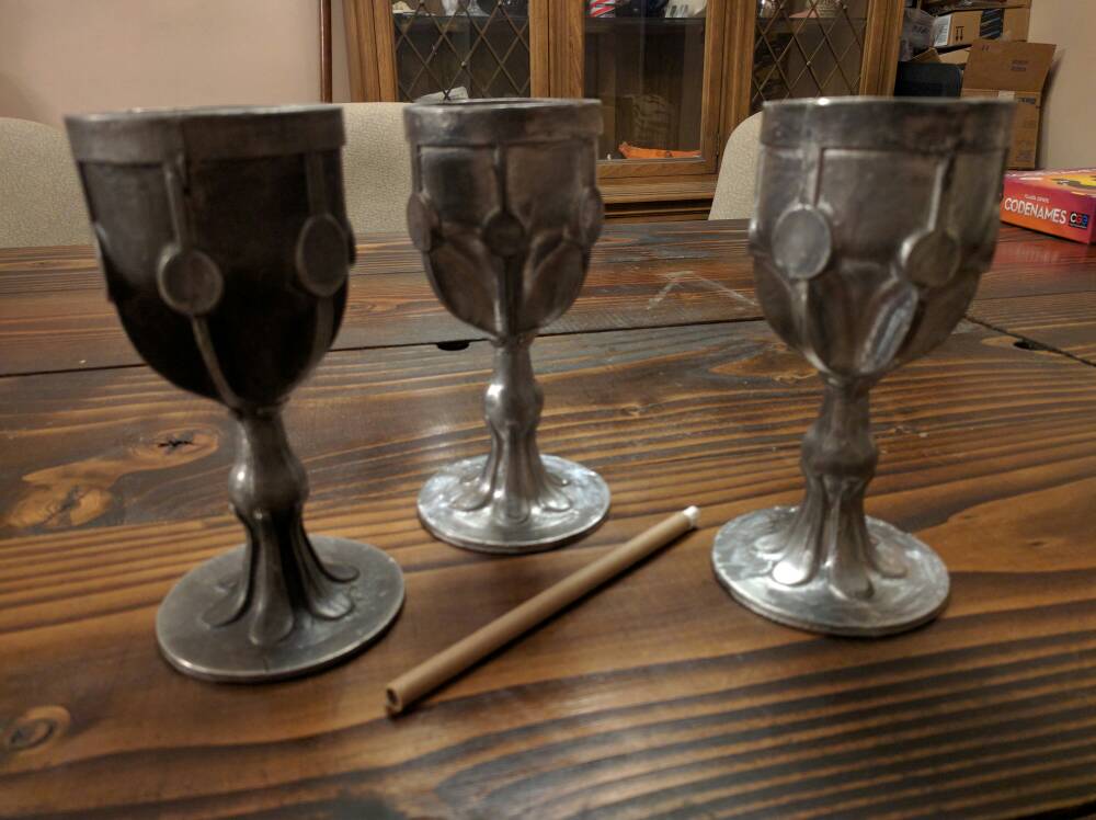

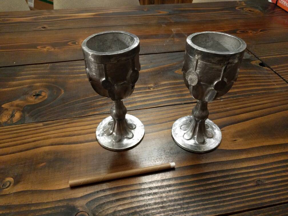

I still need to clean up the flashing and vents from the one on the left, but whoever was first on the list to pay will get this first set.
The one on the left in the triple pic has it, the other two don't. How do you want your set? You're first
I suggest with patina because the goblets aren't super smooth and shiny, so I feel it matches the style.
