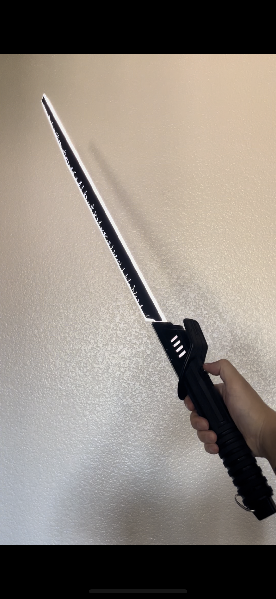

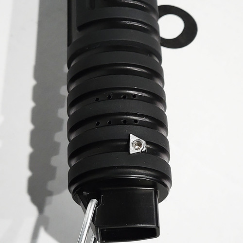

I just finished my build today, this hilt is perfect and made for a pretty easy build overall, even within the more confined "workspace" vs a traditional saber hilt. There were a few very minor things needed on the chassis as it was provided from shapeways (not shadowfoil's fault, the design is great), such as drilling the hole all the way through for the rear pommel bolt (seemed to have excess material clogging the hole), cleaning/tapping the threads in the plunger attachment, and some minor filing/sanding in a few areas for fitment.
I added eight 1/16" vent holes in the side of the hilt over the speaker for more volume and it made quite a difference, probably not a mod for everyone but with careful drilling & touch-up paint application the holes are barely noticeable. I'm itching to build another one, anyone have one they want built out? lol

Looking fantastic! I love the DIY additions. Devins( TheSaberTrade) blade is so awesome!
